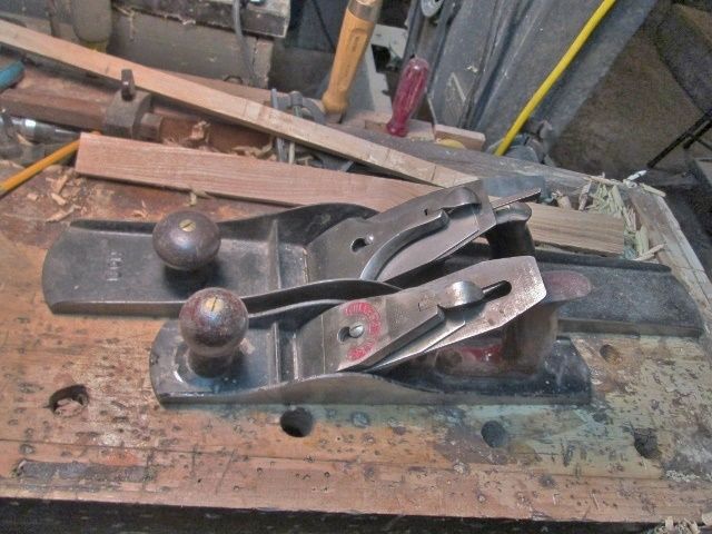

Actually, the last picture is of the Millers Falls No. 11, type 2 Junior jack, instead of the #14 Jack...:ChinScratch:

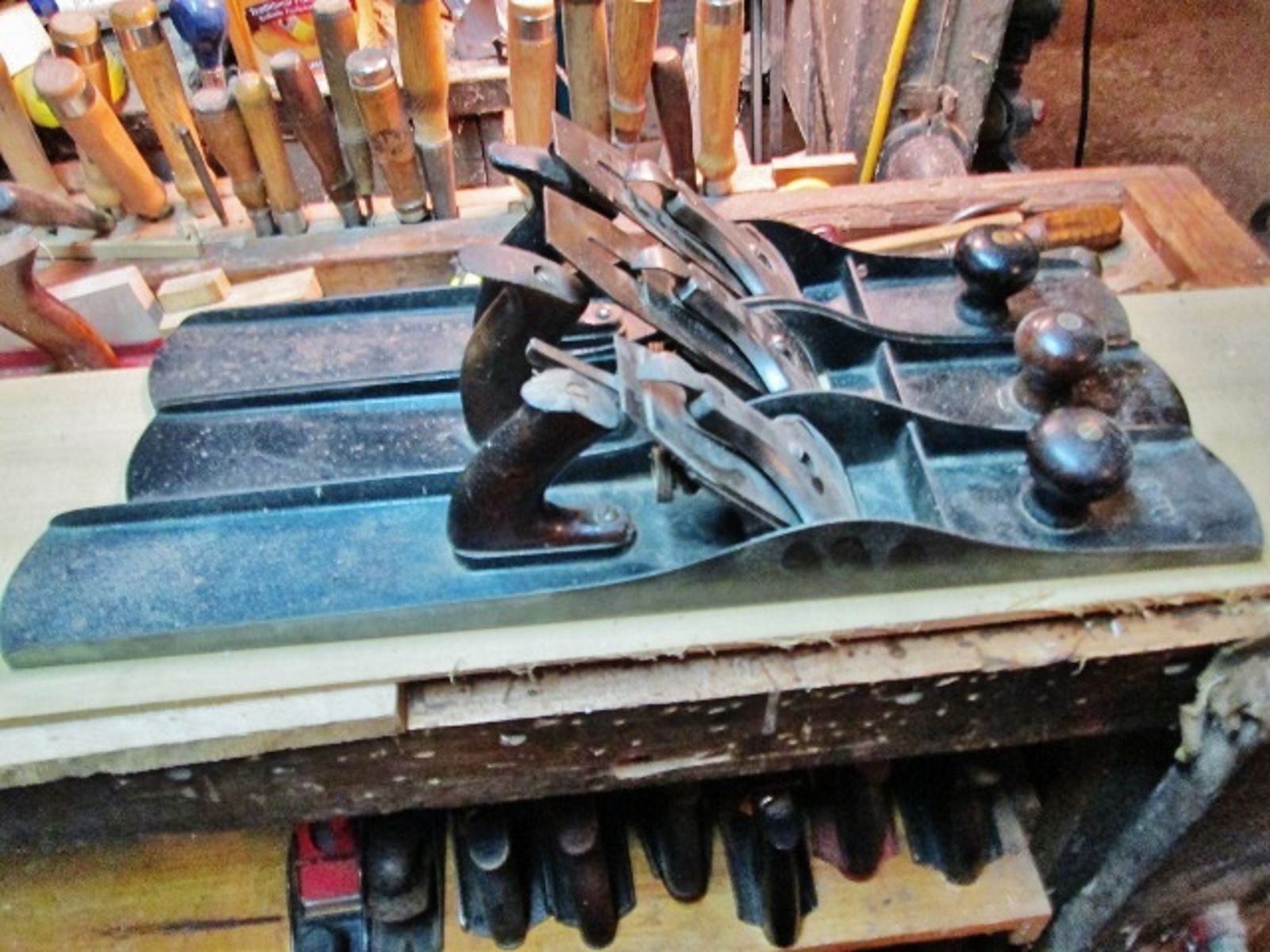

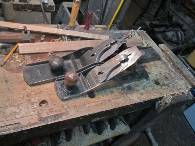

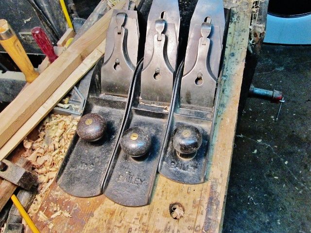

I MIGHT have one or two Morris can try out...1589483183_IMG_2585(640x480).jpg.e64c27801f10b6962ba04ffbb6ff4f22.jpg
But wait...
#8, #7, #6
And the #5-1/2 Jumbo....
Little plane is a #14 Jack plane, same size as a Stanley #5
All depends on the size of work I'm doing, and how tired me arms are...

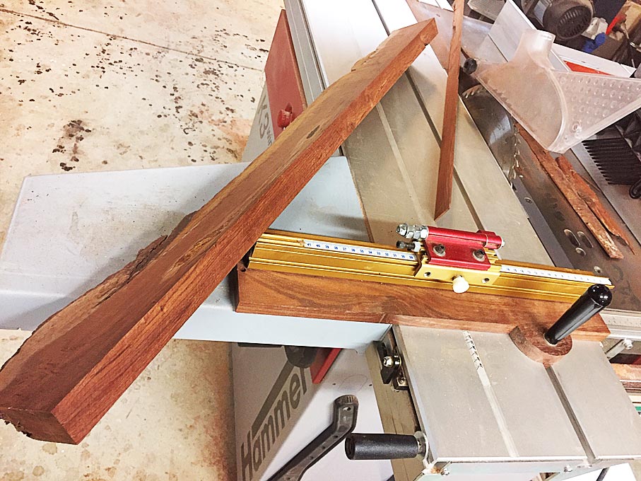

This is a Fritz and Franz jig - essentially, it is a fixed fence (at the far end) and a push block (near end), and the work piece id place between them. This is for ripping, not crosscutting.
These pieces are short, but one can rip long sections. This is especially handy when you need to clean up one side of a rough sawn board - just send it through. There is no need to joint one side first.

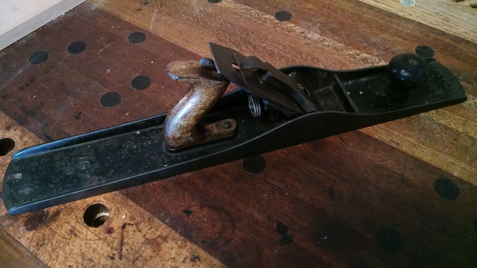

No. 7 was handy thought I'd pull it out and do a drive by shot of it.
She runs beautifully.:)
Bailey No. 7, I still use it.

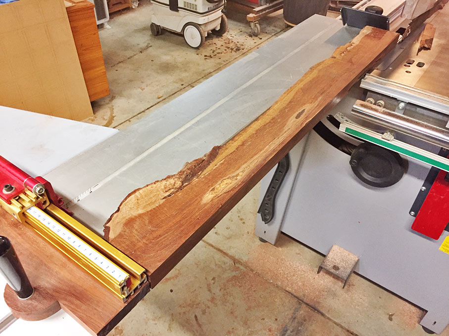

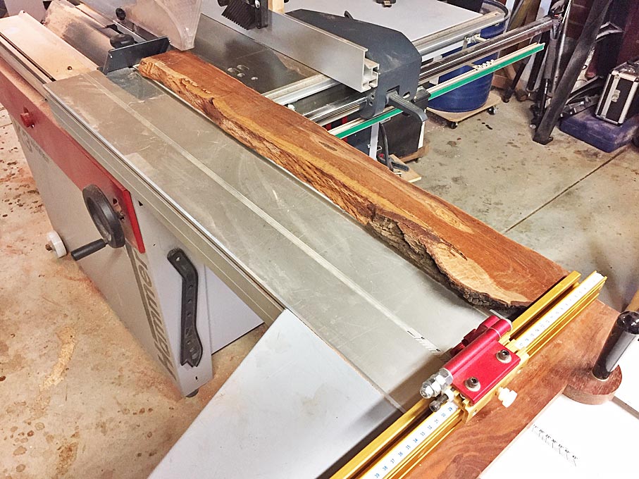

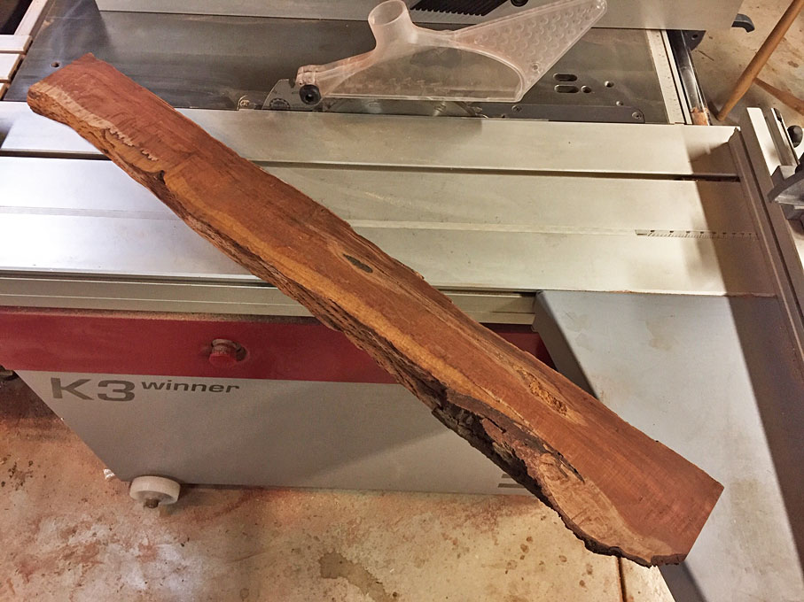

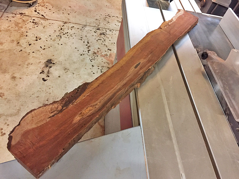

I used the K3 slider this afternoon to rip a very rough, live edge board, and took a few photos to show you what it can do.
The task was simple enough - joint one side  of this ....
With a traditional cabinet saw, one would attach the board to a something with a straight edge (such as MDF), and use that to guide the one side against the rip fence and the other side though the saw blade. Typically, the sawn edge would still be a little rough, and so it would be taken to a jointer.
With the slider, you simply jamb the end into a "shoe", with the overhand to be removed towards the blade side. The other end is held and pushed forward simultaneously with half the Fritz and Franz jig (the crosscut fence is removed to facilitate this) ...
I took one cut at a point where I thought it would leave a clear side, but there was a smidgeon that was still "live" ...
So I ran it through again, about a 1/4" in. This time it was perfect ...
This edge is now glue-ready. The jointer is unnecessary.
Regards from Perth
Derek

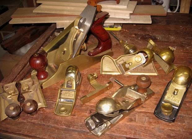

Back on track ... this was taken several years ago. It looks quite gaudy now ... like plunder from a treasure chest :)

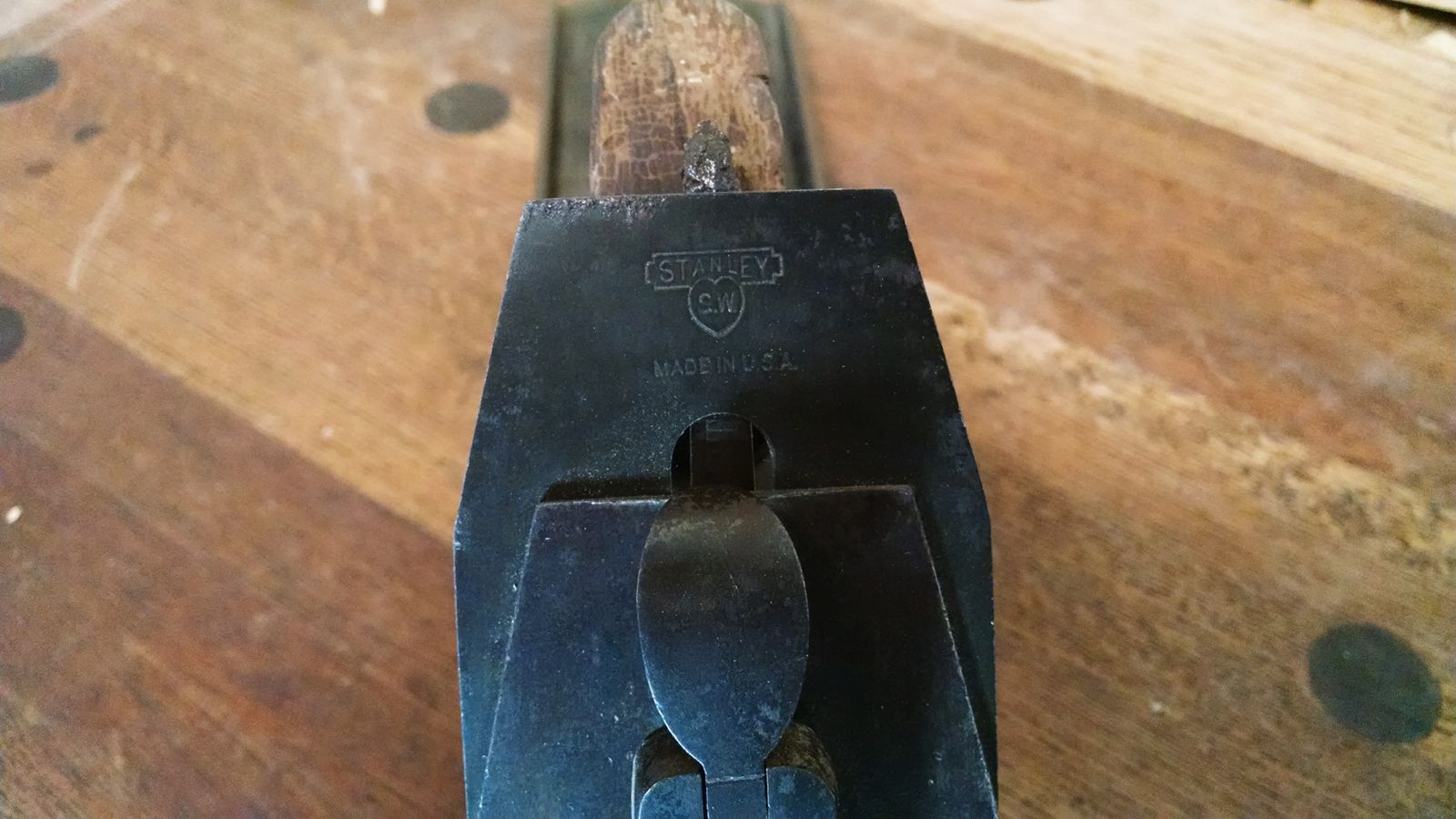

In the one photo of the jointers?   The No. 8 is a smooth soled type 7.   One of the #7s is a type 9 Stanley No. 7c , the other is an Ohio Tool Co. No. 0-7, smooth sole.   The No. 6c is also Type 10 9 2 patent dates)....the No. 5-1/2 is a smooth soled Type 17.....and the No. 14 jack plane was made just after WW2....type 2.
