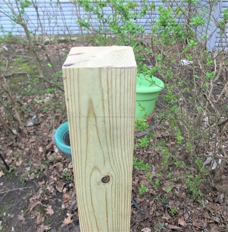

I managed to dodge the rain drops enough, to mark a "level line" around each post.   I used one of the spindles for the railing, to mark how high above the deck the top rail needs to be, at least the bottom of that rail...have one post that is a bit...off, due the the plank below being a bit  higher than the rest.  rain drops..walk back in, they stop.:DevilLaughing:...walked back out with a square in hand to square a cut line all around each post...yep, start to sprinkle, again..:DevilLaughing:..lines were done...then brought out the level, to see how things lined up...rain started again.:DevilLaughing:...we done.:ArguingSmileys:
Not sure I want to run that saw while the rain keeps showing up.:ChinScratch:...maybe tomorrow, eh?:rolleyes:
Stay tuned...

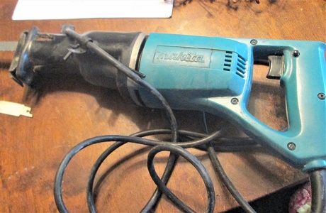

Well, wasn't a total washout for today...rain moved off to the north of here for a while.:rolleyes:...tried out the sawzall...:TwoThumbsUp:
Lopped these 4 down to the lines, 2 x 6 plank to check for fit...had to add the top 2 x 4...sawzall was shaking the post way too much.  First, clamped it in place, then screwed it in place.  2 x 6 is quite wide enough...will use the 2 x 8s on hand.. front 3 also were done...

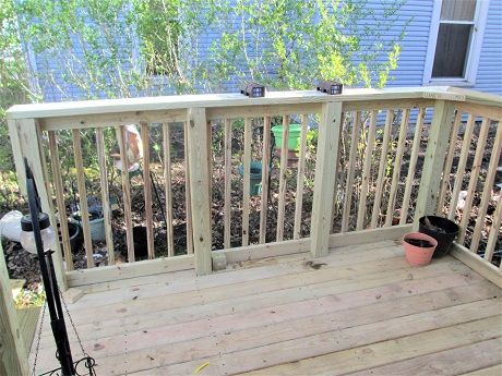

Got the top rail for the front done..2 x 8, then added a few spindles...
Added a post for the stairs' handrail..
Will do some figuring on the handrail set up tomorrow....mailcarrier liked the steps, though.

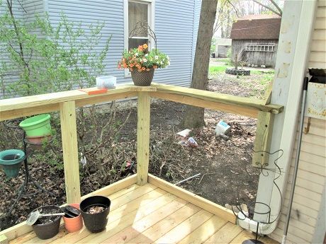

Got rid of the skinny 2 x 6 rail, replaced with a 2 x 8...mitered the back corner, added a blocking for the house number post..
And build the back part of the railing...
had to work around the downspout over here, too.   Do not throw away those 45 degree cutoffs....makes good corner bracing...

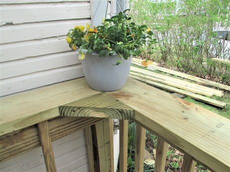

Front rail does a mitered return....for a plant shelf...strated the spidles at the back corner...
Scrap of 2 x 4 as a spacer...worked from the corner over to the house, then started along the side until the bundle of spindles was gone ( have a couple more)...
Got to about here, bundles are out on the sawhorses, drying out....getting a bit too sore for a Friday....put the toys away, and then all the clouds go away..
May go out and see if I can just do spindles for a while....stay tuned...
Well, bright and sunny, a bit cool....haul the drill/driver, and a box of 3" screws....Craig had hauled both bundles on to the deck...moved one over to where I could open it, and get a few spindles,,,,2 x 4 scrap to help the spacing...had to scrounge one extra spindle, to keep from opening the second bundle (gets a bit messy :CoveringEyes:)
Didn't really take all that long, either..another view?B)
From the "inside" looking out.   Details from working around that back downspout..

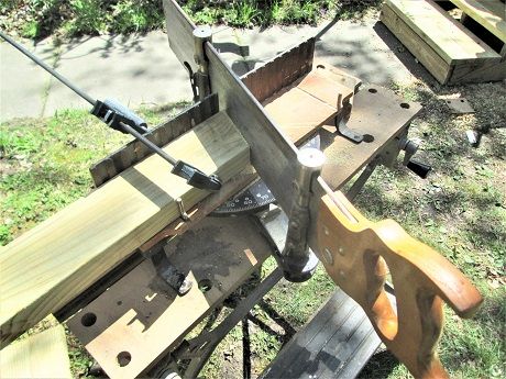

Wasn't that great of weather, this morning, Boss wanted to go shopping, and Lunch...got back home to almost clear skies, and warmer weather...drag out the toys, we have work to do...including the Miter box saw stand..:rolleyes:
A cordless one..:TwoThumbsUp:

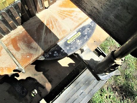

Had to find the angle of the dangle, first...:ChinScratch:
lay the brand new level down, the a huge bevel gauge, blade for plumb, body for the angle...19 degrees...set that on the mitre saw as 71 degrees..
There is NO notch to lock this in place, need both hand to keep things lined up, so a clamp was used to hold the wood.  Cut a 2 x 4 to the angle at both ends, and install it.    The 4 x 4 post out front was done in two cuts with the circular saw...too much handsaw work...attach the 4 x 4 to the stringer, checking for plumb....had a concrete slab under the 4 x 4, and used the 2 x 4 to mark the cut lines...then install it with 6" screws....spindles were also cut at the top..:Cheer:

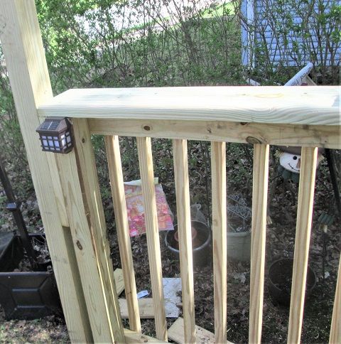

This sticks up above the railing, and will have the new house numbers installed to it..B)..was added to the south side of the steps..then the Boss wanted railing lights installed..:rolleyes:
Got these solar lights installed, put all the toys away, and am now having a "Cold One"   or two.:BugEyeSmiley:..One week to build a deck? :WonderScratch: with rain days, too.
