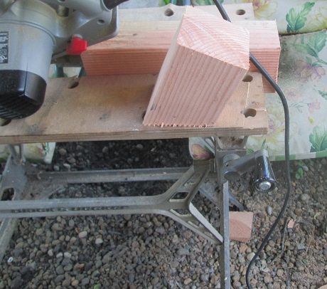

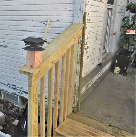

    Well, the rain has moved out of the area, for awhile....bright, sunny day out there.....so Tool box set up? Got the top rail for the front done..2 x 8, then added a few spindles...

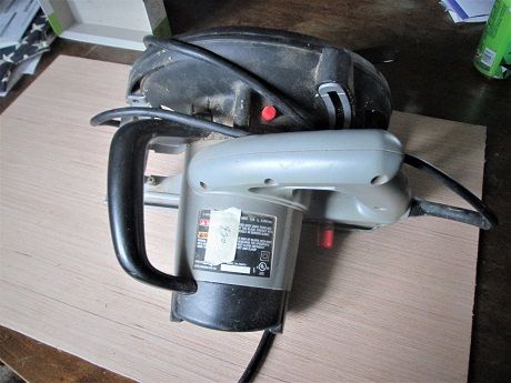

Circular saw has been fixed....meeting up of the "D" shapes cured it...
This thing weighs more than my old all-metal Sears one did...has a new blade installed, don't think I'll need this rip blade..
heavy Beasty...may use the lighter 6" Skil saw to trim deck boards...

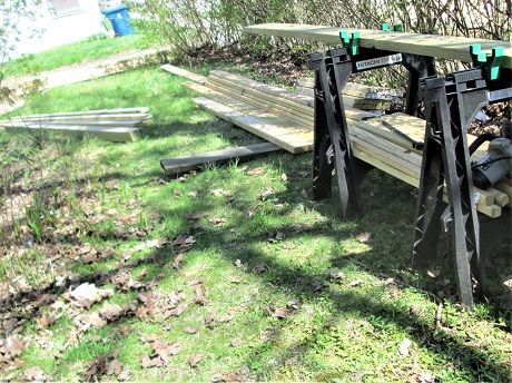

Roh-kay, Raggy....phone call said 0800 to noonish..:ChinScratch: This morning, another call said 1030 to 1045.:Tapping:..delivery was at 1100...:JawDrop:
Spent  awhile re-stacking all the lumber, taking the hardware into the house..inventory showed I was short 5 boards...4 x 4 x 10' that I needed to make the posts with,,:Tapping:
Spend most of the morning (0800 onward)  clearing away junk, dirt, leaves...and planters,,,even used a leafblower:BugEyeSmiley: To get things ready..

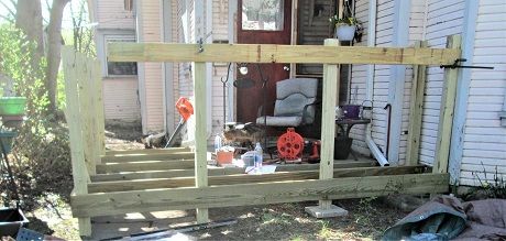

1st joist was installed  (tapcons to the concrete slab) then turned the corner twice...:TwoThumbsUp:
Back corner is sitting in a joist hanger...then the posts arrive...started adding those...cut them to 5'..
Grandson and my son helped get the posts in place, and things leveled up...then turn the next corner..:Cheer:
The Boss even came out to supervise...other end?:ChinScratch:
Into the wall...that be the last post, installed, today....decided to do a level line for the posts out in front...seems the concrete pavers were throwing things off a bit..:BangingHead:
Just a bit...that is what a sawzall if for...Harbor Freight clamps helped out, too..
Decided that 1730 hrs was close enough for quitting time.B)..tarpped the rest of the lumber, put all the toys away in the house, time for a "Cold One" ( or two?:rolleyes:)
IF it doesn't rain tomorrow...I will try to add the decking....first need a few more posts, and some blocking between the joists...more hangers to install..
Stay tuned...I might just get something done...:JawDrop:
