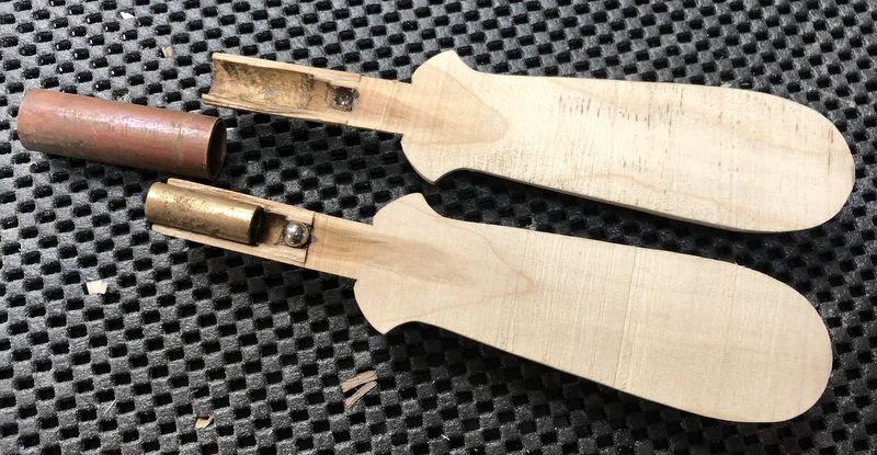

April 10, 20197 yr Author comment_186610 15 minutes ago, lew said: Thanks! I have a couple of Capt.'s bearing/sleeve kits. Looks like the "Elf" is much easier to use than the Sorby texturing tool I have- especially in small spaces. Here you go, this is the one I use most of the time. The extra long ferrule is important so a person can rest it on the tool rest and use their thumb as a fulcrum. Right on center will give kind of a flower pattern and above or below center will spiral in opposite directions. It's small, only 5 or 6 inches long overall. I'm lucky in that there is a store near that sells these carbide burs for cheap. This is the best type and about the only one I use anymore. They are cheap but I learned to take my handle with me as the shafts on the burs can be oversized . It happens that I did a demo on making one of these a few months back. I made this one and then cut it in half to show the members what it looks like inside. The bearing in these is magnetic and they are a press fit and glued into the wood. That's not 100% necessary but it helps to keep the bur from traveling out of the handle in use. No big deal if it does unless it gets lost in shavings. If you have any questions please be sure to let me know. Report
April 10, 20197 yr comment_186611 25 minutes ago, Steve Krumanaker said: I learned to take my handle with me as the shafts on the burs can be oversized . Thanks for that information. Looks like I have anew tool to make!! Report
