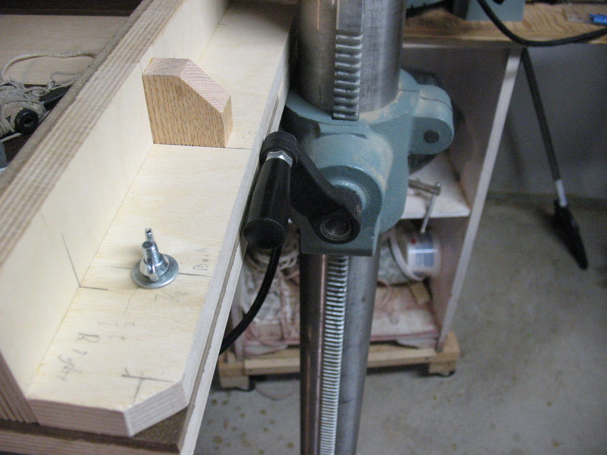

Just realized that with the auxiliary table close to the column the table elevation handle hits the auxiliary table.  I could pull the auxiliary table forward to give the handle the clearance it needs or I could rework the elevation handle.  I've seen a few modifications to the elevation handle that will allow it to work with the auxiliary table up against the column.  Suggestions?

The easiest solution that I saw used a socket and ratchet wrench.  I figured I'd give it a try. The current crank is secured to the D shaped shaft with a set screw.  I removed it and slid on a socket.  I started to drill the socket for a set screw but it was really slow going.  So I cut a small piece from a plastic card, set it on the flat side of the D shaft and slid on the socket.  The plastic card provided the right amount of snugness to prevent the socket from free spinning or slipping on the D shaft.  The ratchet raises and lowers the table very easily so I'm quitting while I'm ahead.  The ratchet is a lot easier to use than the small crank that came with the drill press.

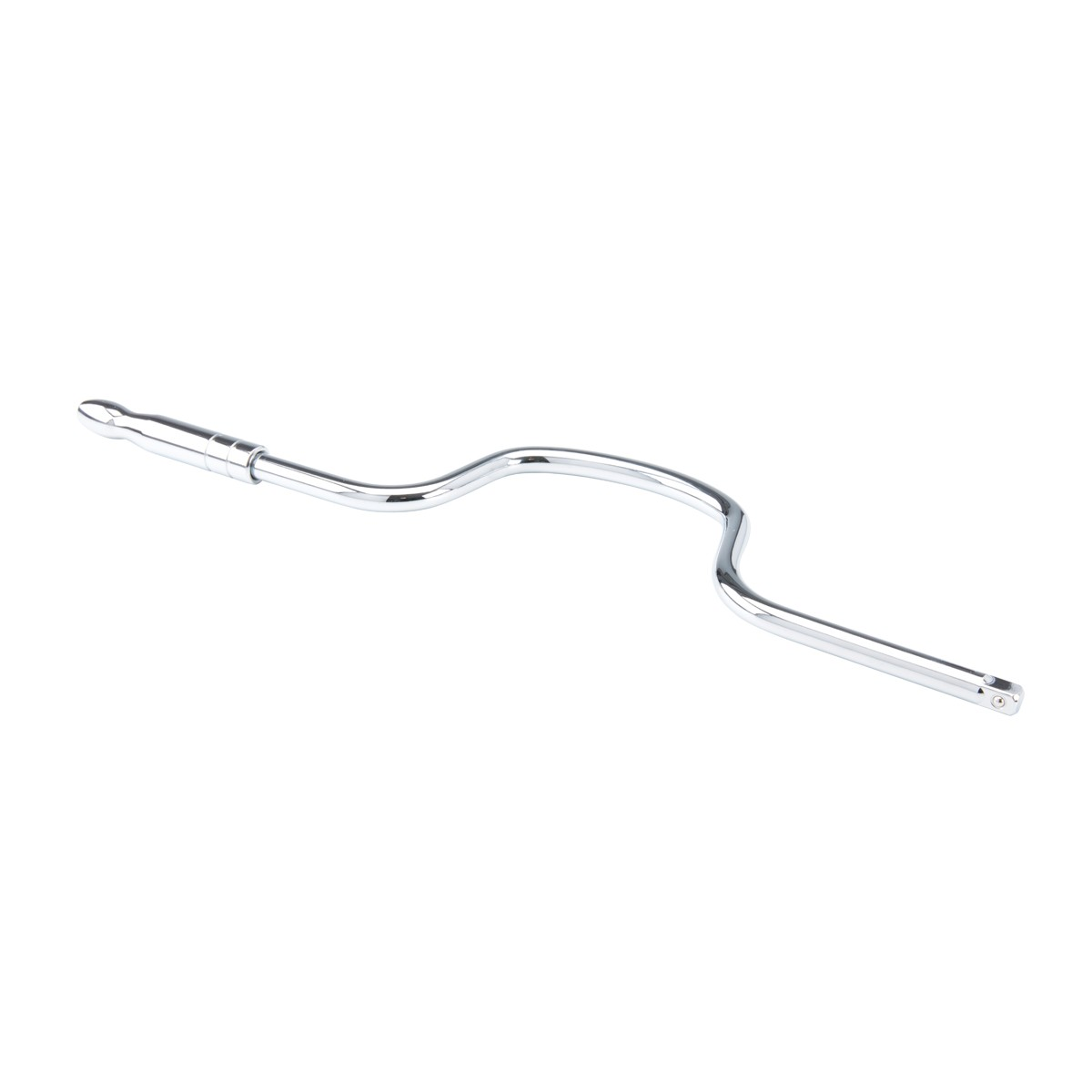

Is your socket 3/8" or 1/2" square drive? If you have a "speed handle" try that instead of the ratchet.
If you want one dedicated, stop in at H-F. 3/8" Speed Handle is selling for $7.49...20% off makes it an even 6 bucks. 1/2" is $9.99 less 20% =$8. Pittsburg Tools have a Lifetime Warranty.

I replaced the crank with a ratchet.  As you can see I didn't really extend it.  It's in just about the same position as the original.  I can reach it by extending my arm either over or under the table.  The height adjustment clamp is on one side of the shaft that supports the motor and the crank/ratchet is on the other side.  As you can see the crank handle rotation is restricted by the new auxiliary table.  The ratchet raises and lowers the table much quicker/easier than the crank did.
Thanks for the picture and how to on what you did.
