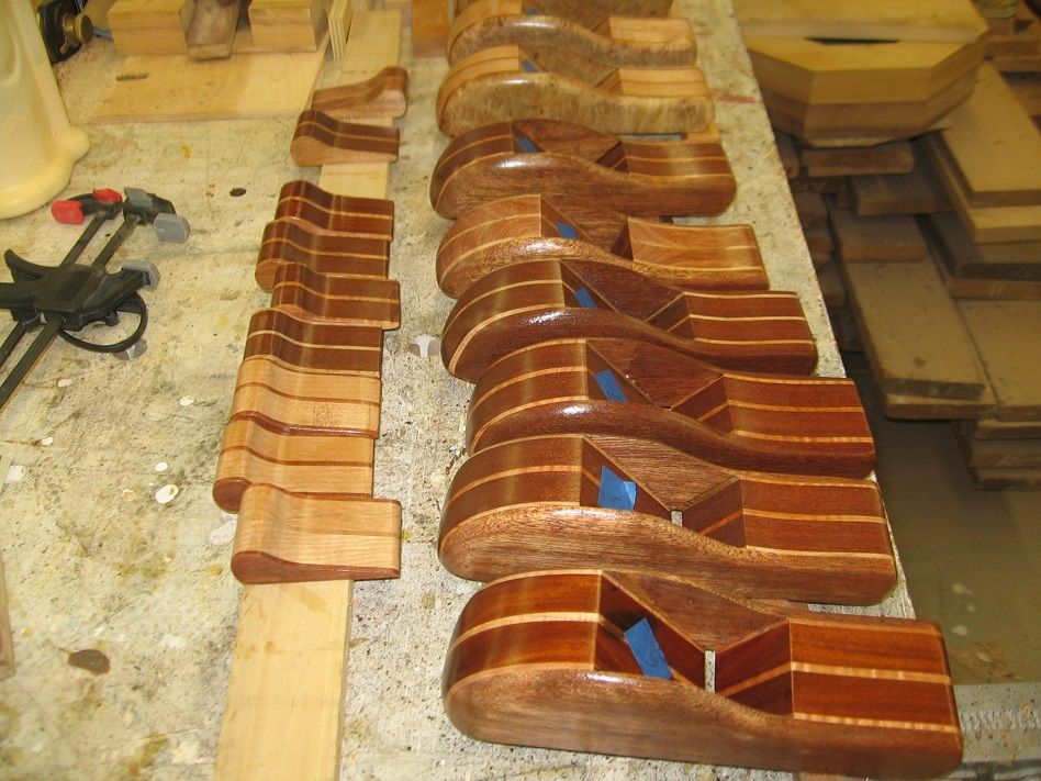

  • Today I cutout the shape of the plane to match the side panels.   I will save the last piece I cut off to make the wedge that holds the blade in the slot.       Now

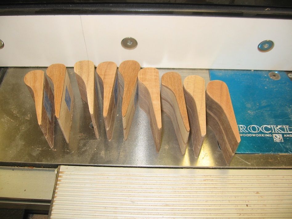

So today I just worked on the wedges that hold the blades in the plane bodies. I used the scrap that was left over when I cut the planes out. That way the stripes match each plane they came from.

Those planes are great Herb.  What's the metal patch on the flat side for?
I KNOW!!!! I KNOW!!!
piece of identity tape to keep the parts synced...

Stick is right ,the tape on the back is for easy reference to which plane gets what. Some are very close to the same.

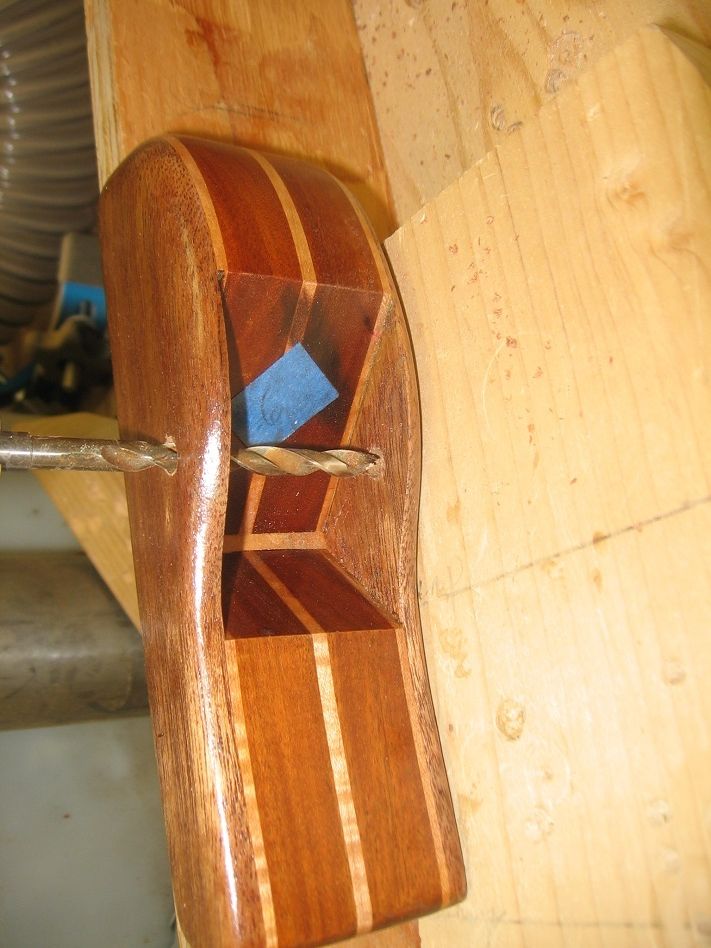

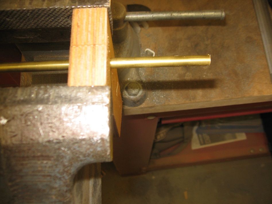

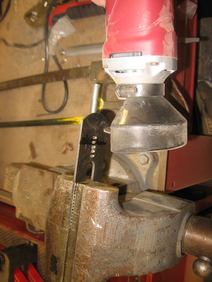

I am working on the second Phase of 9 more now and the 1/4"brass rod arrived from McMaster Carr, so I fitted up the blades for a couple of planes to see I  was doing every thing right.

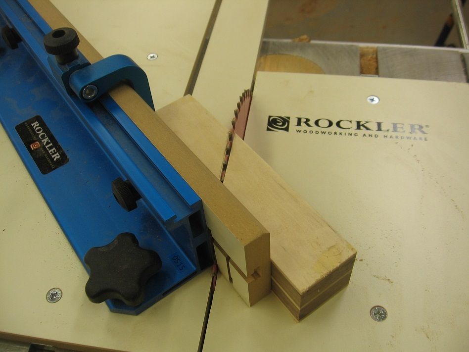

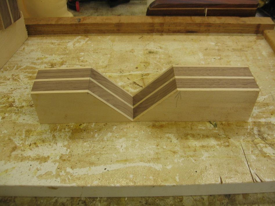

Phase II:
Then cutting the blocks into 2 pieces.
Turning the forward piede over to form the "V" for the blade
Glueing the sides on to hold the 2 pieces together.
While those are being glued up, I will start detting the pins in the first bunch.
First drill the hole, then cut the Brass rod. Each plane is a tad different width, so I will cut each rod separate.
Next is cutting the plane blade to length and installing in the plane.
IMG_5169.JPG.1cd9cd1aafde781d1a232f98f822edcf.JPGIMG_5170.JPG.cffdbe20a19fc2a517ab761bf85c5f3f.JPG
That is it for today.
Herb

What's the brass rod diameter? 3/16"? 1/4"? How much under-size is the hole to retain the pin?
Good choice on the cut-off tool...got one just like it====>GO H-F!
