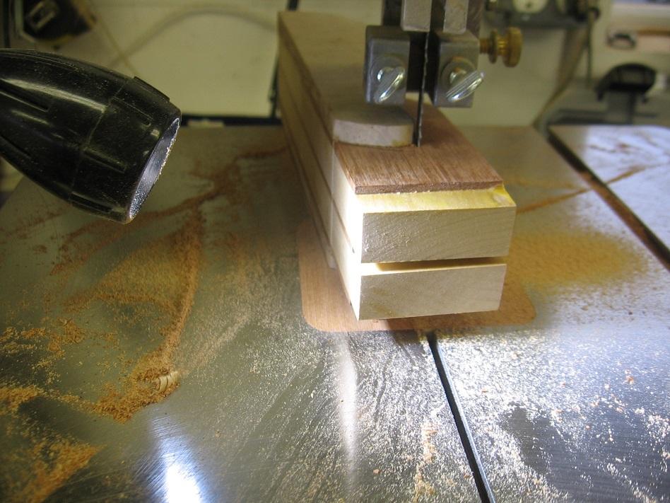

After they were sanded close to size I cut the blocks I had previously glued up 4" from the heel of the plane to the mouth of the blade slot on a 45°angle. The cut-off is then turned over and butted up tight to the heel piece,thus creating a "V" for the plane blade to rest in. and the sides are glued on to hold the assembly together.
It takes lots of clamps to dlamp these up , I ran of two planes short and had to wait to finish the final two.

  • Today I cutout the shape of the plane to match the side panels.   I will save the last piece I cut off to make the wedge that holds the blade in the slot.       Now

Today I cutout the shape of the plane to match the side panels.IMG_5144.JPG.172dd4b09146cb7c259d6a393a44030f.JPGIMG_5145.JPG.e18e8ce7082b997161b37d08dd4f17c5.JPG

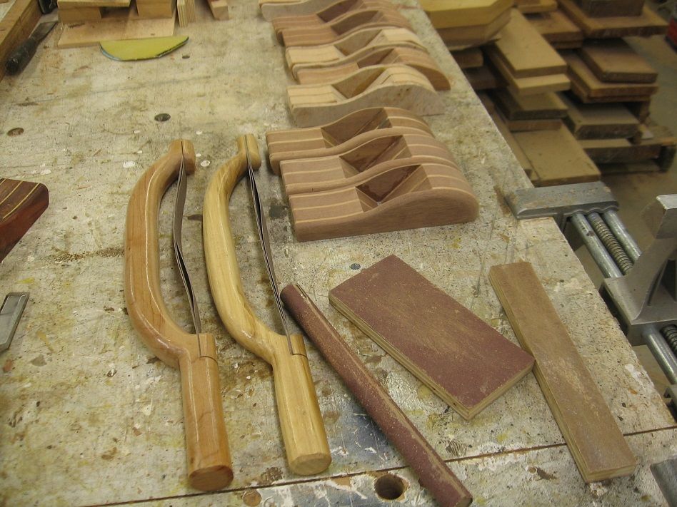

Well they are starting to take shape now, I worked on the finish shaping the bodies today. The disc and stationary belt sander got them close, I passed them over the jointer to square up the sole to the sides and open the mouth so that a blade will just barely slide thru. Then I finished them off with a sanding block and a bow sander. Then to the ROS with 320 grit before giving them a shot of Shellac.

5 minutes ago, Stick486 said:
tell us more about your sanders...
+1./..please
I am with Stick and would like to know more about your sanders. Thanks for all the hard work putting together this tutorial. these planes your making are and look even better. Are you giving a plane to each club member or are you using them just for your presentation?
What sanders?
@hawkeye10 I am giving one to each member that attends the meeting.
Edited by Dadio
2 minutes ago, Dadio said:
What sanders?
3rd picture down the bows that have thin strips of sandpaper attached to them.
You must mean the bow sanders, those are the ones I made for Christmas gifts  for the WW's group either last year or the year before , they have 80g,120g,150g. on them,I did a tutorial on them, I will see if I can find it.
