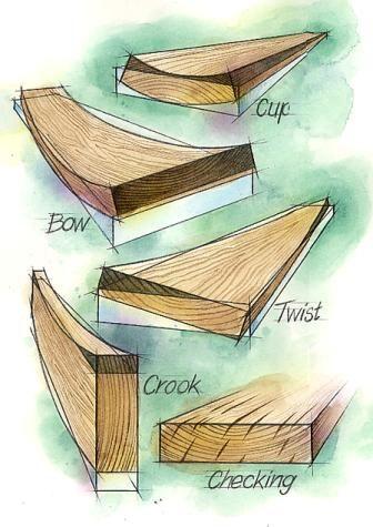

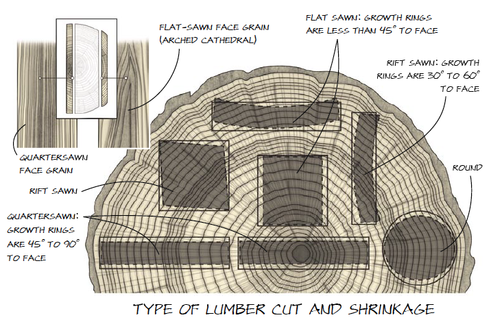

Here's some FYI that might be helpful.... (click the pictures to enlarge)...
Ch02 STRUCTURE OF WOOD.pdf
Ch03 PHYSICAL PROPERTIES AND MOISTURE RELATIONS OF WOOD.pdf
SAWN WOOD DIFFERENCES.pdf
CHARACTERISTICS OF WOOD and DEALING WITH THEM.pdf
MOISTURE CONTENT AND MOVEMENT.pdf
Wood Moves, Get Over It.pdf
468591337_SAWNWOODDIFFERENCES.png.52c829f526beba972db9068d2ca32a7f.png  385313364_shrinkagewoodmovement4.jpg.9ff68fa9e86cee59f923d688a9efb796.jpg  792235402_shrinkagewoodmovement2.png.2e420a2ac774819569bbcbb020878082.png  302995962_shrinkagewoodmovement3.jpg.08b538a4f8b05693bc8ca2a372912c77.jpg
