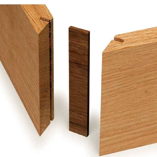

Spline? You mean like biscuits?
as in spline...
use BB ply for that type of glue up......

I will use splines when making the mitered corners. That was a nice piece of learning there, thank you Mr Stick.
miter corners w/ splines ya say...
Stick, I believe he will be making the miters on the corners on the flat corners of stiles and rails . Not as pictured here. He plans to cut the corners 45 degrees

use BB for the splines...
strong and very stable..
for contrast ... dip the end of the spline in stain or dye color of your choice before glue up...

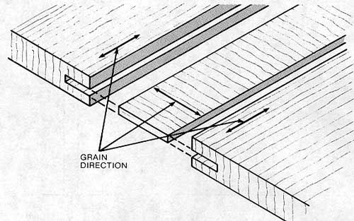

So I’m going over this in my head. Assuming the rails and styles I’m making fit, and the 2 pieces of Polar I’ve glued up will plane perfectly flat, that leaves me with fitting the raised panel into the framework. The question I’m leading up to is if we leave space (which is why we use the space balls/backer rod to make adjustments for) do I need to put a least one coat of paint on the panel before I assemble it? I mean it is winter time here in the NE region, and the panel wil most likely only expand in the future, not contract more than it is now, but if I paint it after assembly, can’t it contract to where unpainted surface could appear? These are the kinds of thoughts that pop in my mind, while I’m laying in bed, trying to sleep. Which I’m off to. Good night, and thanks for any help :)

I'm not an expert when it comes to finishing Artie, but I don't think it is necessary to paint the panel first. I've bought unfinished wood raised panel closet doors. After painting them I've never experienced one shrinking enough to show any unpainted area. All the raised panel doors I've built were either varnish or urethane finished. I have never seen any evidence of areas with no finish. You will be building the doors at room temp and they will be installed in a home that won't vary much from the temp when they were built. If exposed to extreme temp changes and/or extreme moisture variations,you may see some unfinished areas. By not gluing the panel in place, it allows for expansion and contraction in all directions. If the panel were glued in place, it could cause stresses that may cause cracking in the wood.

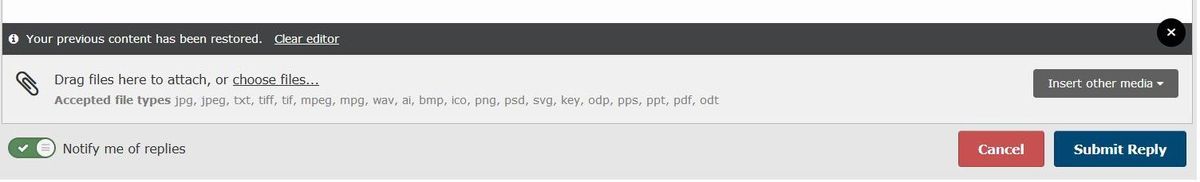

Must have been something I did stick. :WonderScratch:
some times the resident editor saves what you didn't post and needs to be cleared before you carry on...
the ''editor'' shows up as a notice at the bottom of your post..
click the ''X'' to clear it...

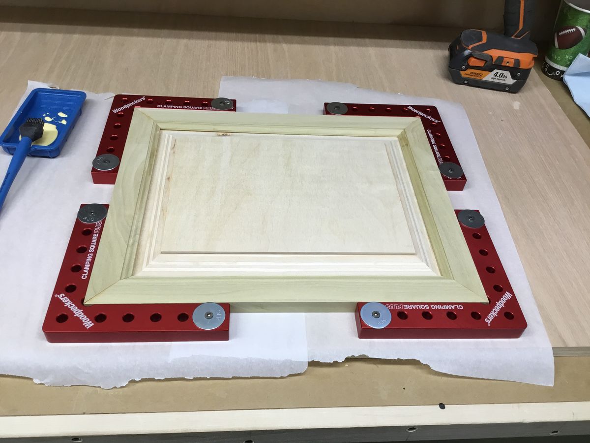

On 1/5/2019 at 6:17 PM, Artie said:
I didn’t use any glue on the locations of the three clamps, with them being wood, figgered that could have a bad ending.

I thought I posted these last night, musta forgot to hit submit button. This was the way I came up with to glue-up, any suggestions/advice/opinions/comments welcome and sought after. I used Mr Sticks advice and put wax paper underneath so no glue sticking to anything I didn’t want it to.
Looking good Artie !
Great job Artie. I think you got this woodworking thing down. Having fun too aren't you?
