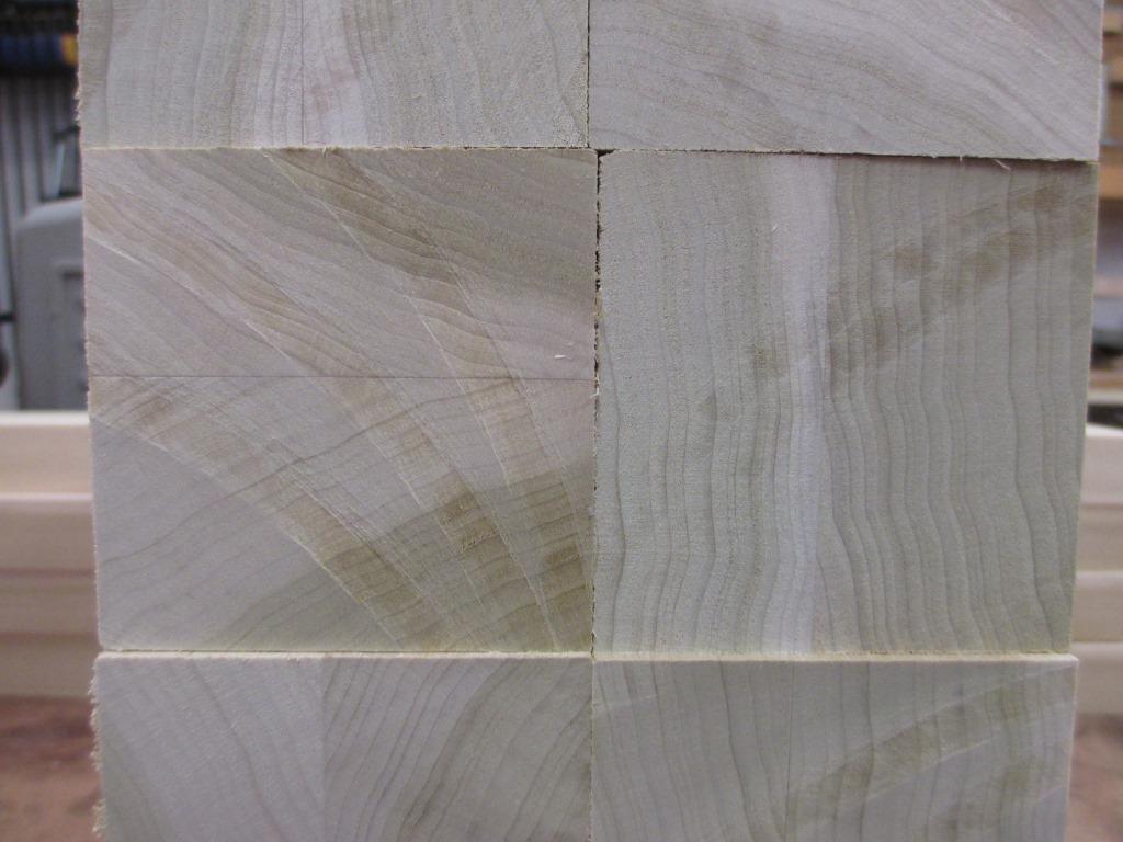

My table saw was set-up with a Forrest Woodworker II 10”-40 tooth, .125” kerf saw blade.  The wood was clamped to a miter gauge to prevent slippage while cross cutting.  I made additional cuts, on other boards, using my TS cross cut sled and had similar results; same results using my rip fence.  I measured the parallelism between the blade and the miter gauge slot and it was 0.002”.  The blade was clean and does not appear to be damaged.  The blade is a used blade but appears to be sharp.
I removed the FWWII blade and installed my Ridgid 10”-50 tooth blade and received good results.  I made the same comparison with my Freud 10”-80 tooth plywood blade and my Freud 10”-24 tooth rip blade.  Both Freud blades gave me good results.
It appears that I have an issue with my FWWII blade.  I do not remember hitting anything while sawing or damaging it.  Do I need a new FWWII blade?  Danl

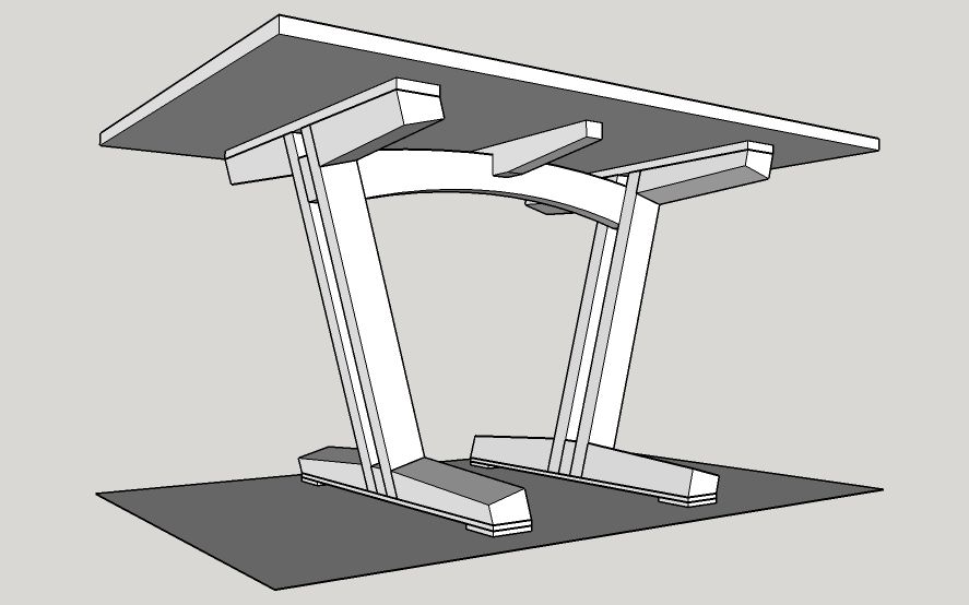

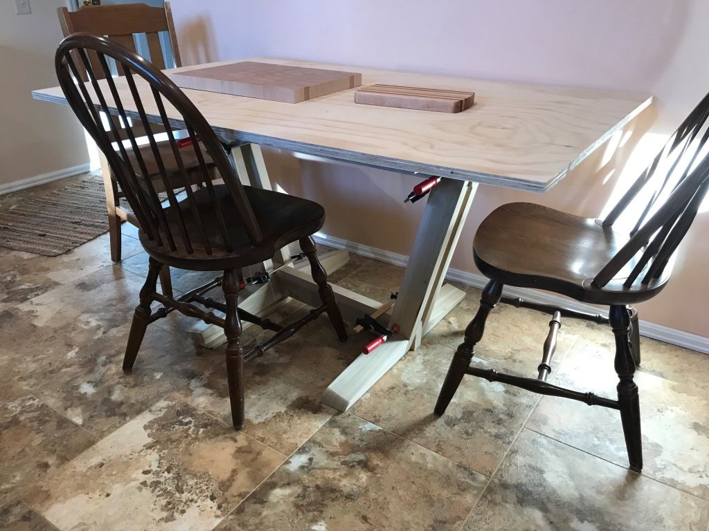

  • I’m attempting to fab a trestle kitchen table.  I built a prototype from poplar & plywood.  Production table will have a cherry base and maple top.  Danl

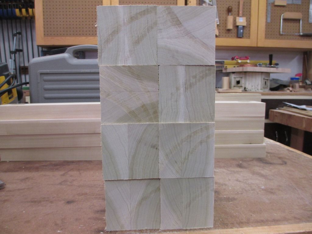

  • I believe I fixed my problem.  I had the blade sharpened for $9.00.  The blade may of been damaged, but I did not see the damage.  Danl   Original crosscuts   Crosscuts after

    With that design, that will be a beautiful combination of woods Dan. Looking forward to see the project unfold. Your prototype isn't too shabby either as long as you keep the clamps tight.

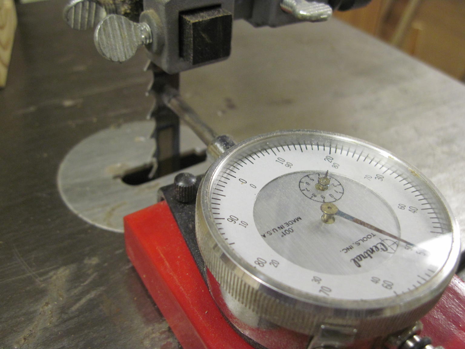

As Gene/Stick suggested Dan...if you have a dial indicator and magnetic base, position the indicator point just below the tool, slightly preload the indicator, zero, then slowly rotate the blade. Should be minimal run-out. I suppose it's possible too there is a slight burr or disruption at the blade arbor hole causing the blade to mount crooked.

I took 24 measurements using a dial indicator, front and back of the saw.  The front measurement delta is 0.0035" and the back measurements delta is 0.0030.  Forrest website indicates that the Forrest saw blades are mfg within 0.001" and that other mfg allow 0.004/0.010.  Do you have any suggestion what may of caused the warped effect?  What did I do but don't remember?  Danl

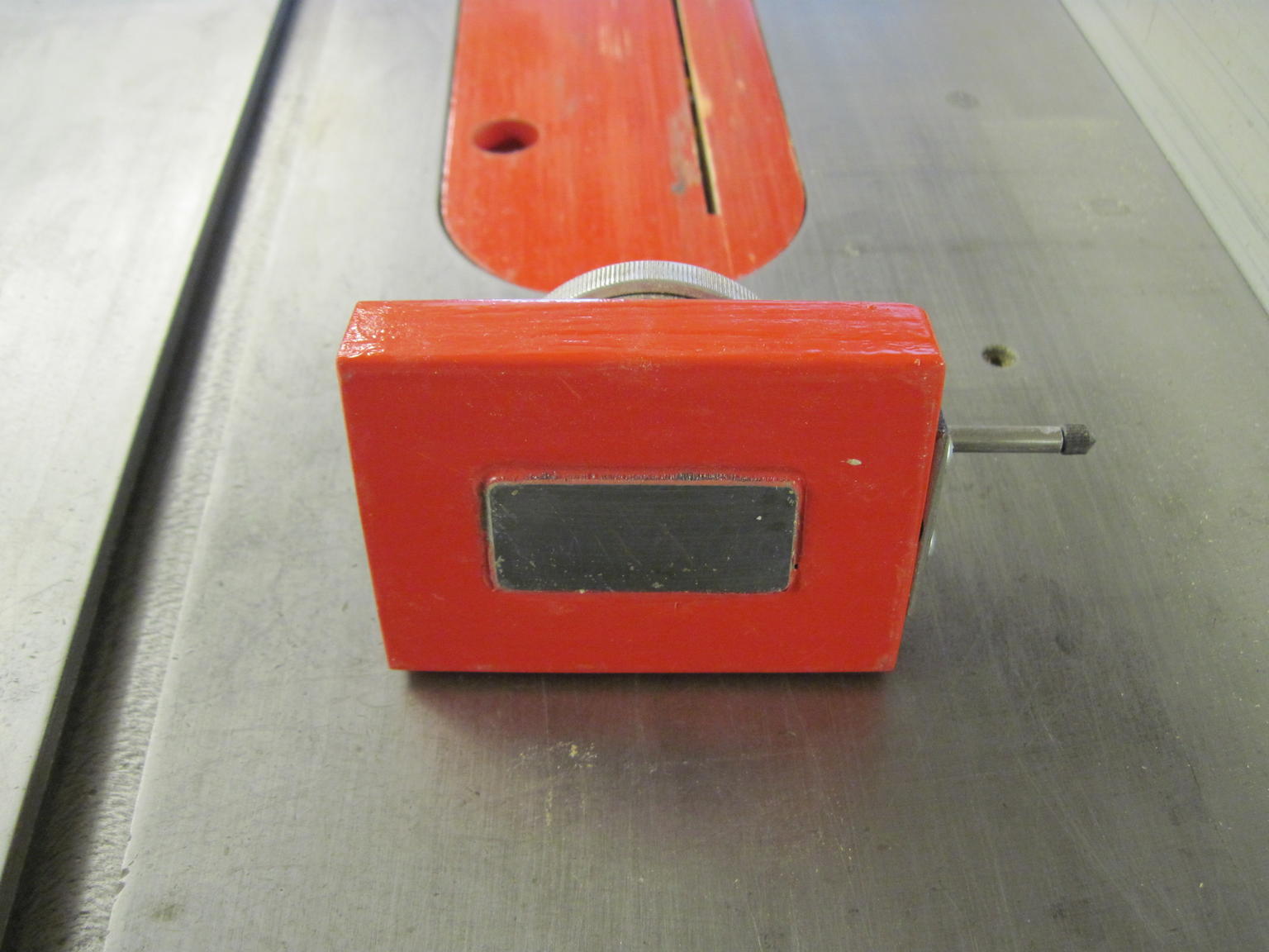

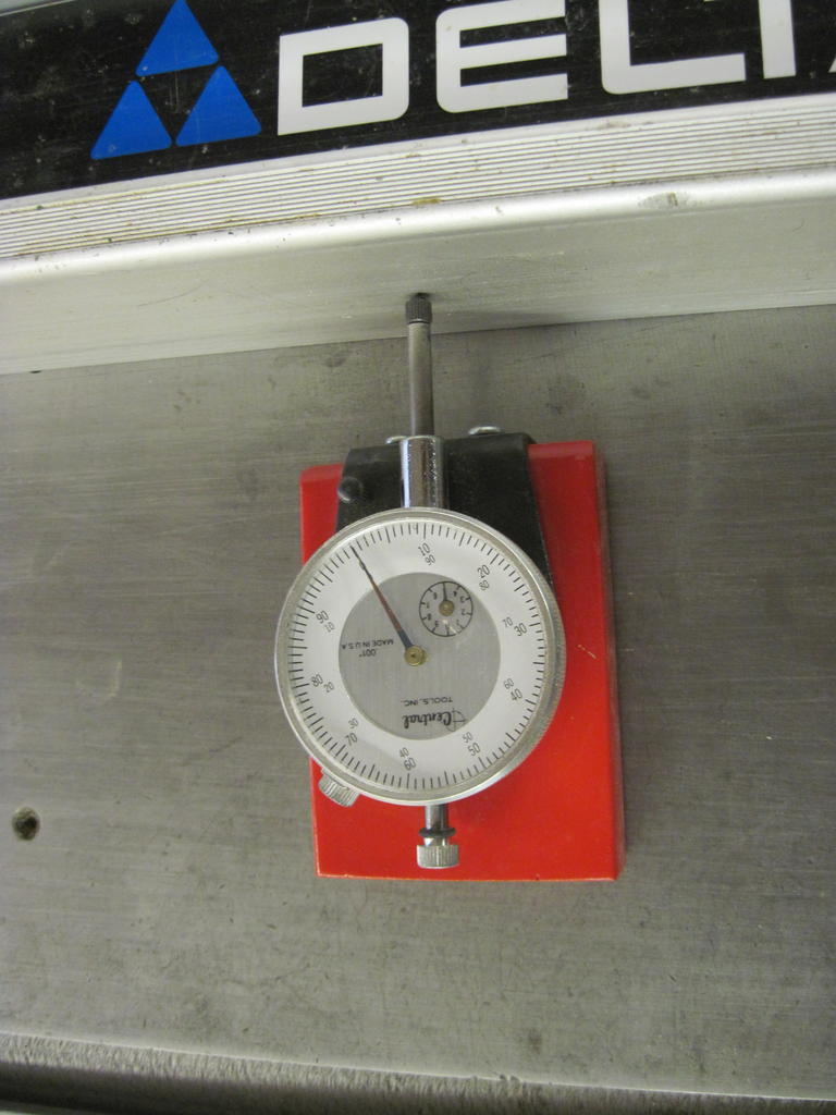

I made this years ago.  Been a great little tool for stuff like this.

The earlier measurements were take from the blade body, every 30 degrees.   Today I took measurements every 4th tooth on the side of the tooth.

I put the blade back in the saw and made approx. 50 cuts on SYP 2 x 4 material.  I had 5 cuts which made a scoring.  With these results I concluded that my issue was user error only because I am perplexed.  Leaving the blade in the saw, I made 8 cuts on 1-1/2" x 3" poplar.  Two of the cuts left scoring.   This time, it was only 1 score mark and not 3 like the pic show.   Now I'm really confused.  Christmas money is already spent and my birthday is months away.   Looks like I may need to do my cross cutting with my $50 Ridged blade (until now, I only used this blade to cut pine matl)  Danl

Only one side.  My dial indicator set-up is shop made and ref from the left miter slot.
