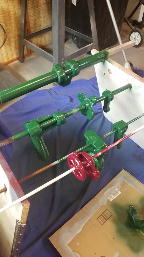

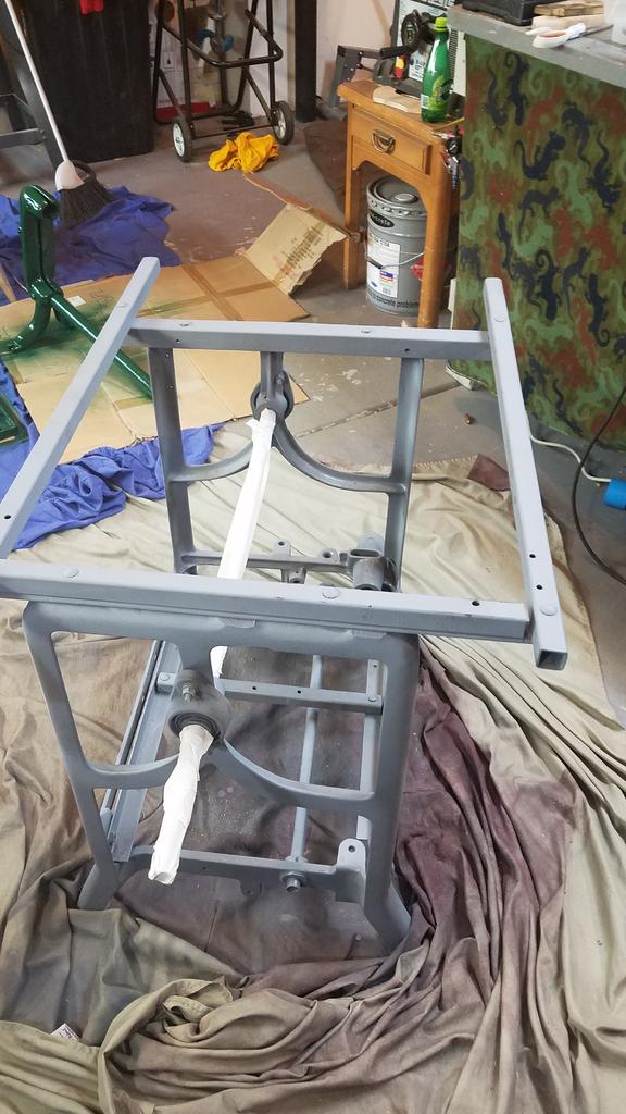

Popular Post Monkey Paws Posted November 22, 2018 Author Popular Post Report Posted November 22, 2018 Well the project is moving along nicely. I haven't posted in a while so I will play catch up here. I cleaned all the parts and prepped, applied primer and painted. I had to adjust the box tubing on top so the screw holes will be in a straight line on the tabletop. This involved cutting new angle iron and drilling holes. I cleaned the electric motor and shot a topcoat to make it look nice. I managed to have the motor fall on my foot. Lots of choice words nothing broken. Next step is the wood table top. As you can see my shop is a disaster zone. Cluttered bench, Cluttered mind. What does an empty bench mean? Grandpadave52, DuckSoup, Dadio and 4 others 7 Quote
Gene Howe Posted November 22, 2018 Report Posted November 22, 2018 Looks like it's coming along nicely. Like your paint scheme. Green and red...ish. Christmas colors. As to your cluttered shop...to paraphrase a sign Phyl hung in the kitchen.."A neat shop is a sign of a sick mind." Cal, Grandpadave52 and Larry Buskirk 1 2 Quote
Grandpadave52 Posted November 22, 2018 Report Posted November 22, 2018 2 hours ago, Monkey Paws said: I managed to have the motor fall on my foot. Lots of choice words nothing broken. Good thing your foot was there. Glad the motor is OK. Cal, Artie and Larry Buskirk 3 Quote
Grandpadave52 Posted November 22, 2018 Report Posted November 22, 2018 2 hours ago, Monkey Paws said: applied primer and painted. Looking great so far. I like the color scheme. Perfect for this vintage of machine. Assume the primer is "rattle can??" What's the brand? Maybe it's the lighting, but appears to be an off-white primer. I like the looks of it over grey primer. What is your red shade? It looks close to IH-Farmall red? Cal 1 Quote
Monkey Paws Posted November 23, 2018 Author Report Posted November 23, 2018 13 hours ago, Gene Howe said: Looks like it's coming along nicely. Like your paint scheme. Green and red...ish. Christmas colors. As to your cluttered shop...to paraphrase a sign Phyl hung in the kitchen.."A neat shop is a sign of a sick mind." The Green/ Burgundy color scheme has always been a favorite of mine. Looks even better when you have a lot of polished brass. Cal, Grandpadave52 and Larry Buskirk 3 Quote
Monkey Paws Posted November 23, 2018 Author Report Posted November 23, 2018 10 hours ago, Grandpadave52 said: Looking great so far. I like the color scheme. Perfect for this vintage of machine. Assume the primer is "rattle can??" What's the brand? Maybe it's the lighting, but appears to be an off-white primer. I like the looks of it over grey primer. What is your red shade? It looks close to IH-Farmall red? The primer is Krylon rust protector light grey and the Burgundy is made by Rustoleum Cal, Larry Buskirk and Grandpadave52 3 Quote
Monkey Paws Posted November 23, 2018 Author Report Posted November 23, 2018 11 hours ago, Grandpadave52 said: Good thing your foot was there. Glad the motor is OK. Motor only weighs about 50lbs Larry Buskirk and Cal 2 Quote

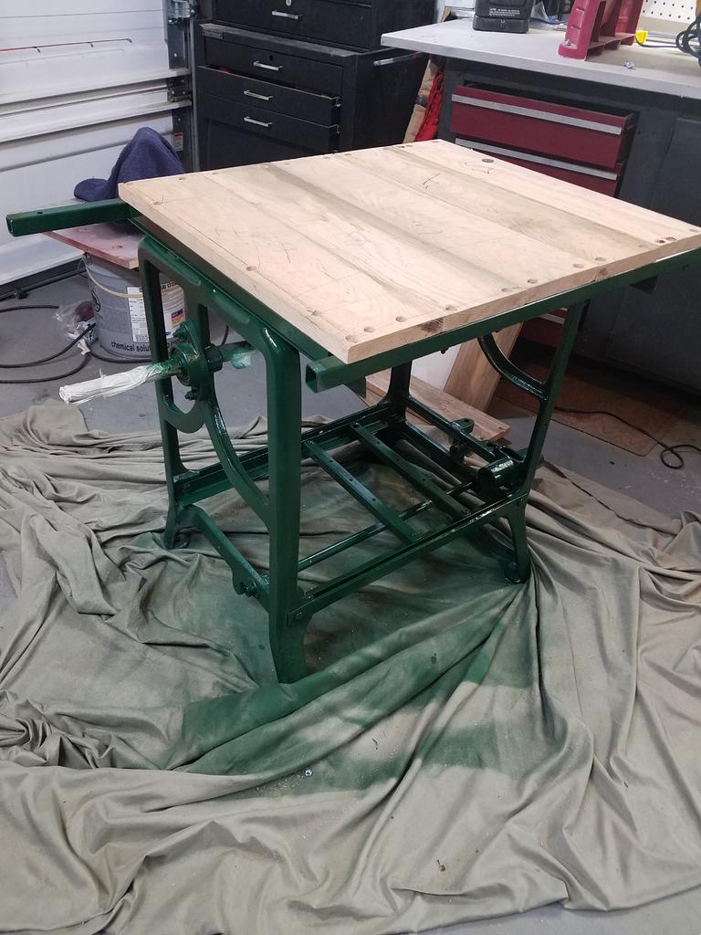

Monkey Paws Posted November 23, 2018 Author Report Posted November 23, 2018 I started working on the bench top today. I managed to get the wood bolted down to the frame. Now I have to trim up the box tubing on the end opposite the saw frame. I plan on using boiled linseed oil as a finish on the wood to protect it. Between visiting my wife at the care center and taking care of business at the house this project is keeping me busy. I still have not decided what the logo for the saw is going to look like but I still have time. My next project will be a 200+ year old Brown Bess Musket from Kathmandu Nepal I am looking forward to that one. Grandpadave52, Cal, DuckSoup and 1 other 4 Quote

Monkey Paws Posted November 25, 2018 Author Report Posted November 25, 2018 Hello All, I have been steadily working on this saw while I wait for my wife to come home from the physical rehab center. I did a test assembly today to see how everything fit. As you can see it went together fairly well but there is always room for improvement. I am still working on the finer aspects of woodworking. The table is made from water stained oak with spruce trim. I have a few gaps in the wood here and there but I can live with that. I am going to finish sanding and then apply some BLO to the wood. I need to find a source of locking collars you put on drive shafts. Does anyone know a good source? I can't wait to get her back in service. DuckSoup, Cal, p_toad and 1 other 4 Quote
Grandpadave52 Posted November 25, 2018 Report Posted November 25, 2018 (edited) 4 hours ago, Monkey Paws said: I need to find a source of locking collars you put on drive shafts. Does anyone know a good source? Assuming 3/4" or 1" shaft dia.? Locally Kenny, do you have a Farm & Fleet or Tractor Supply or any other type of farm supply stores? Most carry open stock lock collars w/o buying the matching bearing. Another source would be any Farm Equipment/Implement dealer...e.g. John Deere, Case-IH, New Holland, etc.; Do you have a Motion's Industries or Fastenal franchise location? Both maintain inventories in my area but we are an agricultural community. Edit add: Oh yeah, the saw looks great. That table will be perfect with the BLO finish along with the saw color scheme. Prayers your wife continues to improve and is home soon. Edited November 25, 2018 by Grandpadave52 Quote
Larry Buskirk Posted November 25, 2018 Report Posted November 25, 2018 Kenny, The saw is looking real good! Ace Hardware, True Value Hardware, and those that Dave mentioned should all have locking shaft collars. Quote

Popular Post Monkey Paws Posted November 26, 2018 Author Popular Post Report Posted November 26, 2018 I got home from work and applied the BLO to the wood. Gotta love the look of BLO on bare wood. I am hoping to have this operational very shortly. I have an idea that I really need an opinion on. When I turn this beast on I am standing next to a lot of moving metal and this thing has no guards on the blade. I am not a fan of decorating the shop with my body parts so I have an idea for guards. I was thinking if getting some 1" flat stock and making a rectangle that goes across the front of the wheel and attaches behind it. I would look like a single bar going across the front of the wheel. This would prevent the blade from coming all the way off and removing parts from my torso. I have seen other DIY guards that look like doo doo and I do not want to do that. Opinions please. Dadio, DuckSoup, p_toad and 4 others 7 Quote
Gene Howe Posted November 26, 2018 Report Posted November 26, 2018 Table took the BLO beautifully. Another bar, vertical at 90 to the cross bar, would offer more protection, IMO. A shroud would be even better. DuckSoup, Grandpadave52 and Cal 3 Quote
