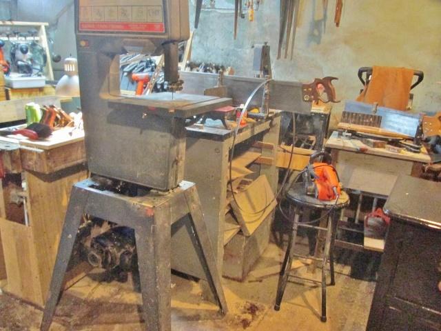

steven newman Posted June 27, 2018 Report Posted June 27, 2018 Issues with my Craftsman 113. 27350 bandsaw......way to much shaking going on....drive wheel wobbles.....tore the thing down today.... Removed both the belt pulley and the lower wheel.. 2 wheels, only found one key stock....one for the belt pulley was MIA. Large snap ring holding the shaft in place on the belt side.. Metal cap swings down out of the way, once the shaft is out... (nice and cleaned up..) to get the shaft out, I had to remove these two bolts..which went right back in as soon as I could....hate losing parts. Shaft "looked" good when it came out, and the rust removed.. Bearings themselves are fine, it seems to be a problem with the shaft itself.. Mainly on the drive wheel side. Bearing will slide around a bit. Looking like a new shaft will be needed...I did find my snap ring pliers..finally.. Need to skinny the points down a tad, so they fit. Will take the shaft, bearings and all to the TSC Store, and see what they have handy. Bearing No. 3203 RS FAG..... Wondering IF I can find a washer that fits over the snap rings, and can be held in place with those two bolts. Maybe tighten things up a bit? IF I need a bandsaw for the next project..we have back-up.. That little 12" Craftsman 3-wheeler will do for the small stuff....has a 3/8" blade onboard. Would have to dig it out of the hole... And..NO, I am unable to just go out and buy a new/used bandsaw right now....not an option. Will just have to fix what I have. p_toad, HARO50 and Cal 2 1 Quote
Grandpadave52 Posted June 27, 2018 Report Posted June 27, 2018 (edited) Do you have pictures of the shaft with the bearing(s) removed Steven? Assume that is just a spacer between the bearings? If the shaft is undercut from the bearing spinning on the shaft, you might be able to "peen" the shaft to "increase" the diameter slightly then use some Loctite to help retain. You also might be able to repair by peening, then "building" up with lab metal. Of course you'll have to file down to resize to fit. If you have any machinist friends, they probably could repair or make you one as well. BTW...you sure your model number is 113. 27350? When I type that in to Sears Parts Direct, it doesn't match up to a bandsaw... I have a book for a 113.24201 which is very similar...assuming the shaft is the same part (69058) Sears Part Direct does show it in stock... I have a Model 113.243311 which is also almost identical except has the aluminum vs cast table. Parts list shows the same shaft number for it too. Check your PM's Edited June 27, 2018 by Grandpadave52 steven newman, p_toad, HARO50 and 1 other 4 Quote
Smallpatch Posted June 27, 2018 Report Posted June 27, 2018 If you have a machine shop close by they can cut you a key way on a rod real quick.....That bearing does show to be leaning a little on that shaft. A bearing supply stocks bearings in that size range if needed. You also might put some Locktite on those set screws when reassembling and make them real tight.. I think you are kinda lucky for those old three wheel saws are the devil to get the blade to stay on the wheels. steven newman, Cal, Dadio and 1 other 4 Quote
steven newman Posted June 27, 2018 Author Report Posted June 27, 2018 Was very scratched up....finally read the number as 113.24350 Will see what TSC has, tomorrow.... Just a pipe-like spacer between the bearings. Quote
steven newman Posted June 27, 2018 Author Report Posted June 27, 2018 (edited) Did a bit of shopping this morning....until I have the spare $40 or so, and order the new shaft. There IS a machine shop here in town...IF you can catch them open.. TSC was a source for keyway stock.....and not much else in the way of help. Bought a new pair of snap ring pliers, hoping they would fit the holes..nope. Bought a LARGE washer, big enough to sit just outside of the snap ring. Then ground the O.D. down until it matched the O.D. of the bearings. Assemble things back together....even the new keyway piece. Gave thing a test run....no blade. Had the blade wheel too far in, and the pulley as well. Adjusted those.. Motor is now having "issues" again. Hand starts.....keeps popping a breaker....motor is not the kind with oiled bearings. Finally got things to run for quite a while... Re-installed the blade......found out about the wheel being too far in.... Worked on the table's locking bolt, so I could at least tilt the table better. Minimum tension on the blade...start up....motor issues, again...Finally got the saw to run....then it slowed to a stop...motor again. Took the belt off the motor, and let it run about 10 minutes.....may have "blown out" some crud inside....runs a bit better, now. Restarted the saw, tried a simple crosscut.....blade tracks better....cut looked better. Need to work on this a bit more.....until I no longer have to do a hand-start up. Had these issues last year, too. OEM motor.... Will do until I can save up for the new shaft. Just have to "baby" it until then.... Edited June 27, 2018 by steven newman Fred W. Hargis Jr, HARO50, Grandpadave52 and 2 others 3 2 Quote

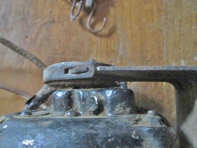

Popular Post steven newman Posted July 5, 2018 Author Popular Post Report Posted July 5, 2018 Well...lookee what was at a Estate Sale this morning.. $3 is too hateful? Wire wheel things can go elsewhere...new cord isn't that hard to do....will clean it up, and test run it....both to see how it starts and runs...and WHICH way it runs...has oiler bearings....also spent $2.50 on a package deal.. A 3" and a pair of 4" c clamps....kind of a skimpy morning... HARO50, Grandpadave52, Cal and 2 others 5 Quote

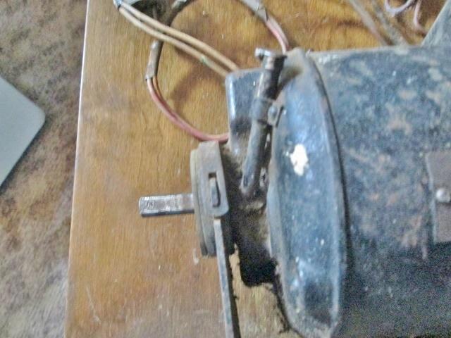

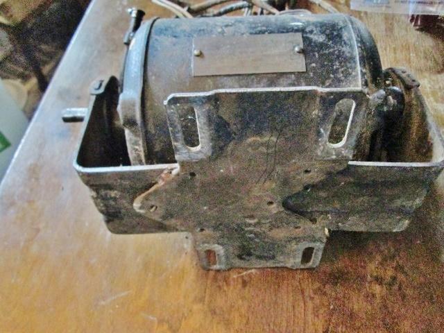

steven newman Posted July 6, 2018 Author Report Posted July 6, 2018 More info on that motor...can be wired as 110 vac, or @ 220 vac,,,,at 220, it draws 1.8 amps.....Seems to be a 1/2 hp. Has an oiler tube at one end.. And an oiler cap on the other end. Shaft is 1/2" with a flat need a new pulley....bandsaw's is a keyed one...not sure I like the cord.. Will replace this...thing....looks like it can bolt right into place.. Hope the rotation is correct.....need to run this a bit, and find out. p_toad, Cal, HARO50 and 1 other 4 Quote
Fred W. Hargis Jr Posted July 6, 2018 Report Posted July 6, 2018 Is it the right speed? Grandpadave52 1 Quote
steven newman Posted July 8, 2018 Author Report Posted July 8, 2018 IF I read the plate correctly RPMs is 1725..... May haul a floor jack to the shop...and use it to lift/lower the motors while I change them out... Quote
