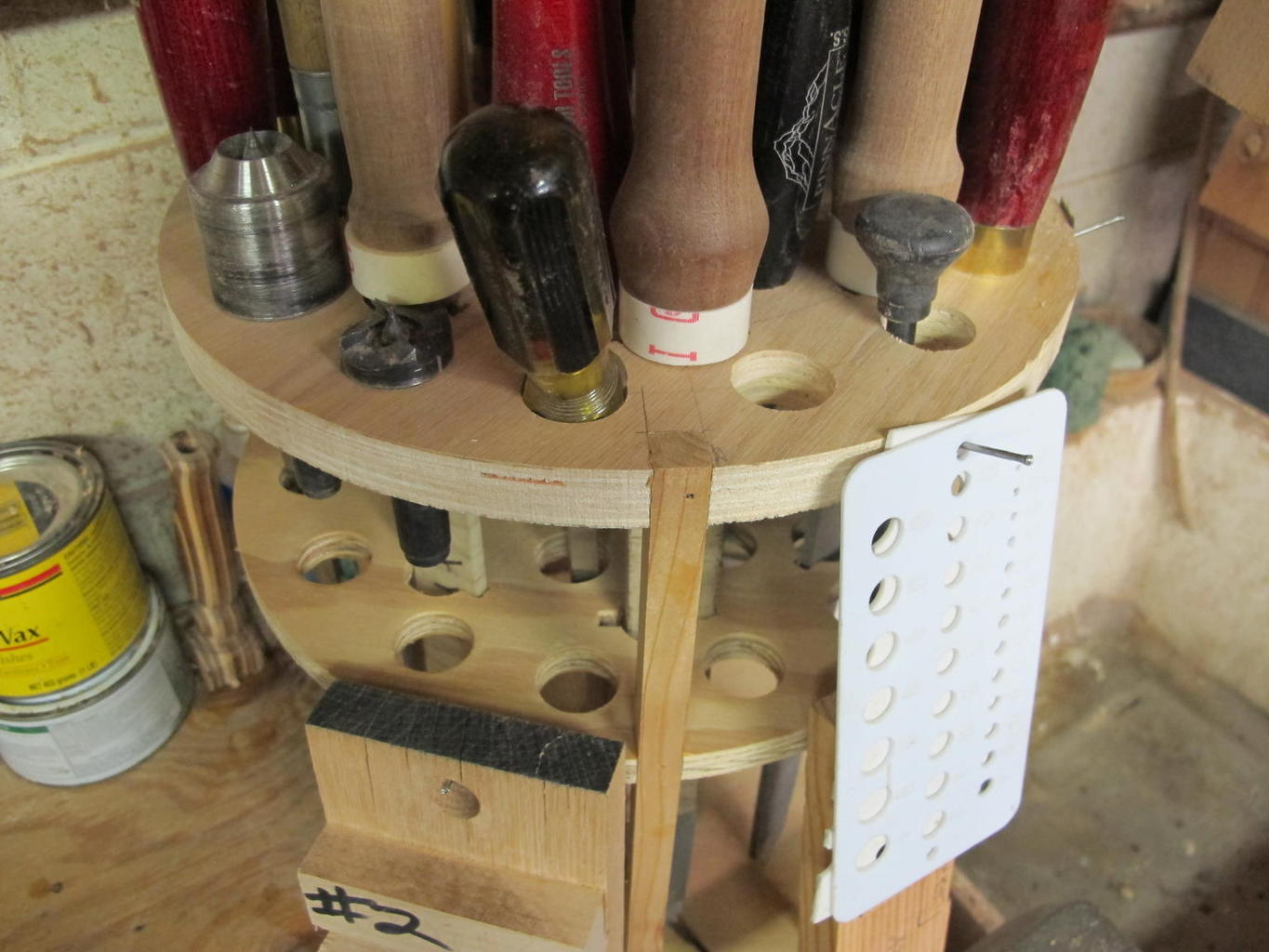

This pic is a little out of date as I have modified this with PVC to hold more tools.

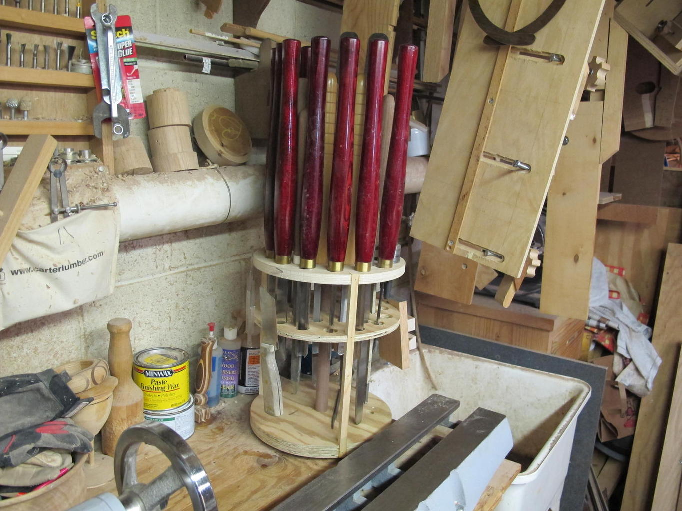

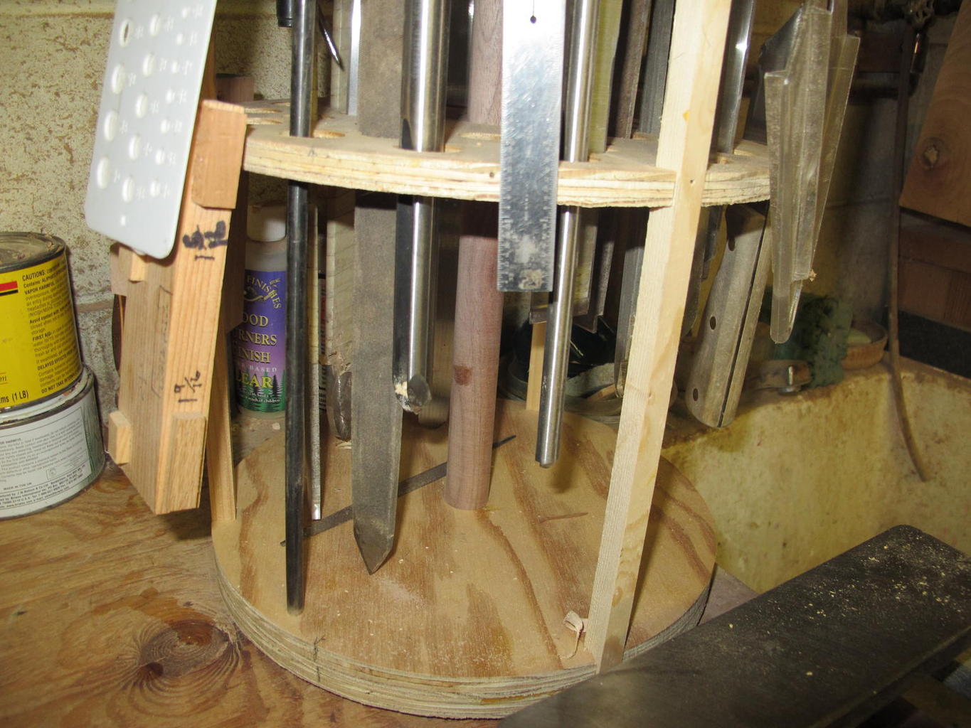

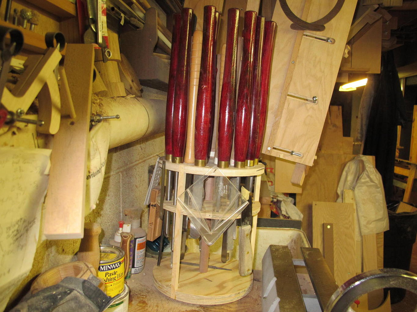

I made a carousel type holder. My lathe sets on a table type stand so there was a place to put the holder. I have seen pictures of these attached to the end of the lathe bed, using a bracket.
I used a recycled lazy susan bearing for the swivel.
This picture is quite old and most of the light colored handled tools have been replaced with Easy Wood Tools.

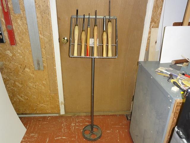

I have a straight rack on a wall that stores them in the same position as Lew's.  At the lathe I use this stand which I can move from lathe to lathe as which one I am using.
@lew and @Gerald, I might try a combination of both of your ideas.  I have a stand that serves as my sharpening station.  Grinder, Work Sharp, Drill Doctor, and other odds and ends.  I could put casters on it, a power strip, and add a couple of turntable racks on either side of the stand.  One would suffice for now, but that would leave room for more tools, never a bad thing, and balance the weight across the stand.
@HandyDan, thanks for the input.  That rack looks like it could also be a music stand.  Are you also a musician?
Nowhere near.  Tone deaf is a better description.  That is a shelf from an discarded refrigerator.  The idea was garnered from @Stick486.
