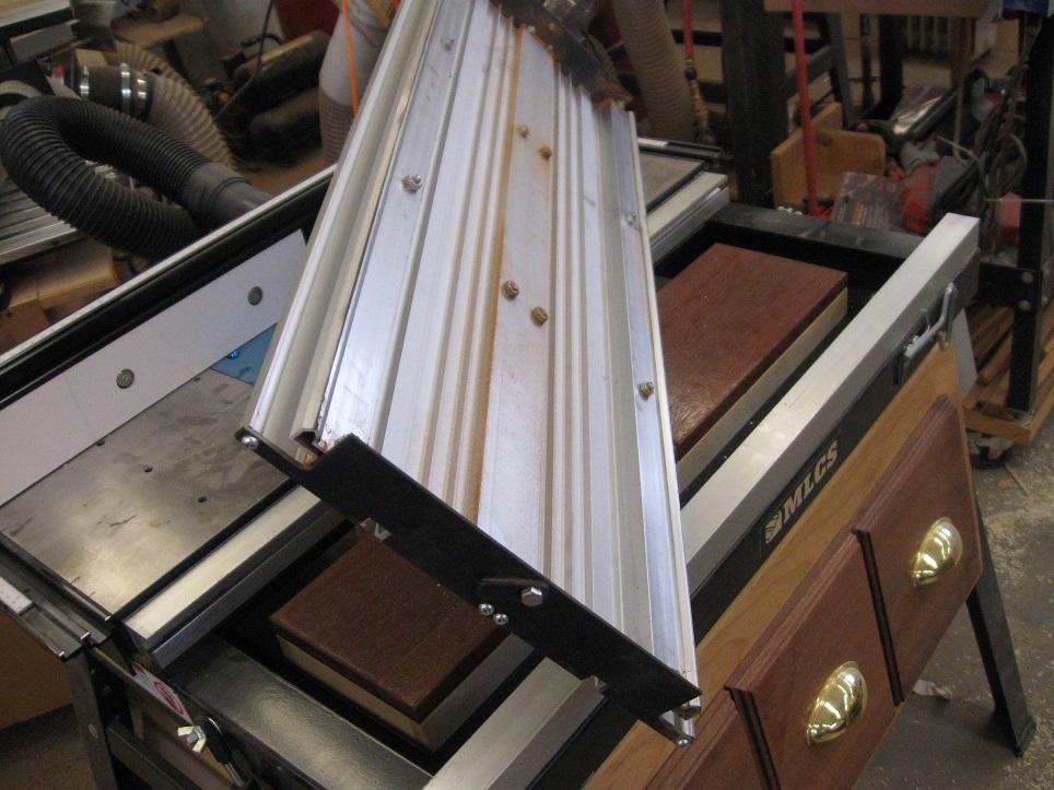

I have been working on upgrading my machine stands with drawers to store things associated with that machine. My latest is the Sliding router table stand.

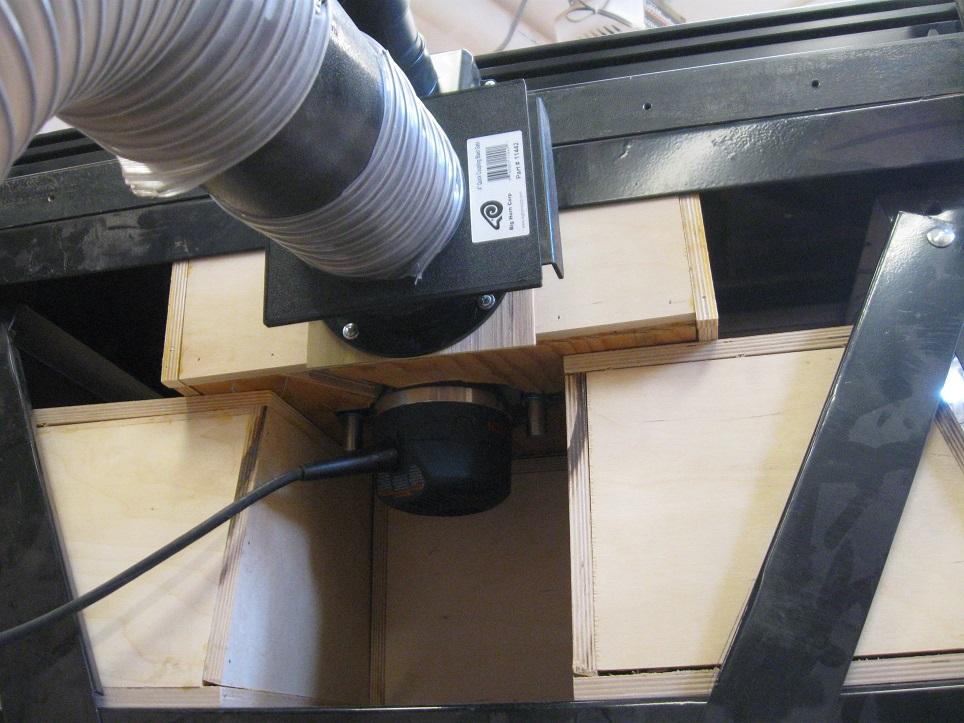

  • Here is the Dust Collectio hook up.
  • When I installed the DC system I didn't want to be tripping on flex hose all over the shop, so I built a 8X8 hollow column and ran a 6" PVC duct down into the top of the column. Then put some 6" and 4

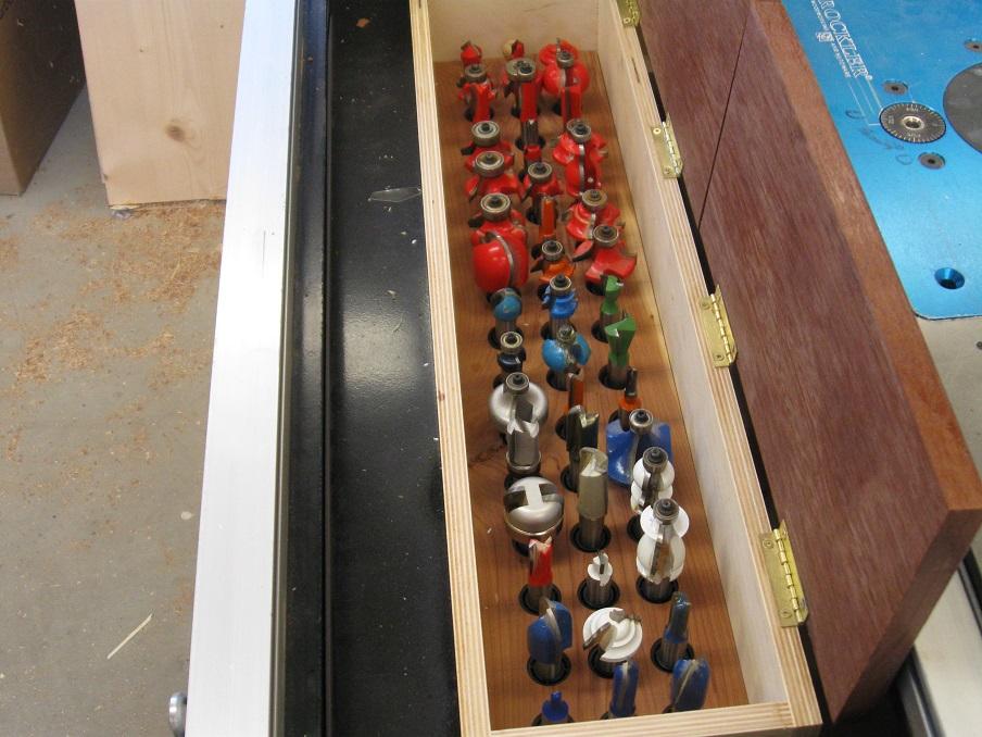

  • And the final pictures of the storage compartment.   Herb

When I installed the DC system I didn't want to be tripping on flex hose all over the shop, so I built a 8X8 hollow column and ran a 6" PVC duct down into the top of the column. Then put some 6" and 4" ports in the sides. That way I could bunch up the power tools on casters around the "Tree", and plug in the elec. and DC. When I use them I can either use them in place or wheel them out for more room

Great job on the upgrades, why did you cut out the bottom of the router box, to get in fresh air??
Pat, the way my DC is set up the fan sucks out of the top of the cyclone, the only dust it sees is in the air going to the filters, which is fine dust. anything heavy has already fallen out. Good observation though.
The router motor is sucking in air to cool the motor, if it is enclosed inside the box,two things occur, First is that it is sucking chips through the motor, and secoundly it is fighting the dust collector which is trying to pull air out of the box, thus cutting down airflow. The DC air flow out of the box keeps the chips from falling through the bottom (around the cut out) because air is being sucked into the box.
Herb

Udate: I received the plastic bushings and loaded up the tray with bits.
Herb
