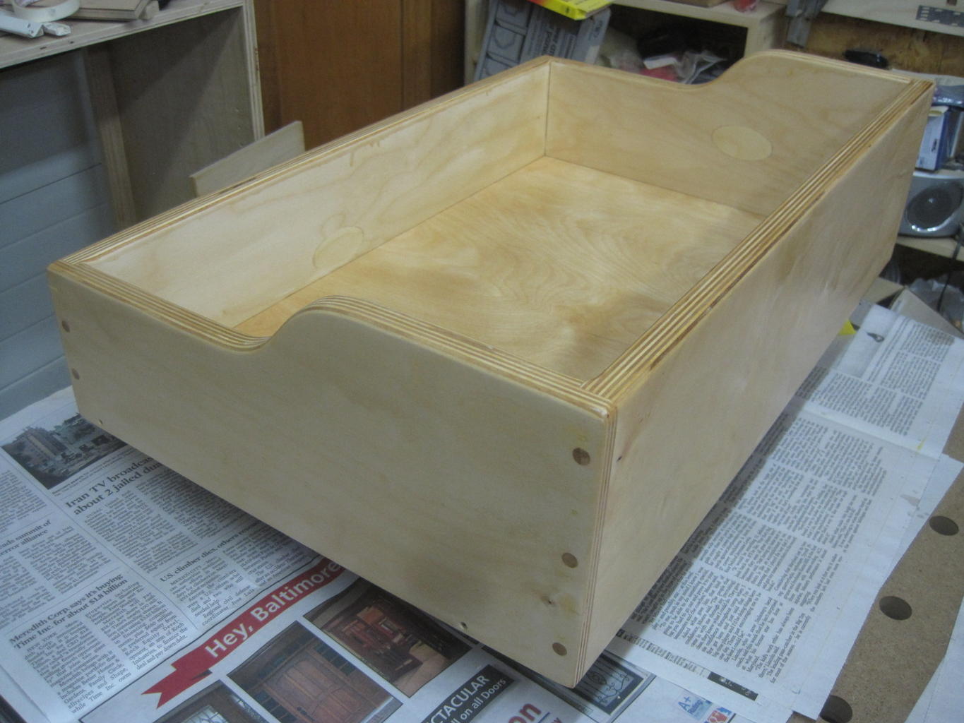

April 10, 20188 yr Popular Post comment_146220 Sounds more like he's cutting a rabbet on the front that's the depth of the side thickness and all but 1/8" of the front thickness - the side butts into the bottom of the rabbet and the nails go through the sides and into the front, parallel to the face of the front - any forces then are applied perpendicular to the axis of the nails. Just made a pull-out shelf for a bathroom utility cabinet, didn't want to used pocket screws as they would show so cut a shallow rabbet on the sides, glued and clamped and then drilled dowels across the joints. I also rabbeted the edges of the 1/2" plywood bottom to sit into 1/4" grooves in the sides and back/front. This is for my wife to store the shampoo, body wash, powder, etc. that she buys in bulk on sale so she's going to have a little weight there. Here's the shelf dry clamped so I can measure across the grooves and cut the bottom to the correct size. The drawer assembled and clamped, waiting for the glue to dry. After the finish has been applied, the dowel ends add a little decorative touch - although you can't see them when it's closed. Report
April 10, 20188 yr comment_146226 @tomp, nice sturdy drawer, there. The dowels may be hidden but, you know their there. Nice touch. Report
