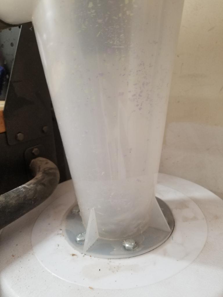

Hi all.  I hope you can provide a bit of advice.  I just started using Alumilite full time in my shop.  Love casting with it, love turning it, but my dust collection system hates it.  I have an Oneida Dust Deputy with its own dedicated shop vac.  Up until this point the system worked flawlessly, everything in the bucket and little into the shop vac itself.
I was going to build a shop vac silencing box last weekend and took the system apart to measure the shop vac.  I opened it up and was surprised to find it full of long, thin ribbons of Alumilite.  So I set the system back up and did some testing and found that the ribbons are so light they just spin at the top of the dust deputy and eventually find their way into the shop vac vice falling into the bucket.
Of course I did what any respectable tinkerer would do and attempted to fix it.  I found some screen door material and put it over the center suction of the dust deputy and voila! No more ribbons in the shop vac.  Now they gather on the mesh and clog the suction limiting the suction at the point of collection (lathe).  So now I have to stop every 5 minutes or so, stop the shop vac, smack the dust deputy (or worse, take it apart again) to clean it, then go back to work.
Am I the only one having issues like this?  Wood, acrylic, and everything else works as intended.  Alumilite seems to be so light and thin that it just goes right up the top suction and out  to the shop vac.

Joe, out of curiosity, do you have any pictures of what you have going on ? It might give us a better perspective of the size of shavings related to everything else.

Since you have found that screen material will stop the strips then my suggestion is to add a Y connection before any filtering apparatus. attach the screen at the angle of the y so that the strips will slide past the screen into the Y. Depending on the amount of material the strips represent, either add a cap (detachable) to the end of the Y or a short length of ducting with a cap (to provide a "pocket" for the strips to collect in. At the end of a turning session, empty the pocket.
Alright, pics uploaded.  First one is the setup.  Pretty simple, straight to the separator.  Next 2 show the unit in operation.  Notice how it all just bundles into a ball and sits in the DC.  Next one is the ball itself.  It is stuck to the mesh I installed.  Last 3 are more operational pics.

Joe, thankyou for the pictures. What are you using for a vacuum ? Also I can't tell how much of a bend that you have in the vac hose coming out the top of the cyclone and going to the vac. Oneida makes a Dust Deputy made of steel, I wonder if it would be less susceptible to static electricity if it was mounted to a steel pail, and grounded.
