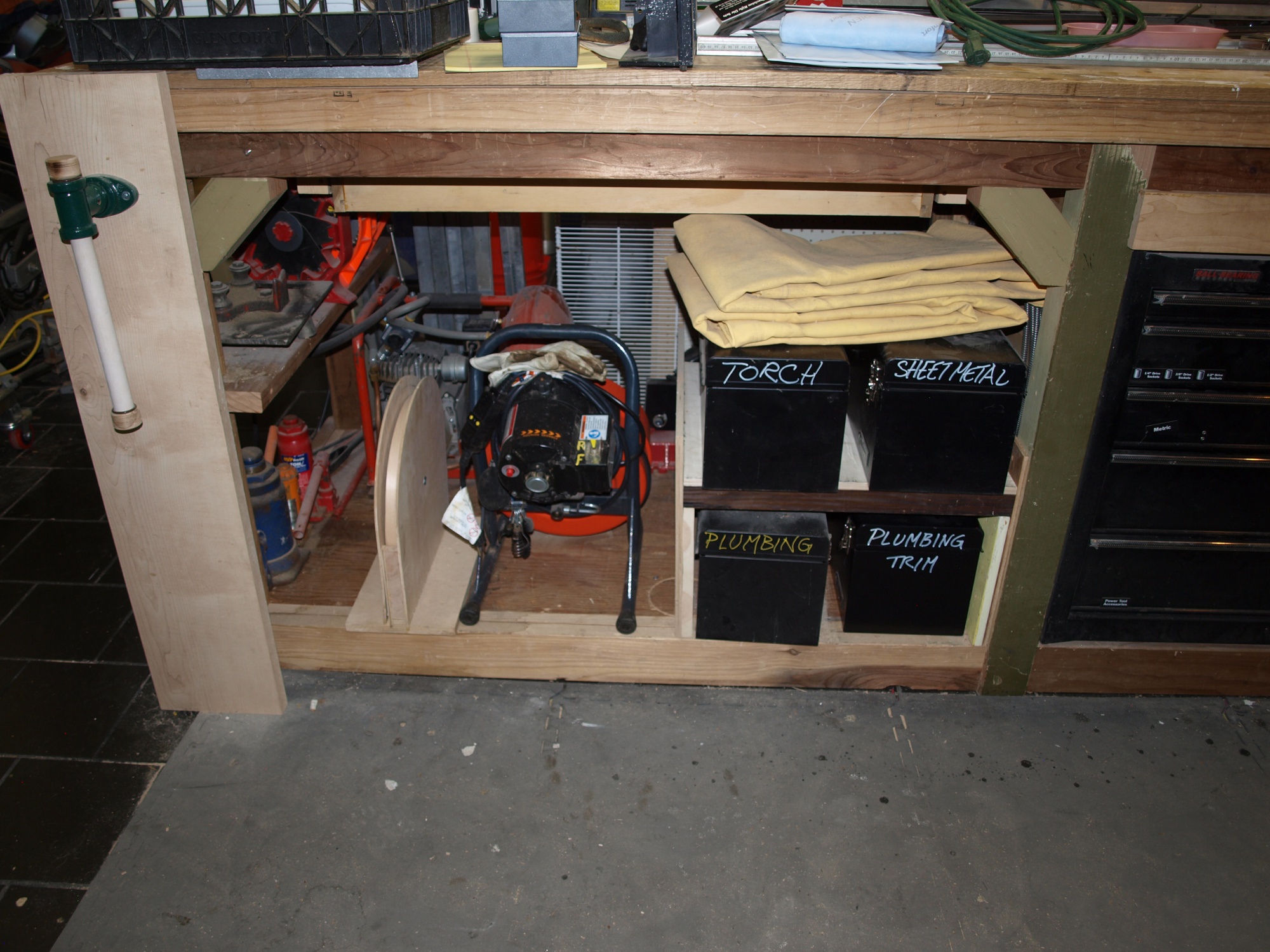

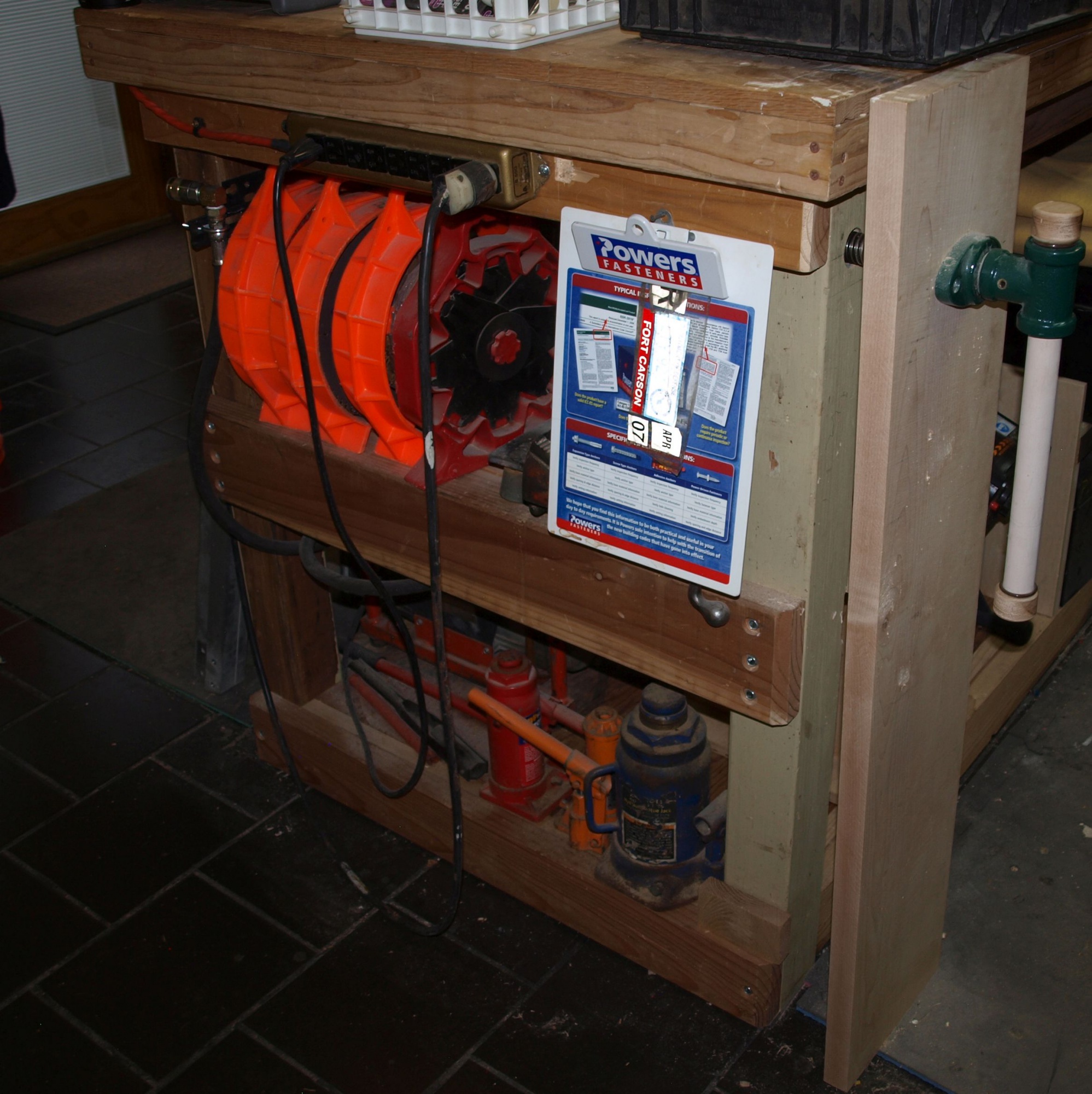

the dumpster will yield legs, aprons, framing, drawers, top. vises, braces, handles and much more after glue up of the pieces...
dumpster dove table..  102x52''..
I got maybe 10~20$ in it...
glides are from salvaged kitchen cabinet hardware...

@Stick486, how do you like the leg vise? Just looking at options, never even saw one before. What secures the lower end?

how do you like the leg vise  ....
I like it a lot...
great for long boards and large panels/doors/etc...
I have a clamp on bracket that clamps to the edge of the table to support long materials when the are in the vise......
there is also an end vise...
it's self...
or a spacer...
or a scissors jack...
all pictured in the end view...
