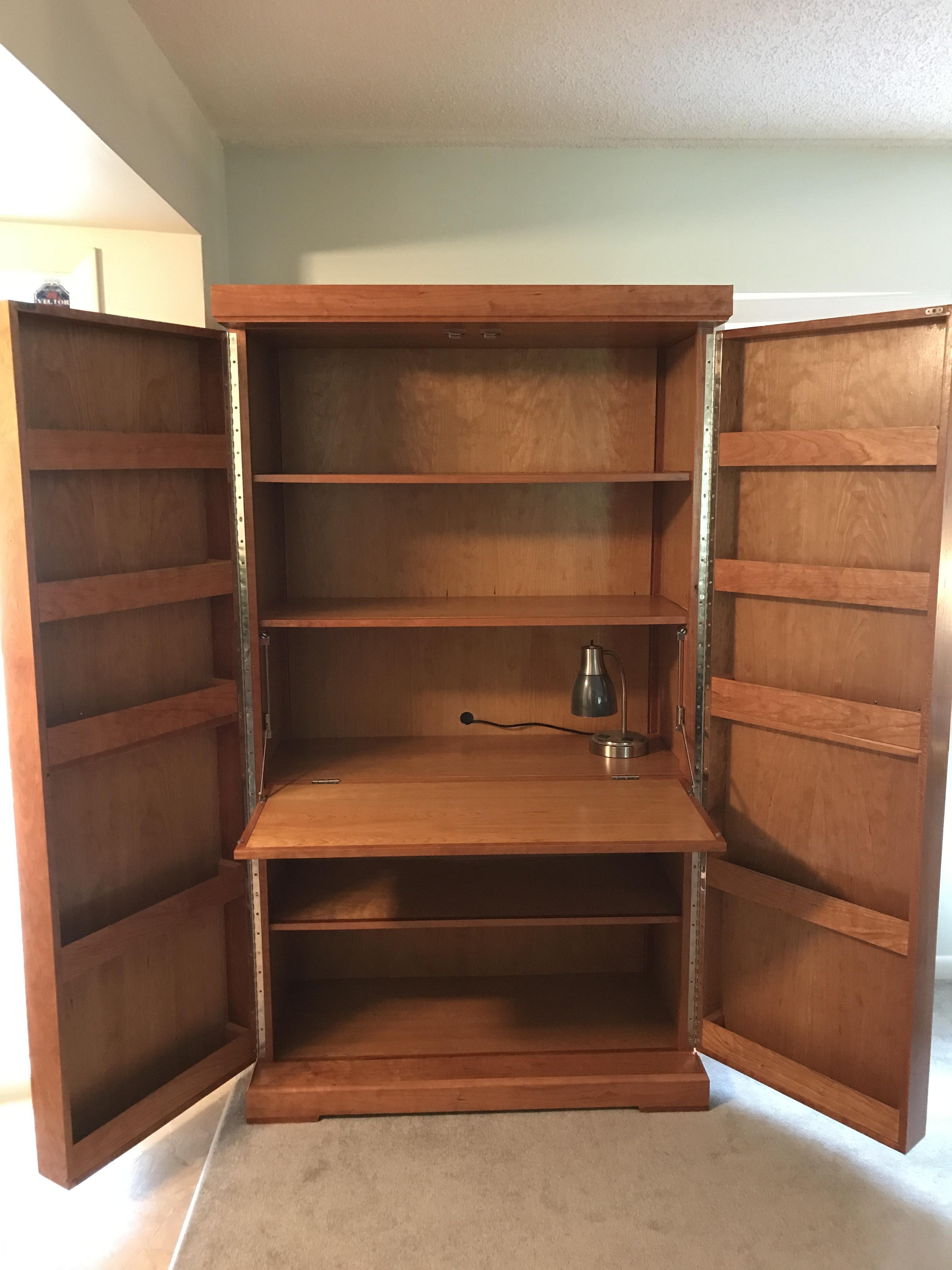

  • I'm building it now.     Girlfriend says it'll work fine for her.  We discussed the leaf depth.  She does only hobby projects, so she sees no problem with the dimensions.    I agree this pro
  • Cabinet doors are finally done.  Unfortunately Irma decided to visit and flood my shop 7" wall to wall.   Took a while to get cleaned up and back into production.     Overall the doors came

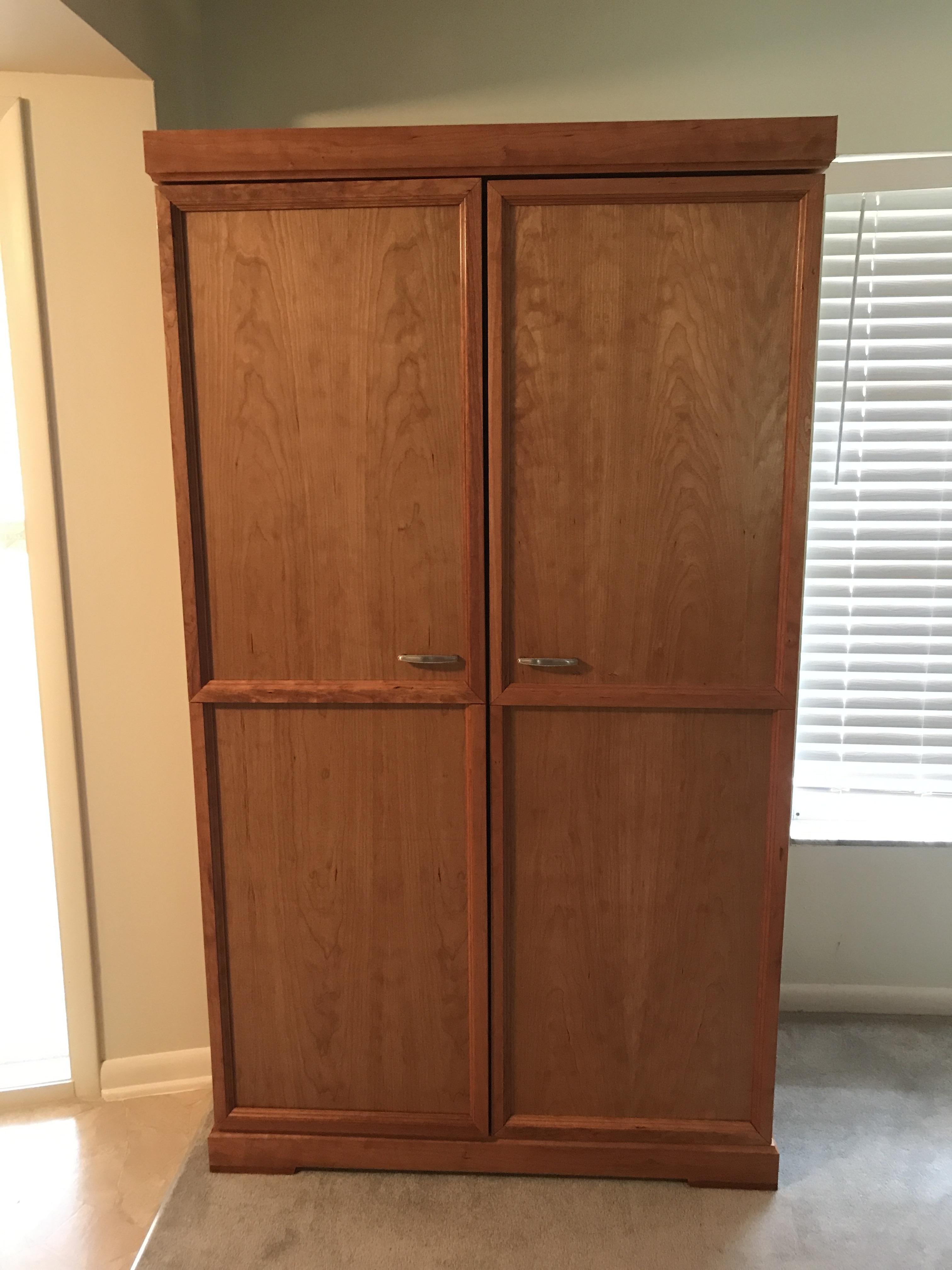

All done!
door alignment isn't as good as I wanted it.  Dealing with six-foot piano hinges and heavy doors proved an enormous challenge.  Took three people to get the doors hung.
Overall im happy with it.  Came out pretty sharp and the girlfriend loves it!
Very nice.
6" piano hinges would be a chore but, you pulled it off. Good job.
Looks good . If the top gap really gives you a problem you could plane a little off the left door top and no one will notice theinner part of the trim not matching height
That really looks nice Joe,
Cal
Thanks all!
