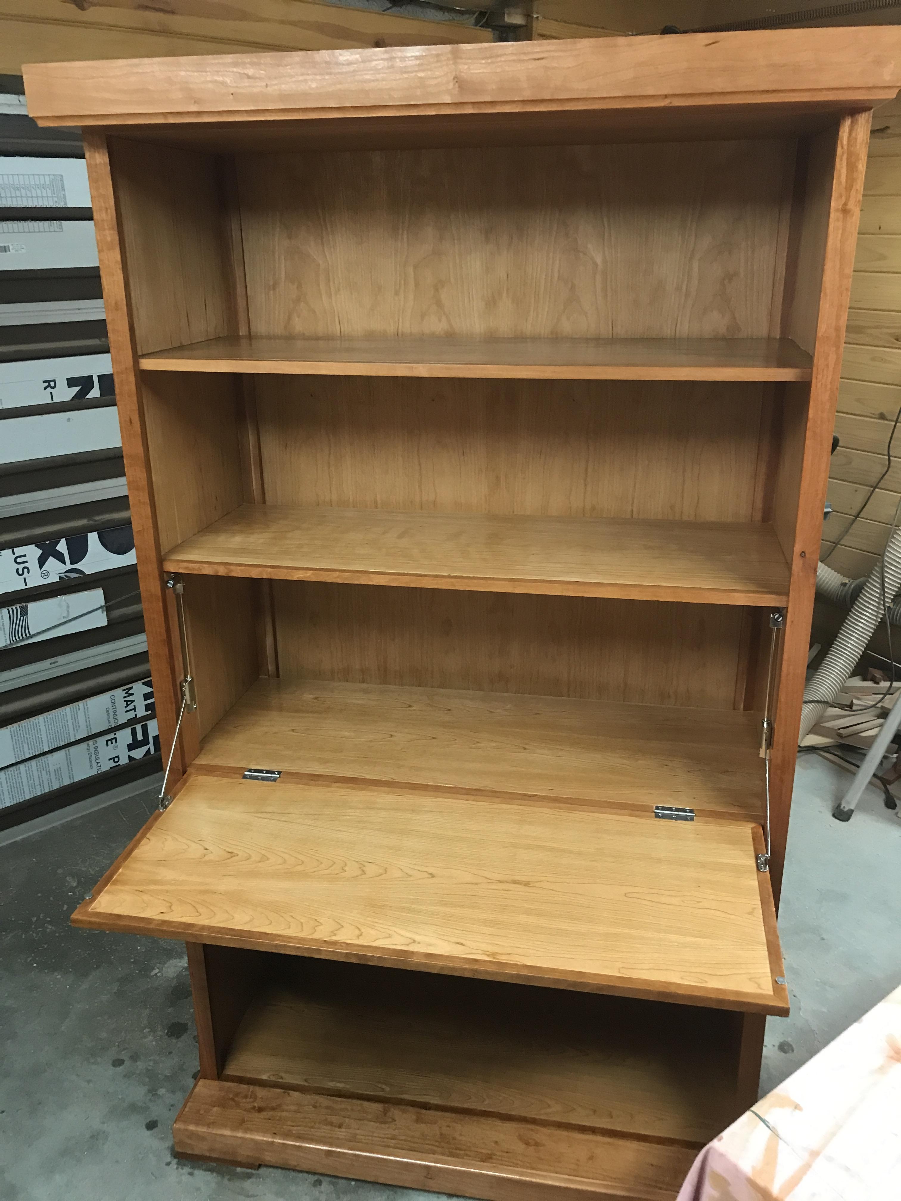

I'm building it now.
Girlfriend says it'll work fine for her.  We discussed the leaf depth.  She does only hobby projects, so she sees no problem with the dimensions.    I agree this probably isn't the best design for a serious seamstress making dresses and such.
I didn't like the pine look either, so I opted for Cherry with Cherry veneer plywood.
Cabinet is done.  Working on doors now.

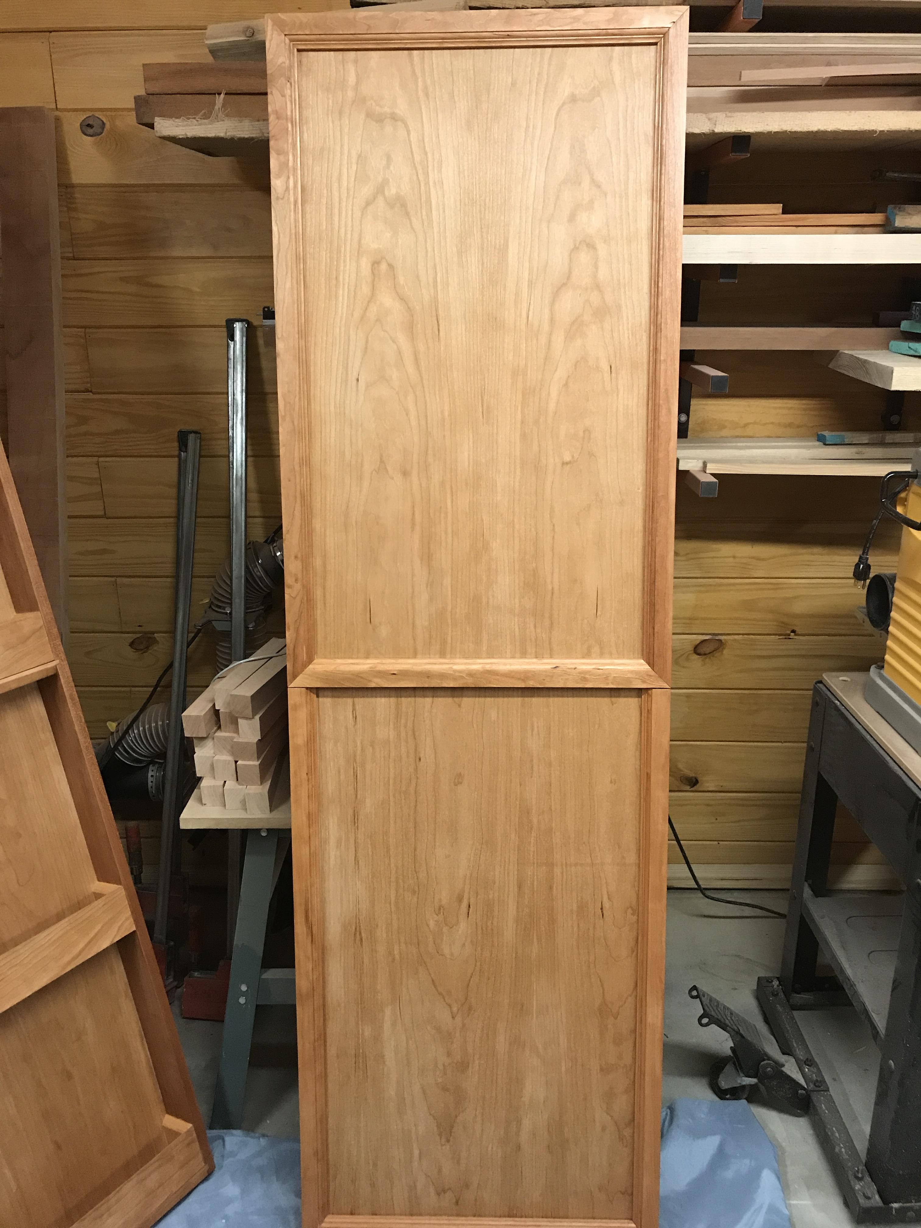

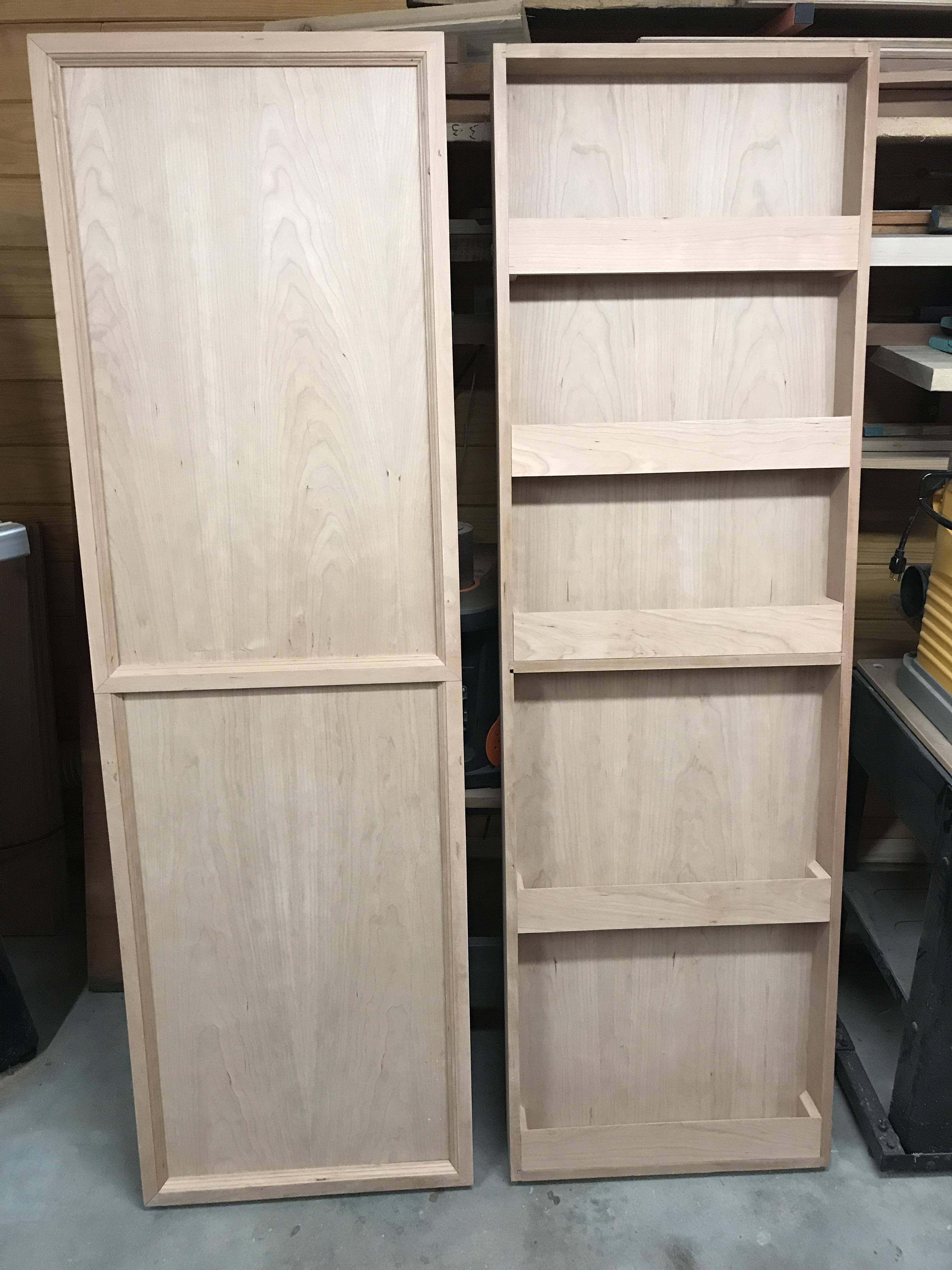

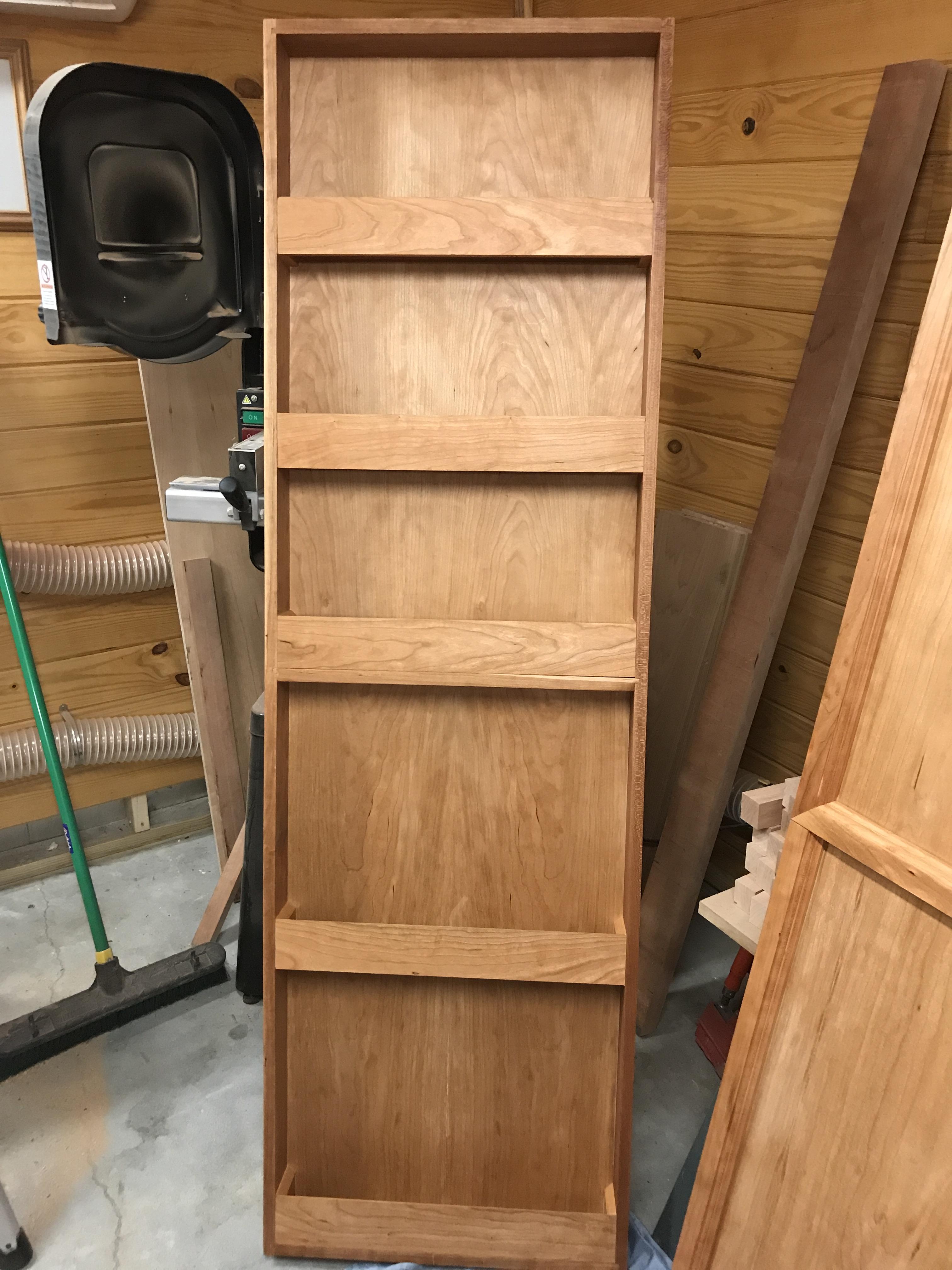

Cabinet doors are finally done.  Unfortunately Irma decided to visit and flood my shop 7" wall to wall.   Took a while to get cleaned up and back into production.
Overall the doors came out out the way I wanted.   I didn't like how the plans added molding to the inside edges of the door face.   That does nothing to cover the dado joints used to hold the door frame itself together.
So I went off-script, bought a fancy molding router bit and made my own molding that overlaps the cabinet frame edges.  Nice decorative edge and it covers the unsightly joinery that results from a $500 table saw.    Turned out pretty good I thought.
Here are before/after photos of the cabinet doors.  Once the polyurethane coats are applied, I get to figure out how to install six-foot piano hinges.....
