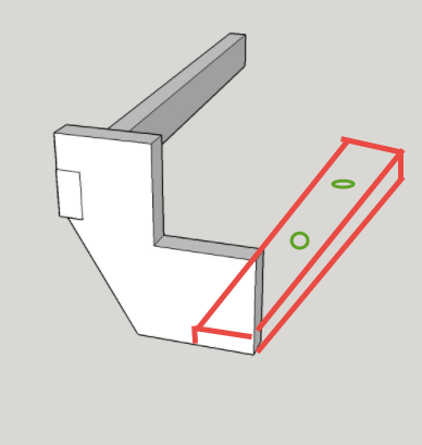

    The other thing I have always done on the front of the stringers away from the wall. Add a recessed peice where you can put fasteners down between the stringers.  That way if they want to spread away

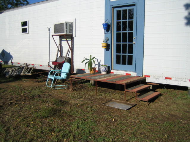

Back in 1986 I ordered some recycled plastic 2x6's from a place in Ohio. Only place at the time I could find it.
Freight was about what the 2x6's cost but to this day they are still looking like the day I installed them. I  used them for all the seating areas on a mini golf course  in the hot sun of west Texas... I had some left and used them on the porch of wifes glass shop here where we live now and they still look like new.
   I put the support under them at 16" centers and before I secured them I realized I should add boards in the middle of the 16. Sagging is the only fault to consider.5a1d62c9a9bfe_storagetrailer003.JPG.e1c8b63b3d27675be8eb4f34bbf6cf40.JPG
   I had these for 30 plus years before I finally found a use for the last bunch I ordered in 1986. Most of the time they were laying on a concrete driveway in the sun.

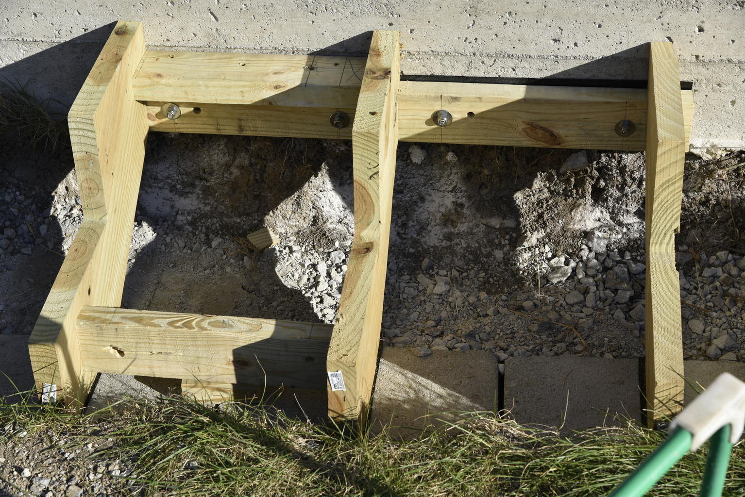

Fred that white pine should be water proofed or use treated pine.
At the foot it looks like it is below grade.
What is the foot anchored too?
I normally use a stringer across the bottom the holds everything square.

Michael, It's all treated and the foot is below grade. They aren't attached to anything at the bottom, the stringers sit on 4" cap blocks. The entire pit was filled with limestone just before I put the stair treads on it. I put the stretchers across the stringers based on your suggestion, but there was anything under the foot (except those 3 cap blocks) to anchor to.

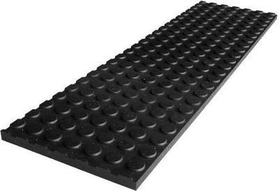

Hey Fred, saw THIS in the Menards sale circular today....might be something to consider for your step treads...
I'll try to check that out when I'm in Menards later this week. I wish I had thought of Buk's idea about making the steps wider. The stringer could have made the top one 1/5" wider, and then I could have put a wider tread on the bottom one, oh well, too late now.
