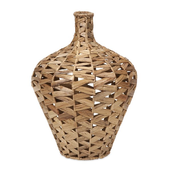

Steve Krumanaker Posted July 28, 2017 Author Report Posted July 28, 2017 Thanks everyone, I appreciate all the comments. On 7/26/2017 at 9:22 PM, Gerald said: Wow. Looks like a rattan platter. How thin is it? Hi Gerald. It's about 1/8" thick. It's patterned after a Polynesian style vessel. According to what I read, the weave is normally done with water hyacinth reed and the splines are metal. Steve Grandpadave52, Cal and Gerald 3 Quote
