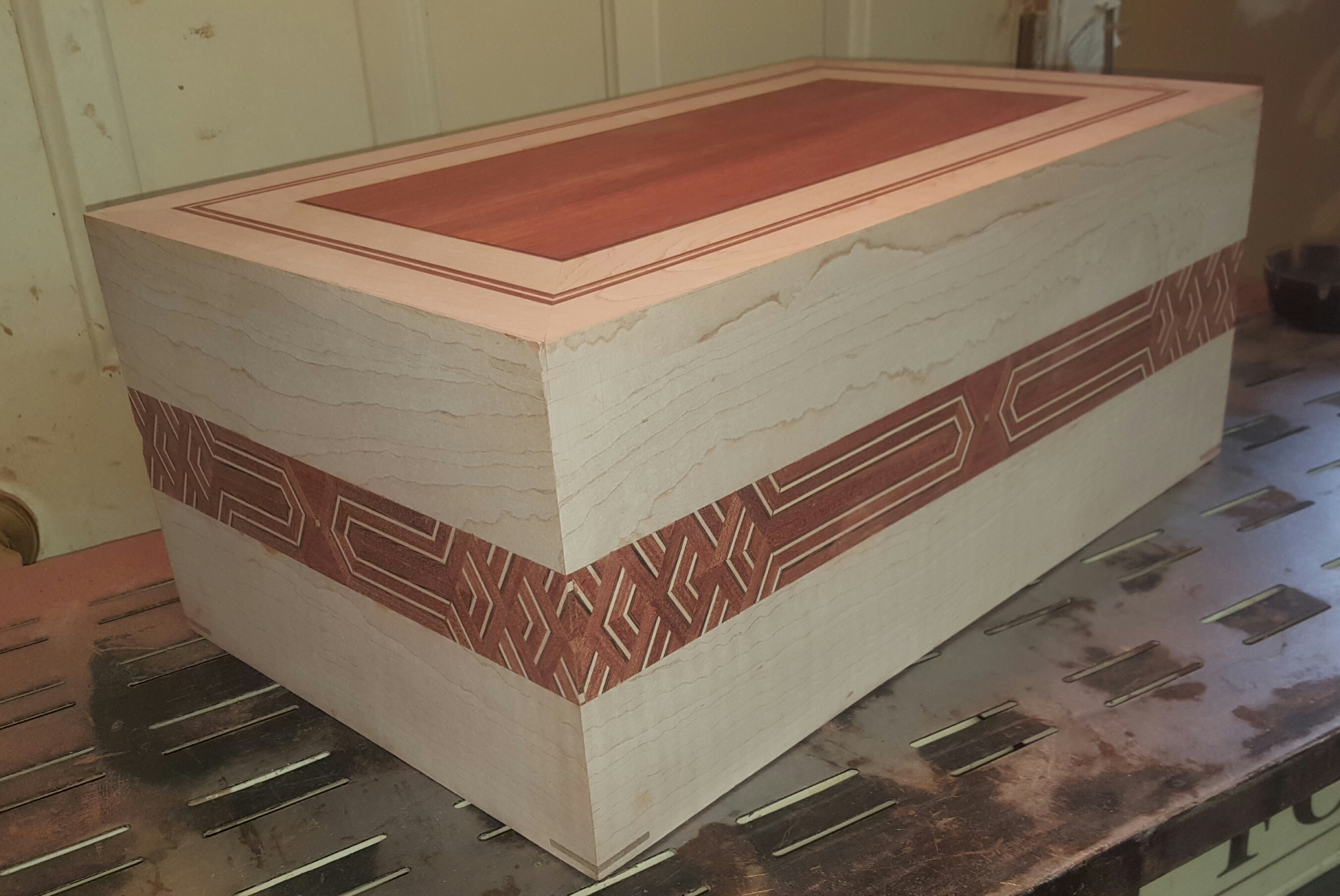

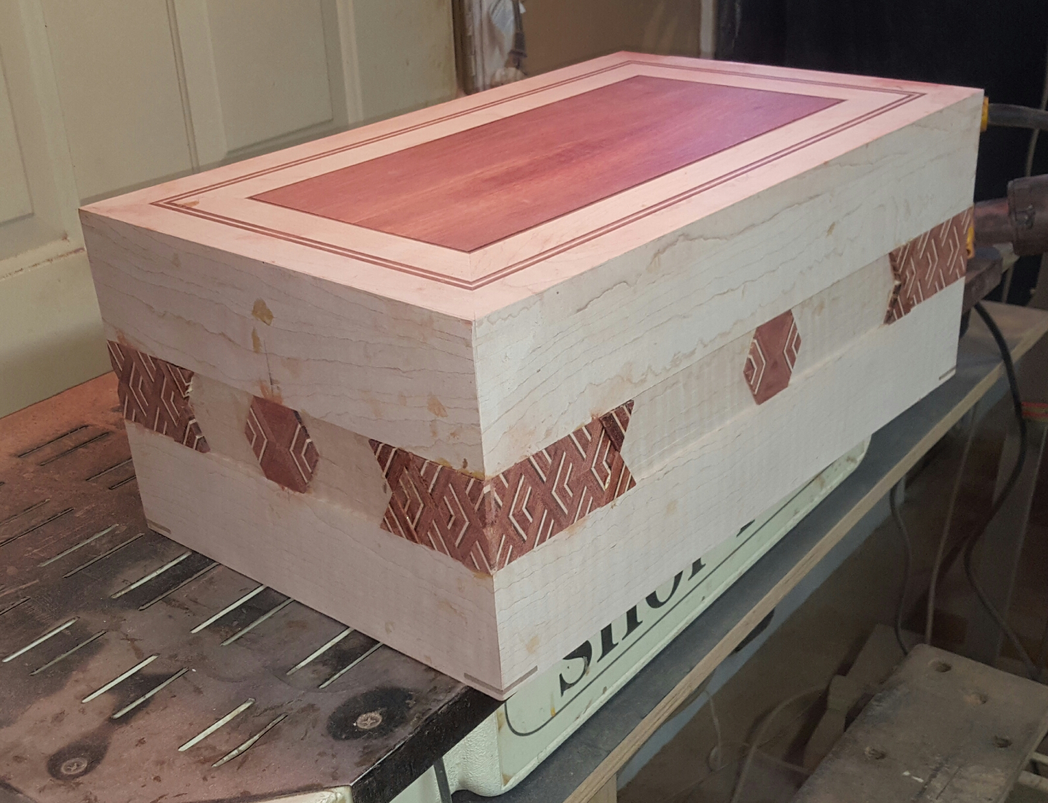

She's coming along....  I'll let these dry overnight and finish up the cosmetics tomorrow.

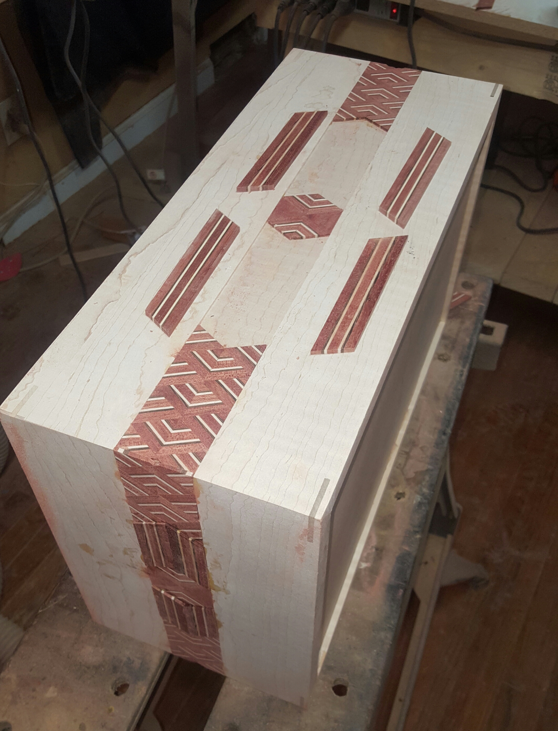

So.. I'll wait a bit and start sanding, again.
That's one dandy sander, you got there.:D

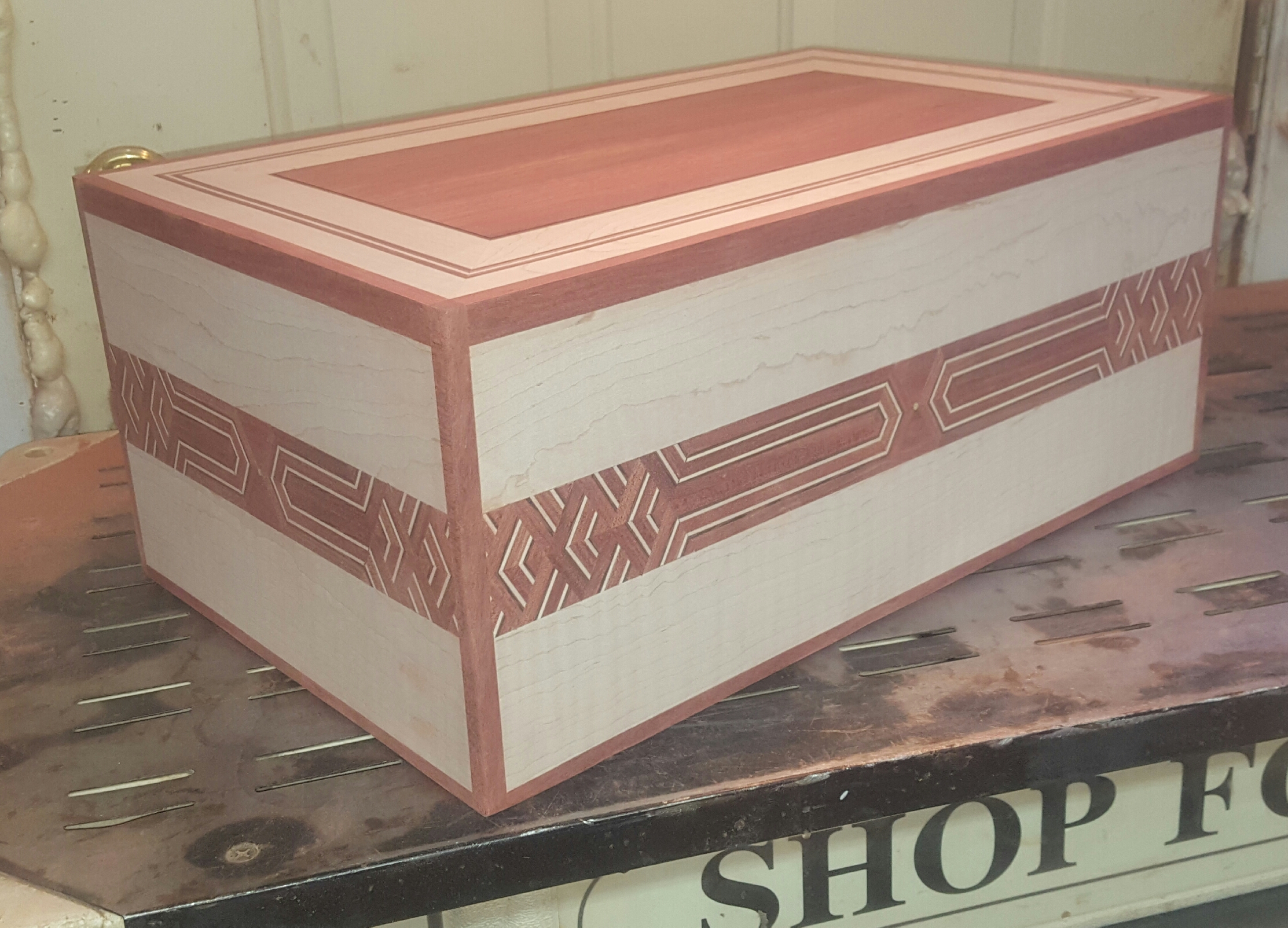

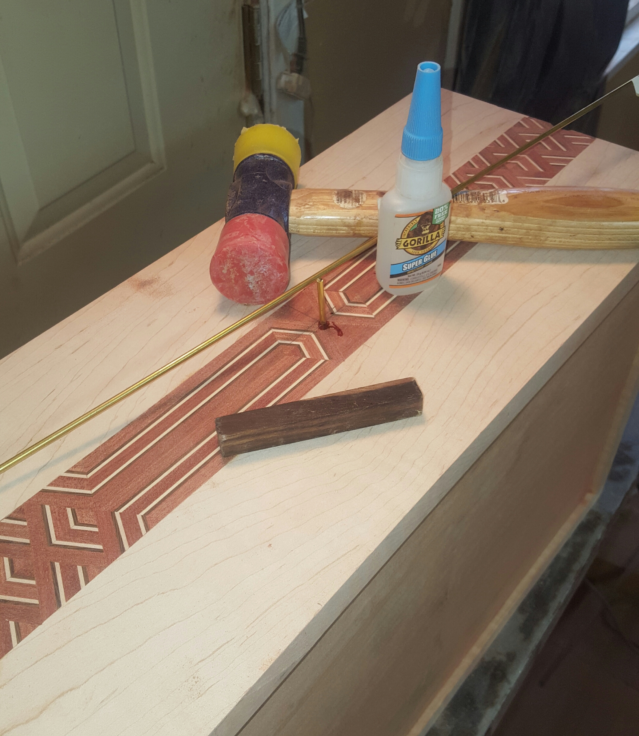

Just for fun.....

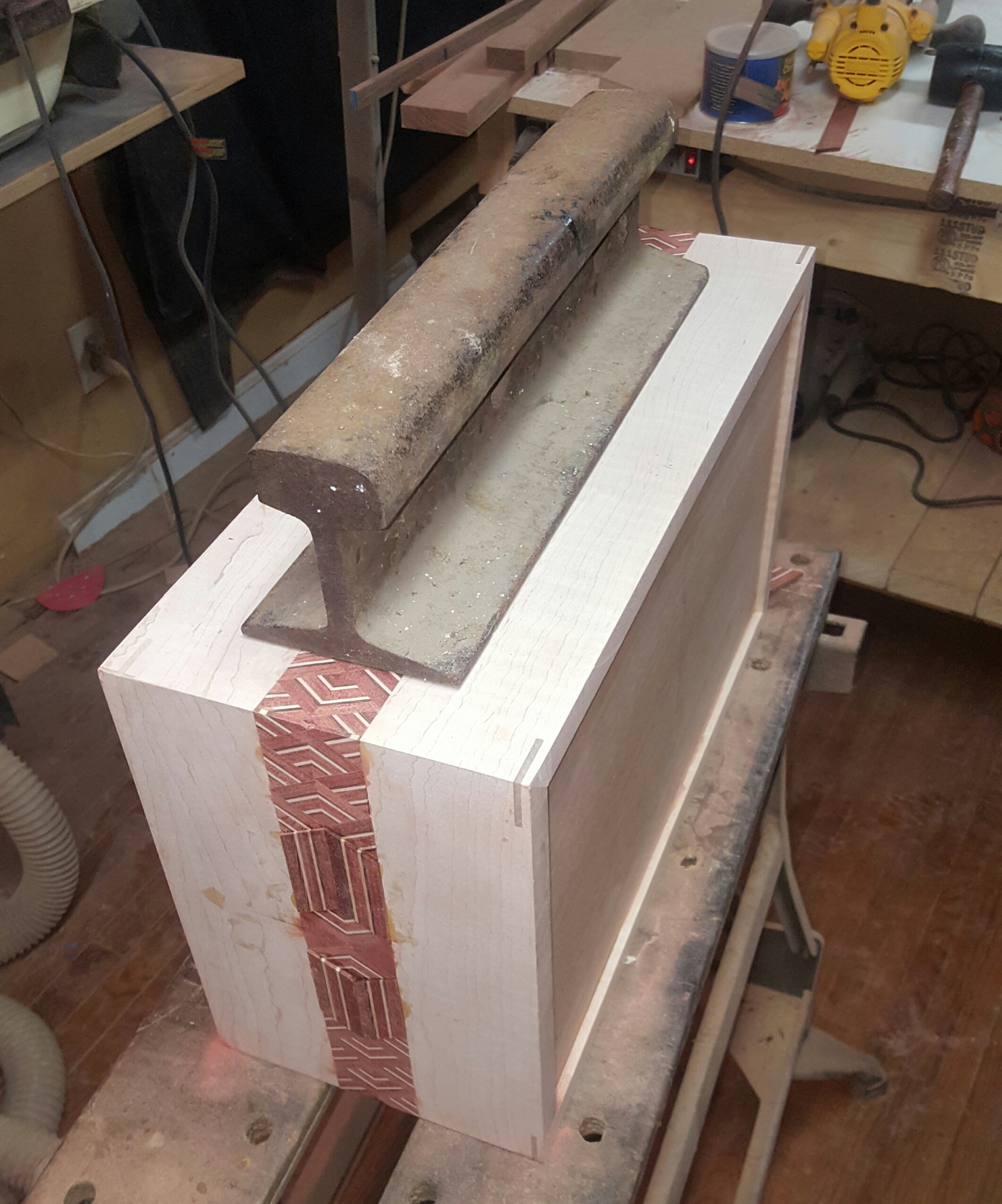

You glued it in and THEN cut it? How did you do that without marring the inlay?
I used my bandsaw.... cut close then sanded.  Brass is non-ferrous, so no problem.

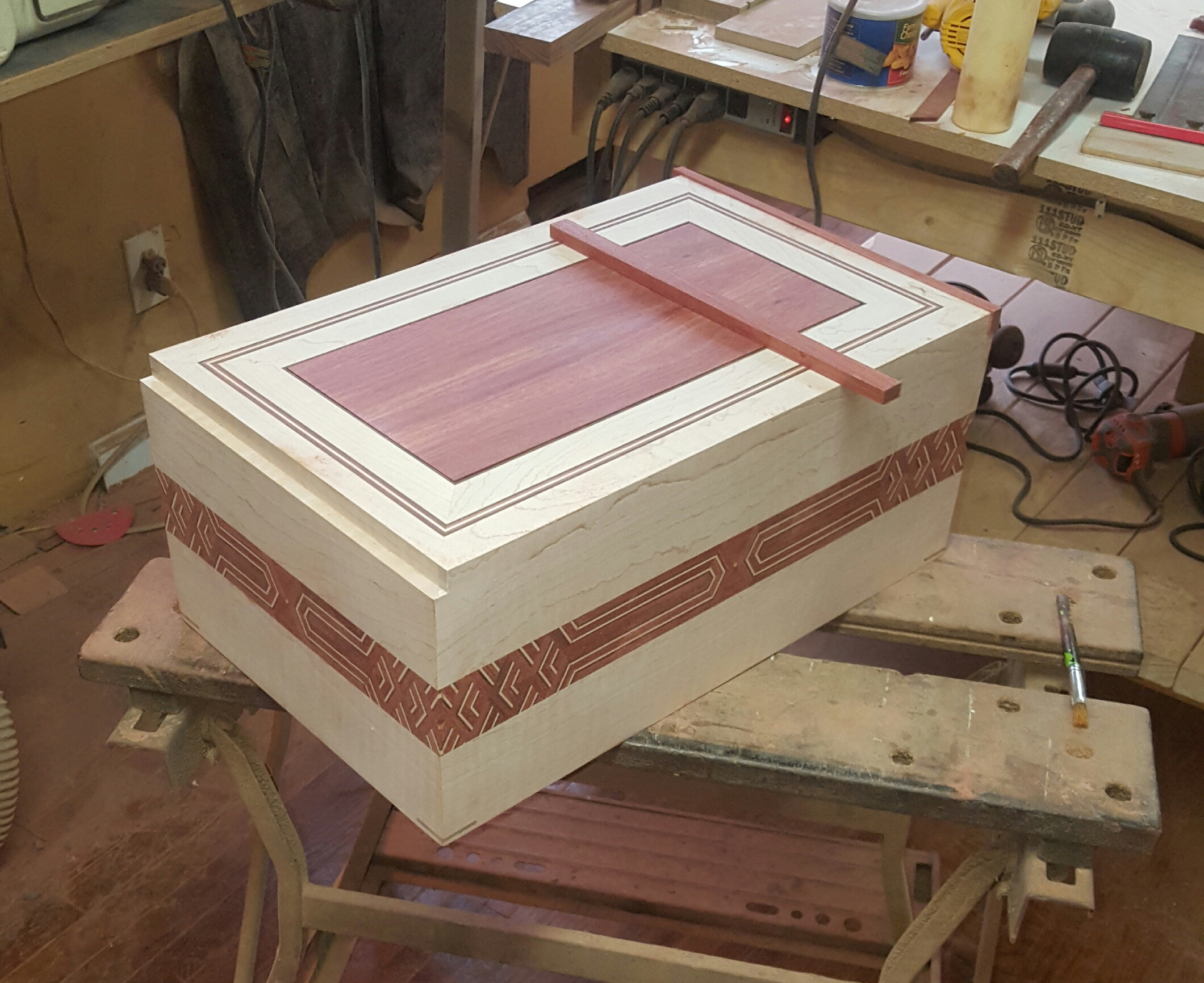

I cut a 5/8 * 3/8 rabbet on the top edges because I am going to put a cove on the top with the intent of garnering 3/8 to match the rest.   the rest of the rabbets  are 3/8 *3/8.....
Done for today....  Tomorrow, she'll get a coved top on the tablesaw...
