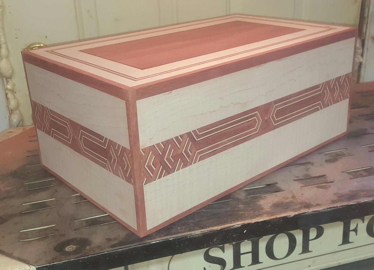

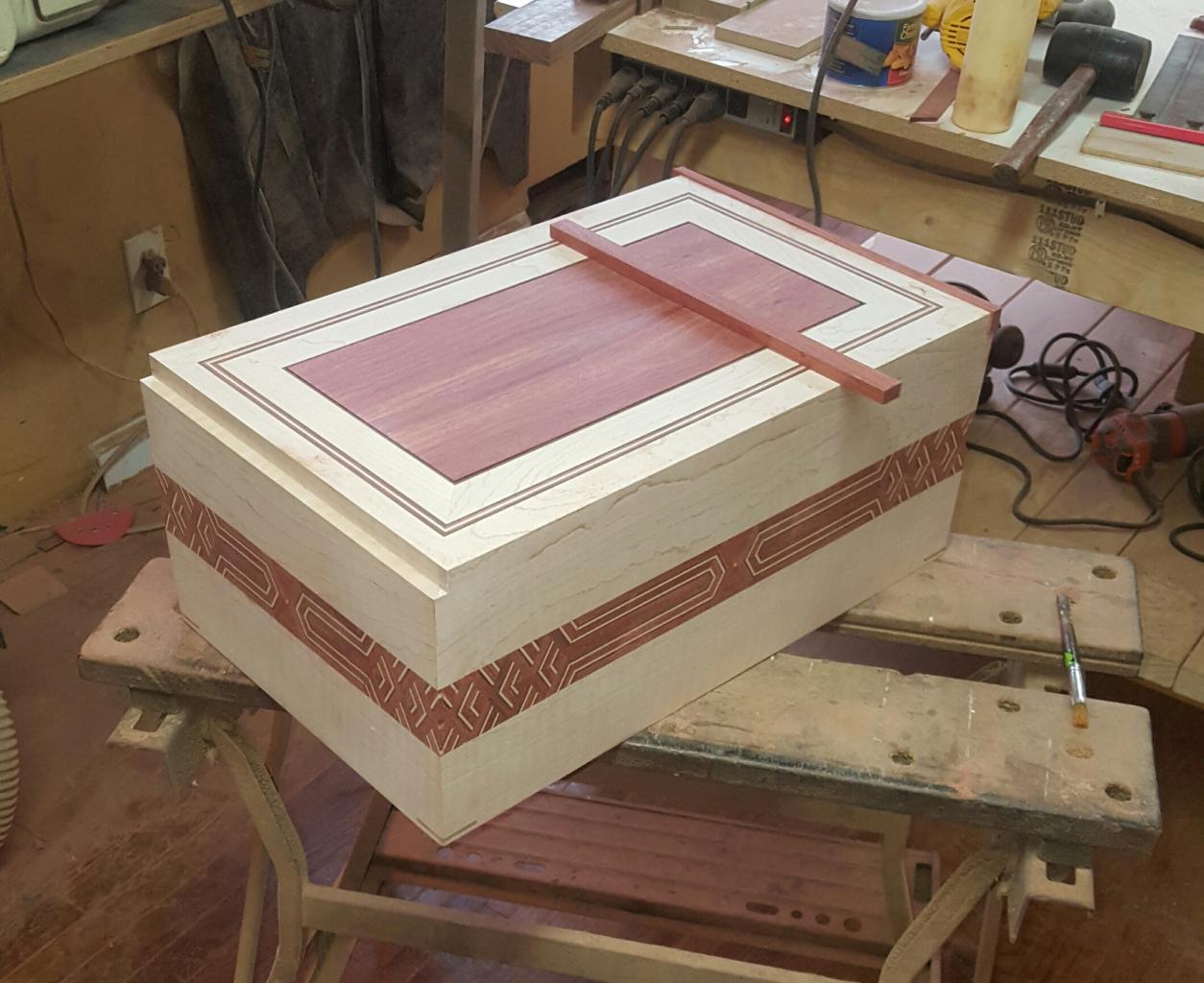

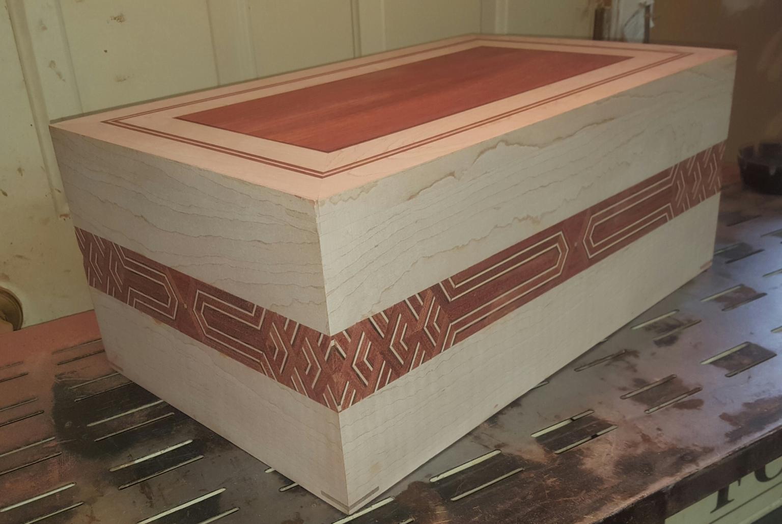

I'm in the process of making some decorative inlay for a box..... but, I would imagine this could be put on anything if one so desired....
I used three pieces of 1/4" thick bloodwood, and two pieces each of 1/16" thick maple and wenge to make the 1" thick laminate....once dried and cleaned up, I sliced off from the edge several strips about 5/32" thick.... you can cut as thick as you like, just make your jig and dado work with that dimension...  then cut a 30 degree slice off the end of each strip using your miter gauge.
I cobbled together a jig to cut 4 triangles at one time....  flipping the strips after each pass.....
Once you have enough triangles.... have some fun!

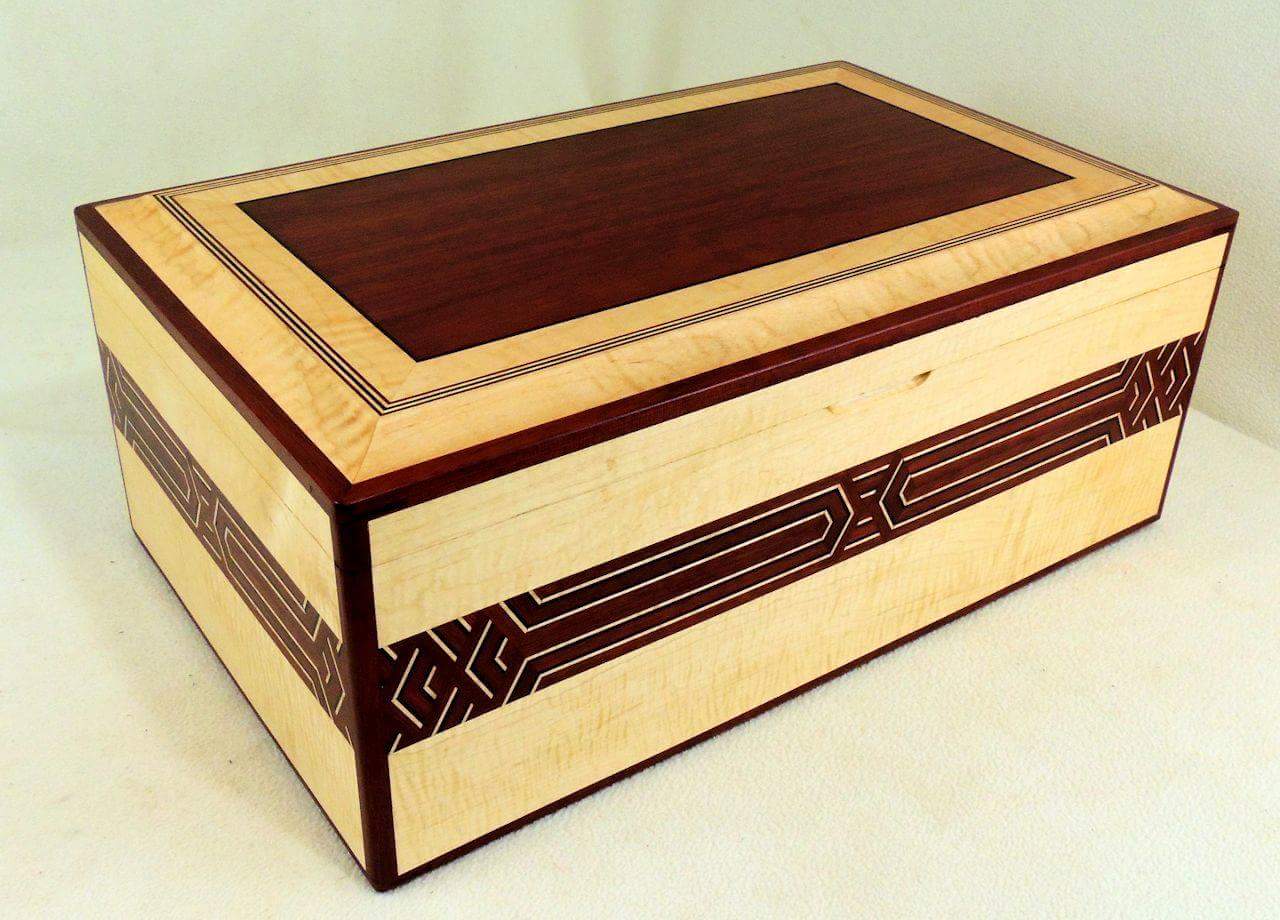

This is a picture of one I did last year...
Ed, your creative genius never ceases to amaze me! Awesome.....
That's just awesomely beautiful. Wonderful work.
Ed, that is beautiful and absolutely flawless..Whoever received that box is one lucky individual.
