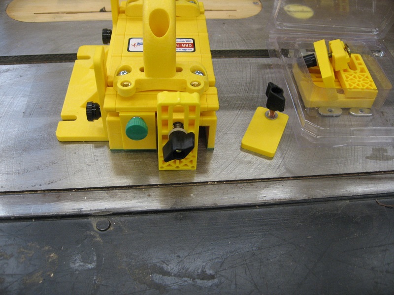

Thanks ,all good suggestions. I am definitely going to look into getting a Gripper, they just look so big and awkward that I have not been interested in them. But everyone who has one seems to like them, never heard a negative comment on them.

Like any new tool, the Grrriper takes some getting used to. But, its worth it.

Well yesterday I did order two grippers off Amazon, and will watch some videos on the different set-ups so I can set them properly and will give them a try. I have not heard any negative comments on the gripper. So based on all you woodworkers good responses I will try them.

Good deal Herb...I considered a pair of them a few months back but didn't purchase at the time. After your mis-hap, certainly going to reconsider.
