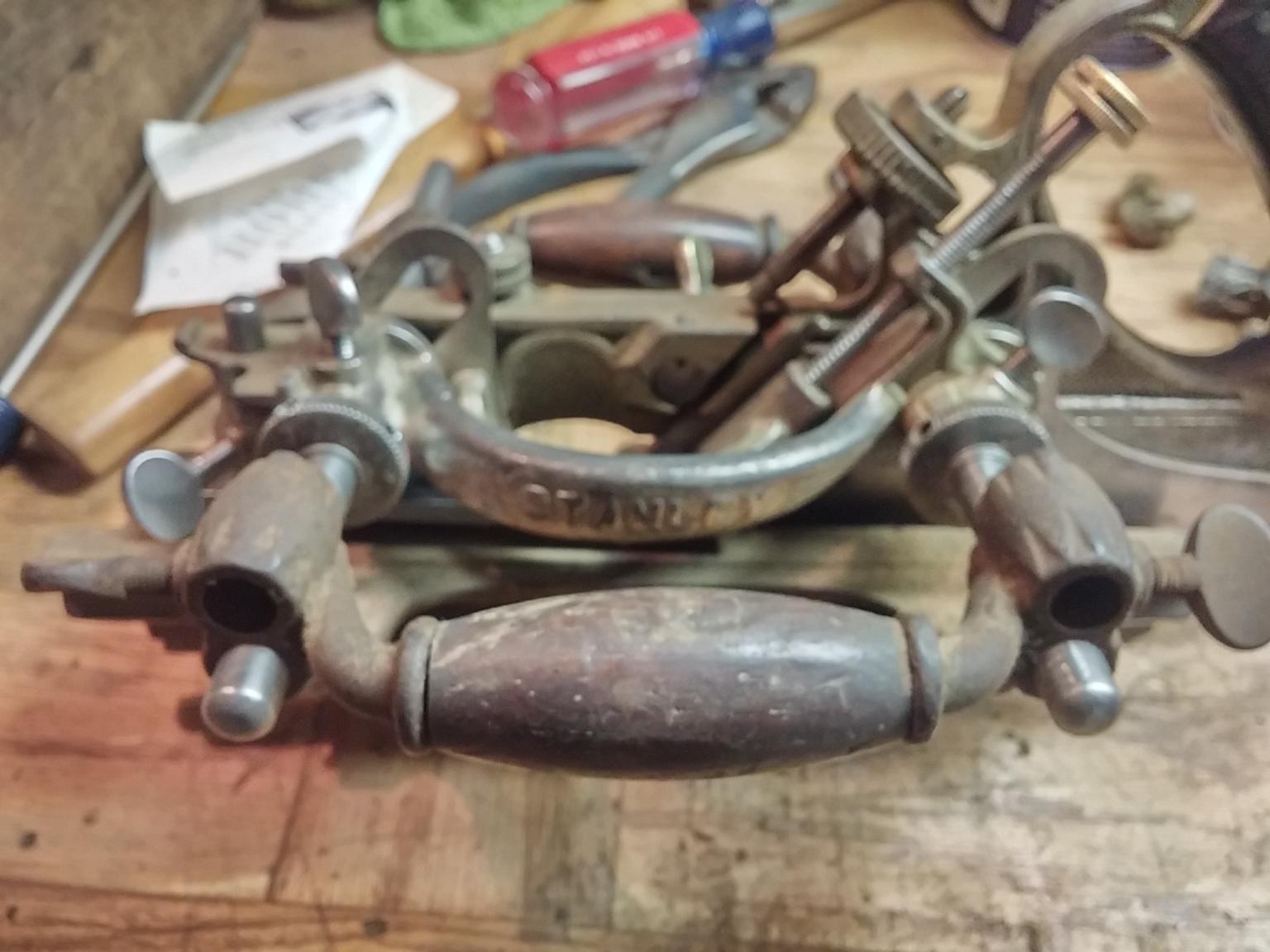

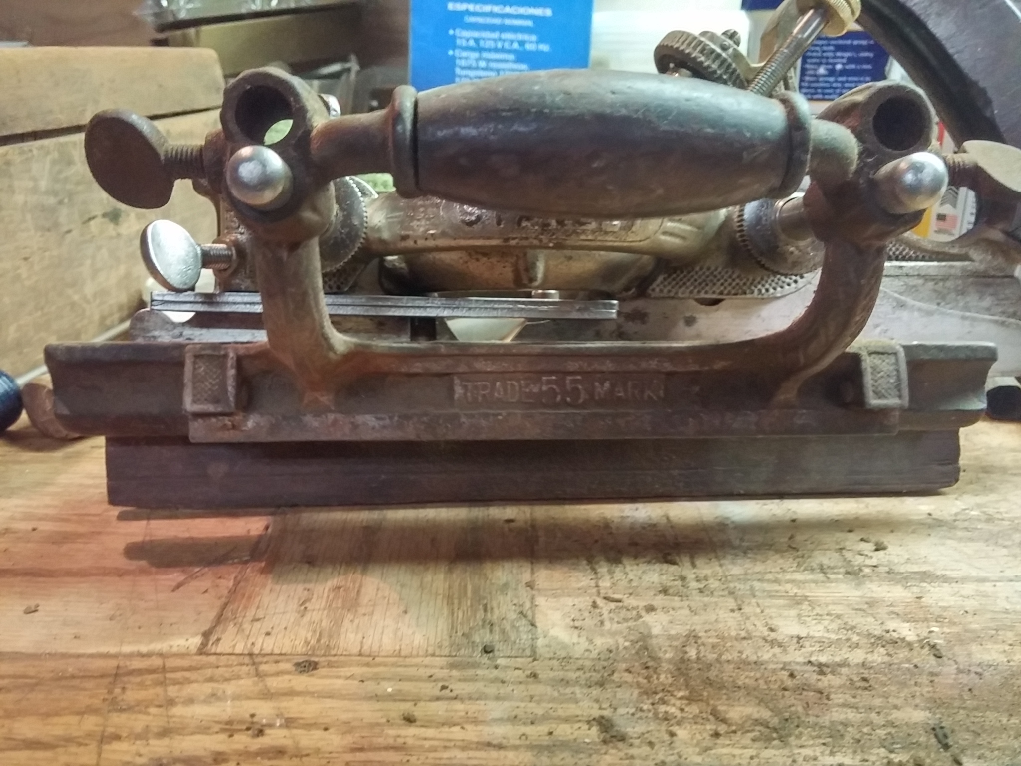

  • Thanks, Steve and John...that all makes sense...   Some pics...maybe some help dating it...?   BTW...no...it's not finished cleaning yet...I reassemble it every time so I don't los

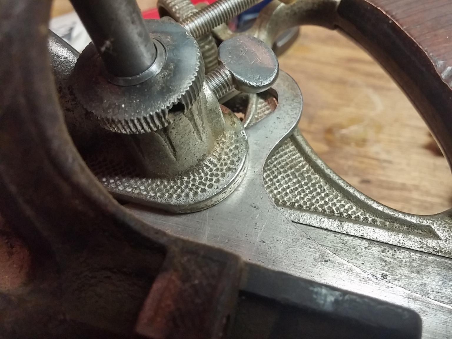

Question...it seems the body is made of brass...except as I continue the scrubbing it seems that it is only plated.  Some other metal underneath...any ideas on what...?  Reason being I don't want to clean it with anything too harsh or scrub so hard as to take the plating off...(if that's what it is).  Any idea what I'm looking at from you 55 owners...?  If you look at the link's image you can see what I'm describing on the front thimble check nut (part #33)
Any clues on how I can Type this thing...?  It looks exactly like the picture here (2nd from top) ... http://tooltrip.com/tooltrip9/stanley/comb-planes/55picts/55picts.htm
***now that I read this it's obvious I better post some pictures...cheez...what was I thinking...  :)
What they did was plate the cast metal with copper, so the nickle plate would adhere better.    Some of the bolts are also  nickle plated brass.
Copper was used until the early 70's to fill microscopic voids in the steel, thereby making the chrome plating appear shinier as well as to provide better adhesion. This was easier (and faster) than trying to buff the steel part. As the price of copper rose, it was replaced with nickel.
John

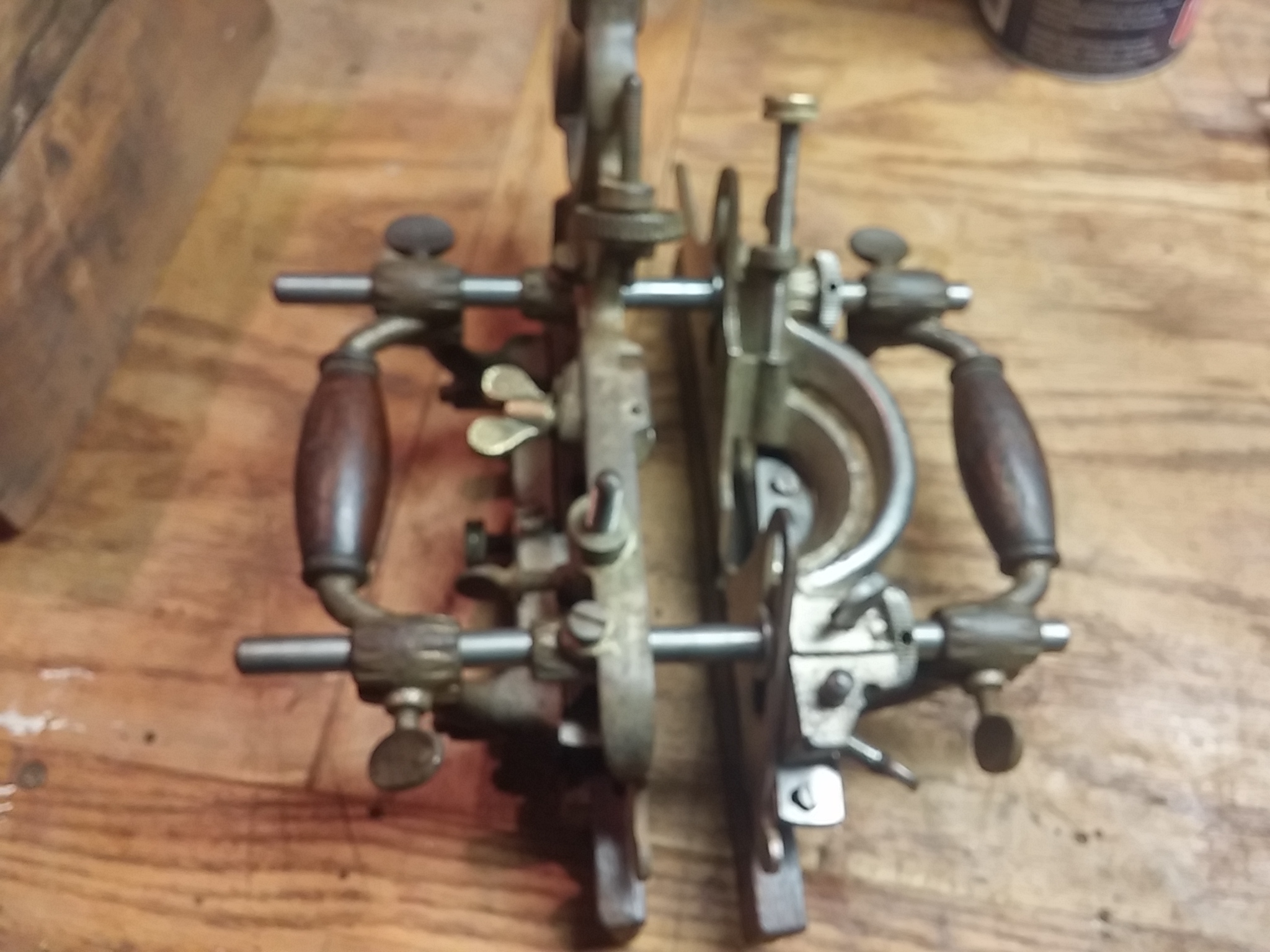

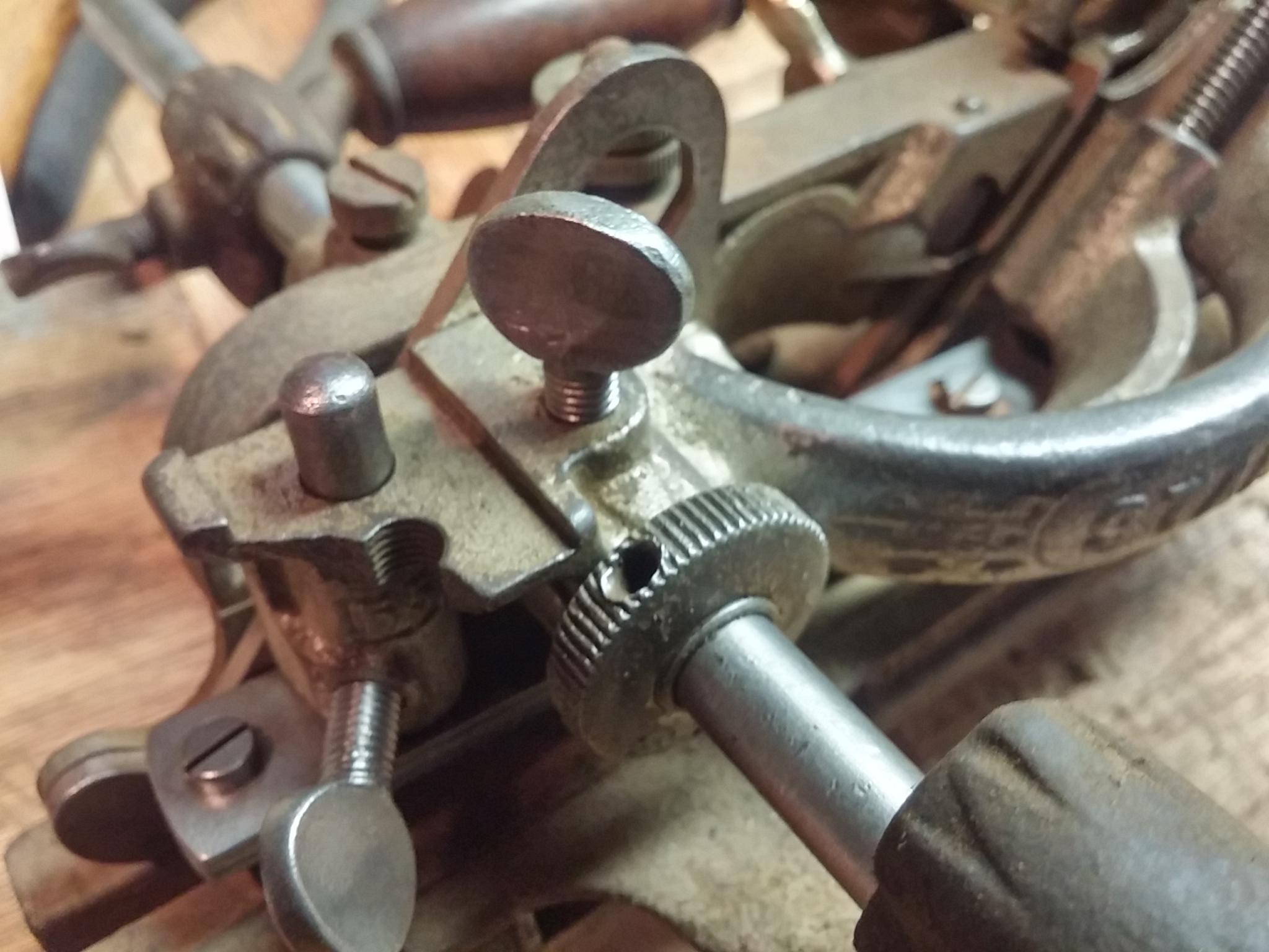

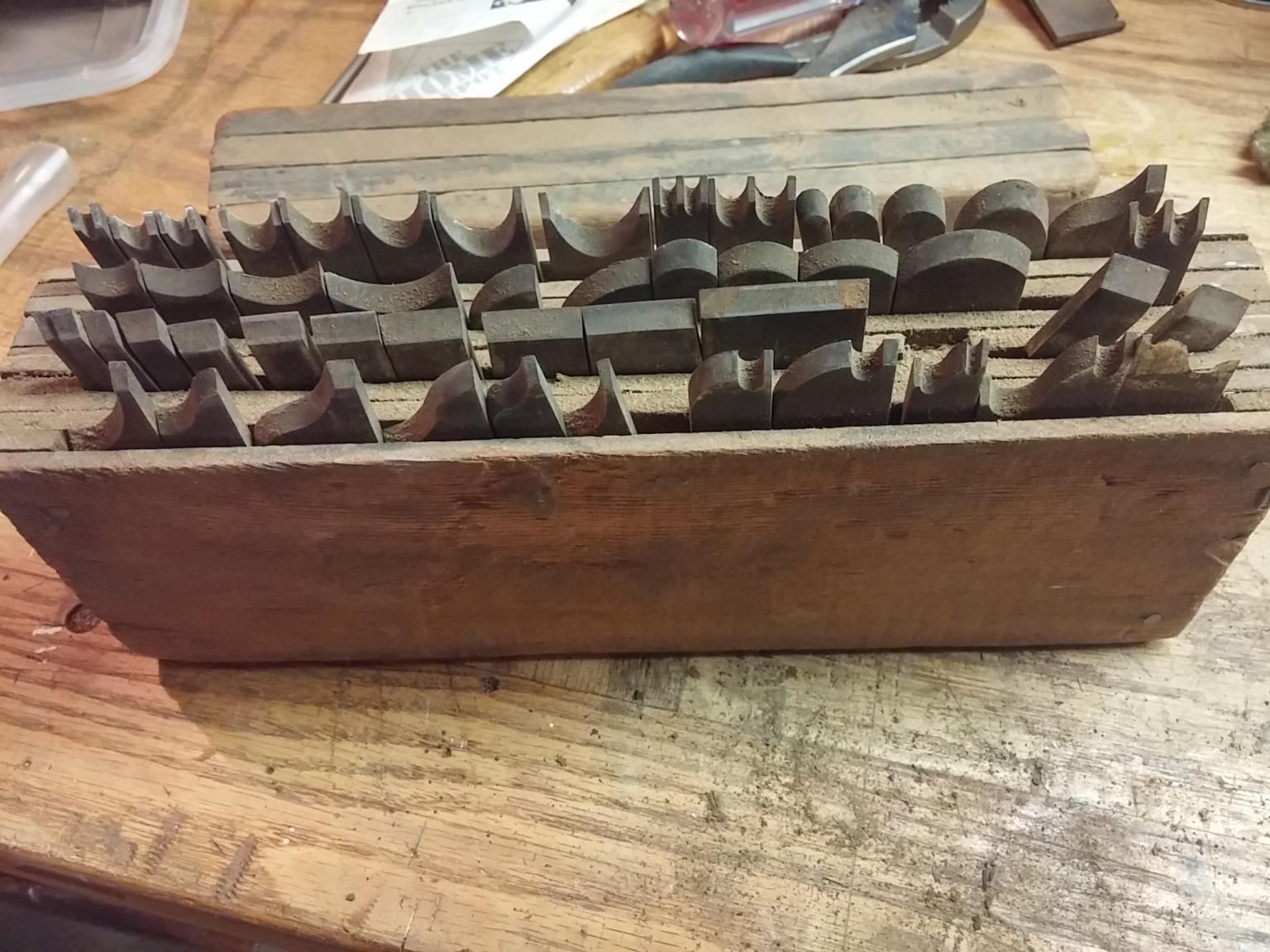

BTW...no...it's not finished cleaning yet...I reassemble it every time so I don't lose parts...
WOW, what a pile of iron that is, too complicated for my simple mind.
Herb
Herb
A whole new appreciation for its name...combination plane...
Actually, the manual is quite good...if one has a good handle on the fundamentals, using the moving parts in some combination to achieve the desired profile makes a lot of sense...fluting versus an edge profile, for example.
I'm no expert user I assure you but taking it apart and playing with it while cleaning it has given me a good understanding of how to "manipulate" it...

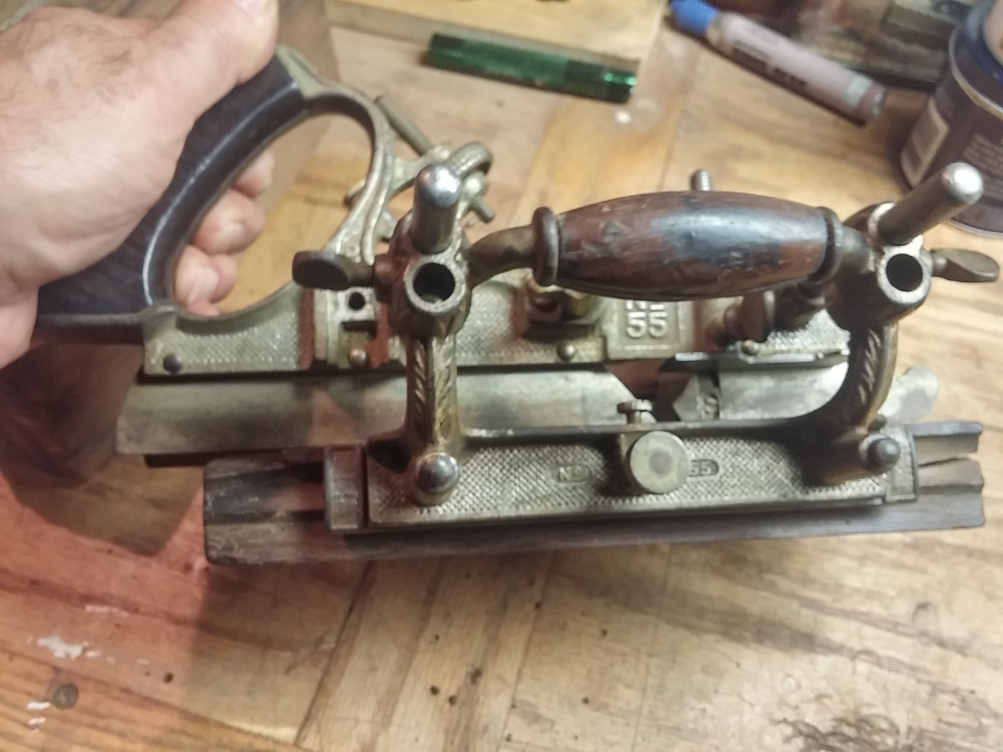

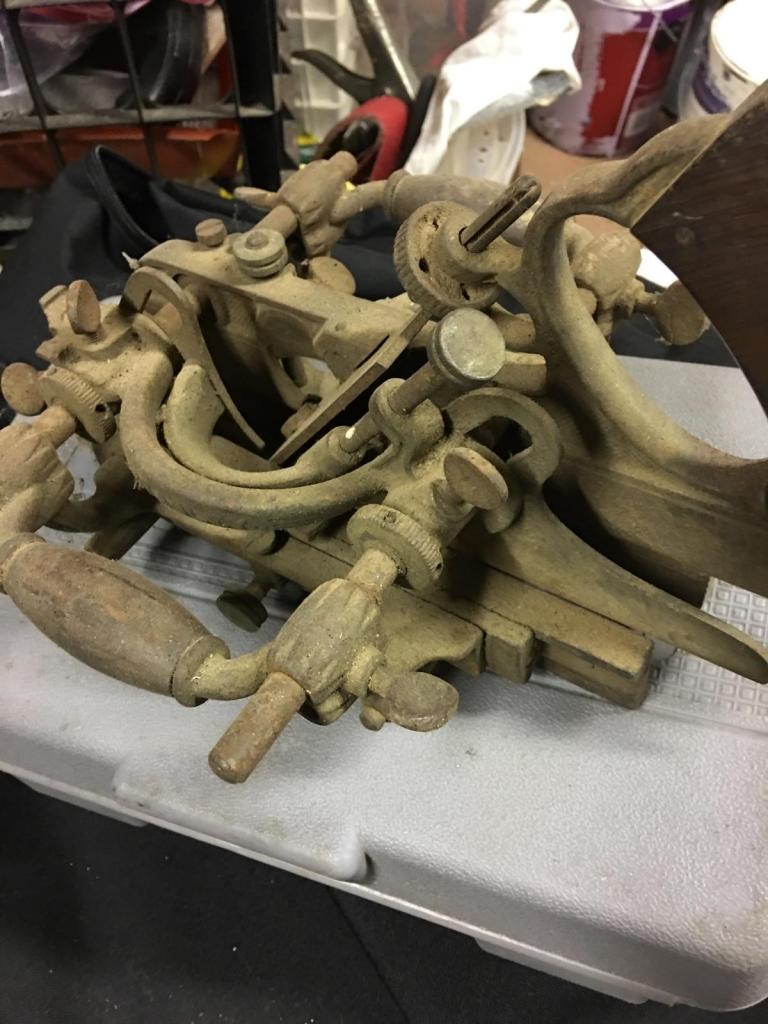

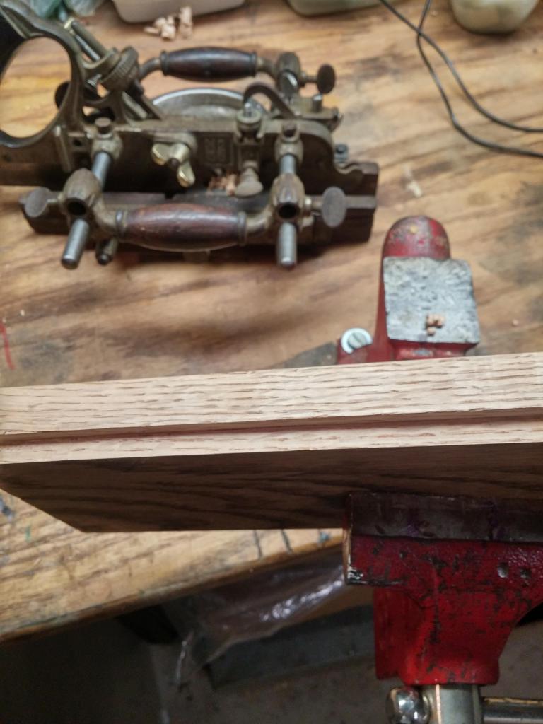

Forgot to add a "before" pic...here it is...it's Feb 13 and finally finished with cleaning...see "after" pics...
I worked at it a bit at a time and only used brass and plastic brushes...the bronzish coating was very fragile...no chemicals...soapy water at times...
And a shot of my first rabbet with the newly cleaned 55...
Unfortunately I now need to let my friend know it's done and get it back to him...still hoping he says "keep it"...
...yeah, right...

What a difference.  Looks like it has been loved all its life.
WOW what a difference,looks like a well used plane instead of an abandoned one now. Good Job.
Herb
