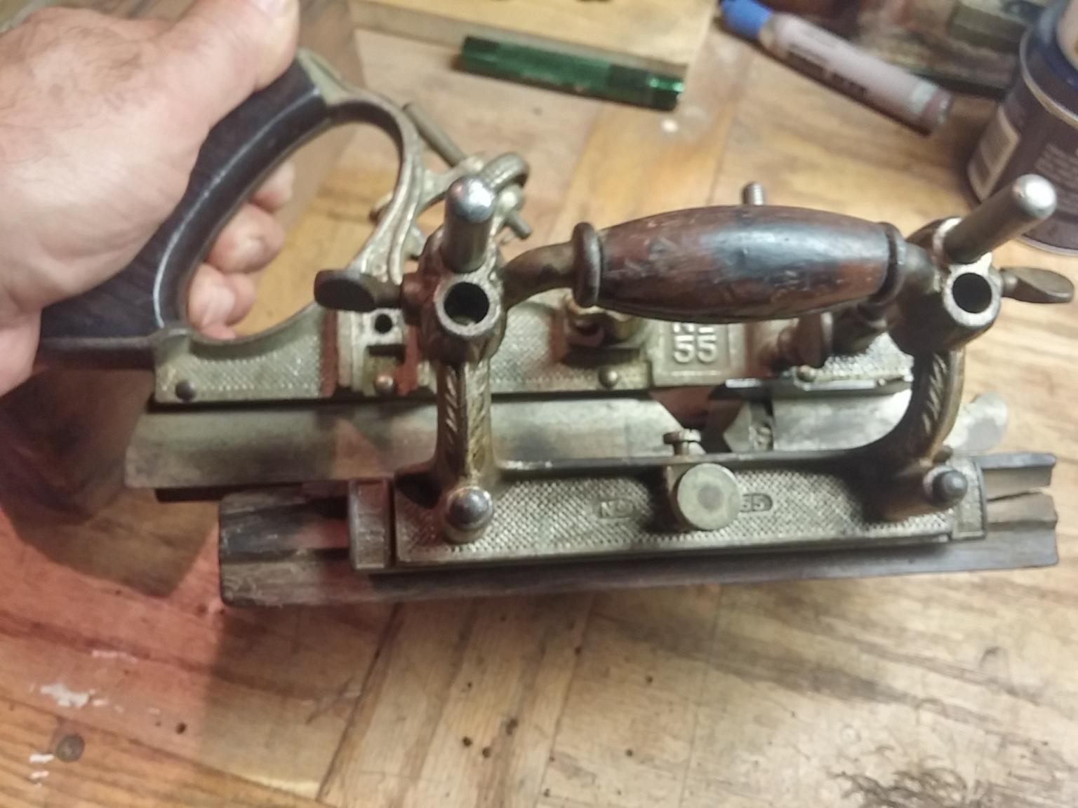

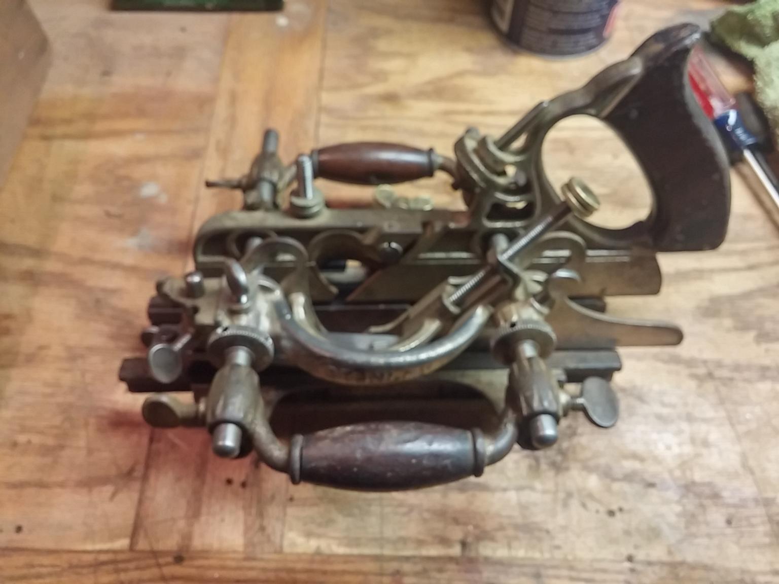

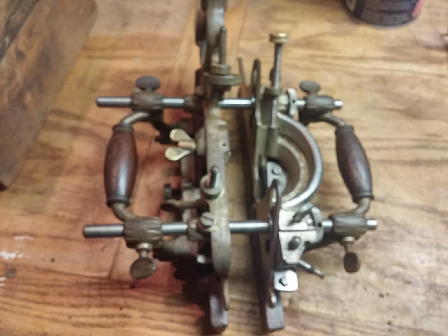

  • Thanks, Steve and John...that all makes sense...   Some pics...maybe some help dating it...?   BTW...no...it's not finished cleaning yet...I reassemble it every time so I don't los
  • Forgot to add a "before" pic...here it is...it's Feb 13 and finally finished with cleaning...see "after" pics...   I worked at it a bit at a time and only used brass and plastic brushes...th
