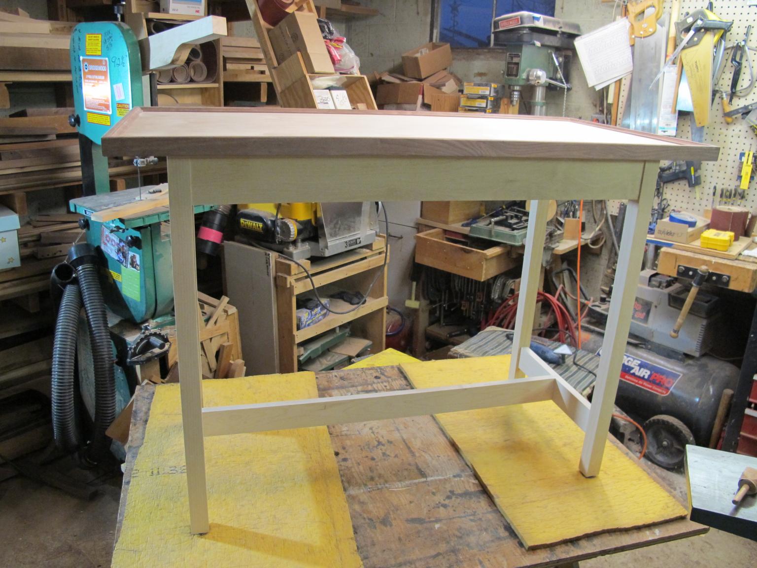

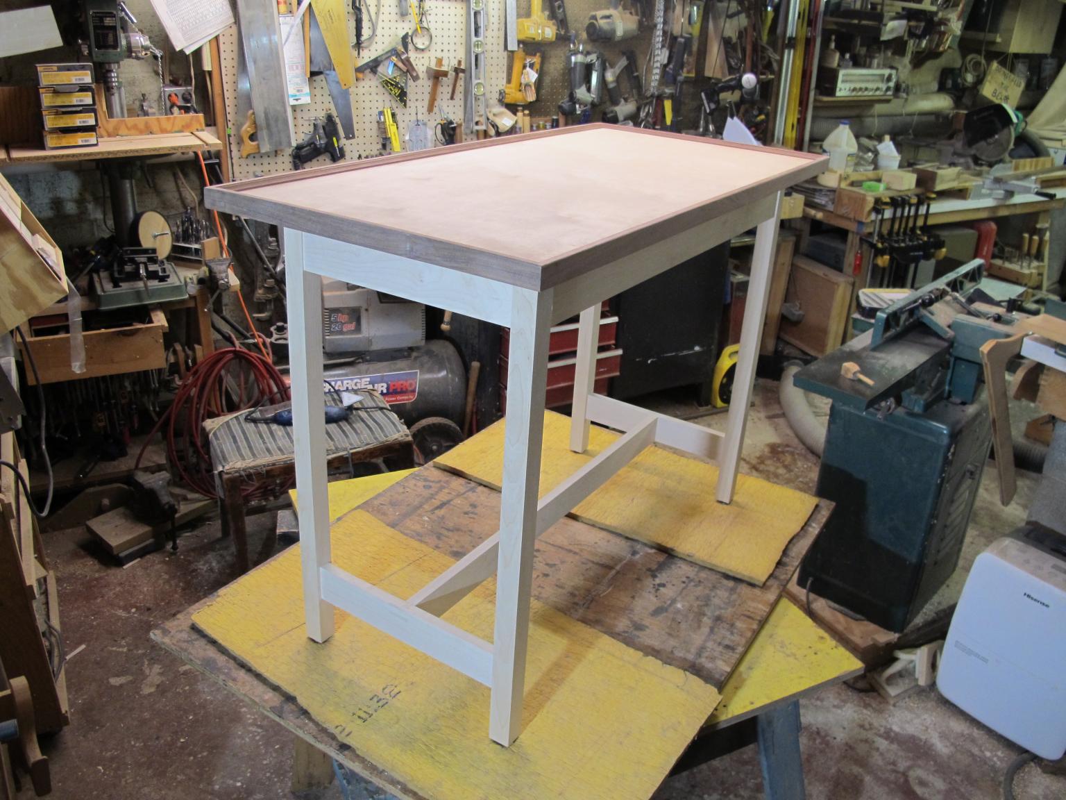

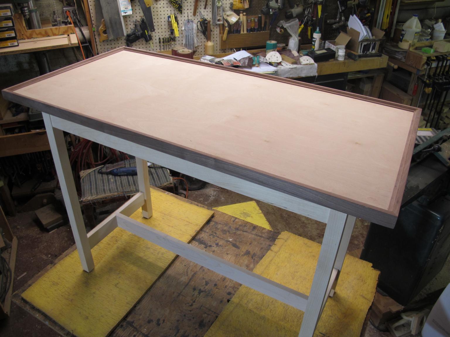

With the base finished, all that was left to do was trim out the top with the walnut edge trim. Glue, clamps and some pin nails.

The finished table is awaiting pickup-

Well I didn't read about the table before I condemned the lip around the top. I thought there is no way I could use a table like that in my shop . Not going in your shop I still want to ask, why the lip or whats that thing sticking up higher than the middle called ??
lew
Posted
@Smallpatch The lip/trim was requested by the minister. Not sure why.
Little confused by what you mean:   "or whats that thing sticking up higher than the middle called ?? "
Smallpatch
Posted
The lip trim. It seem like it would always be in the way!!
lew
Posted
You know what they say- "The customer is always right."
JRo
Posted
It's looks like it would serve best as a large table for games or puzzles so that the pieces won't slide off onto the floor.  Great looking table Lew!
