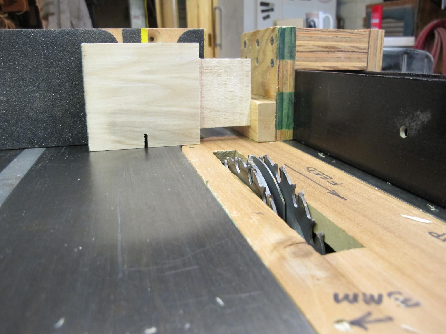

I have an old Delta tenoning jig that makes quick work of making the tenon cheek cuts. However, the length of the long aprons and shelf supports exceeded the distance between my table saw and the ceiling. Looks like a job for the dado blade.
I used the same setup here, as I did for the shoulder cuts, the rip fence with a “depth stop” and the miter gauge. My table saw is a right tilt model (old Bridgewood) but due to space limitations I had to move the rip fence to the “other side” of the blade to be able to make these cuts.

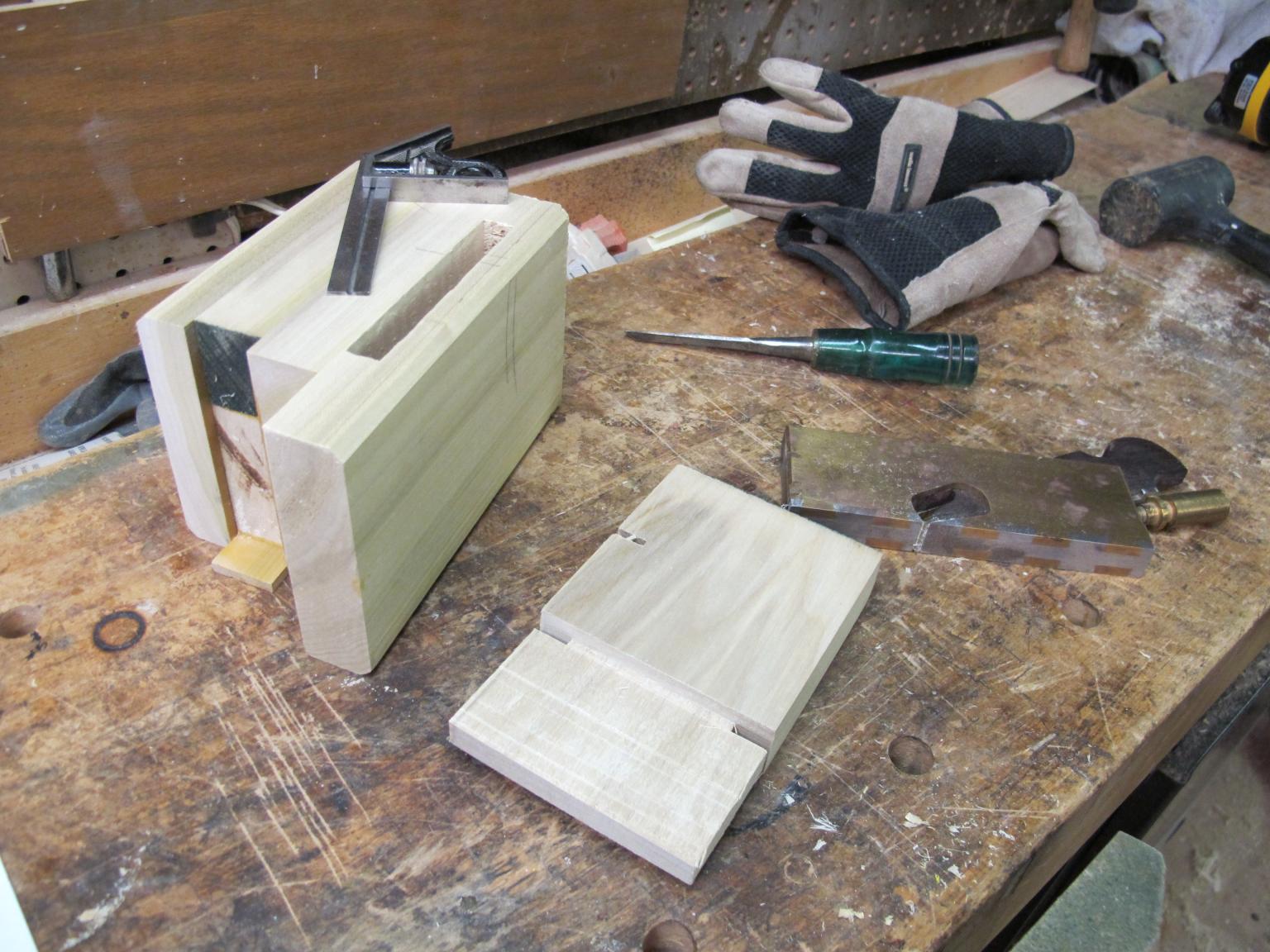

After a couple of adjustments, the tenon thickness was what I was looking for.
Now just run all of the pieces for the tenon thickness
A blade height adjustment to establish the tenon width.
That’ll do
Finally, run the pieces, again, to finish the tenons.
