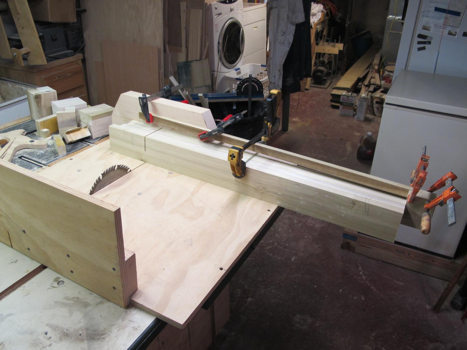

Cutting the legs to length was up next. I opted to use the table saw for this operation. I have a chop saw but it is one of the very early models with a 7.5” blade- it wasn’t going to make the cut in one pass. The table saw wouldn’t make the cut in one pass either but I felt I’d have a little more control using it.
I set up my cross cut sled and squared one end of each leg. Next, I added an extend stop block set for the leg length. One pass, roll the blank over, second pass- done.

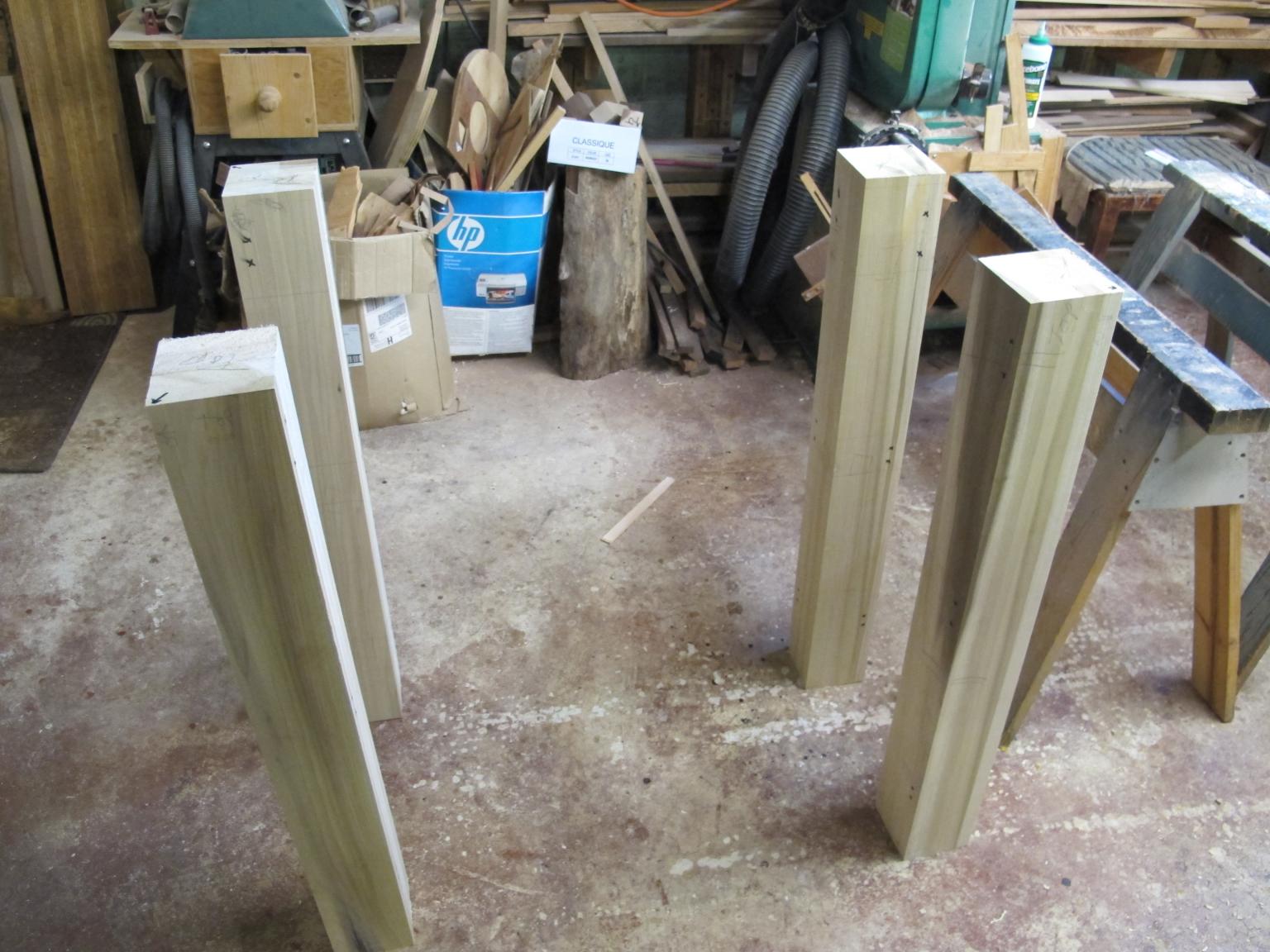

At this point, it was time to layout and cut the mortices in the legs. To make certain the mortices were properly oriented, I labeled everything.

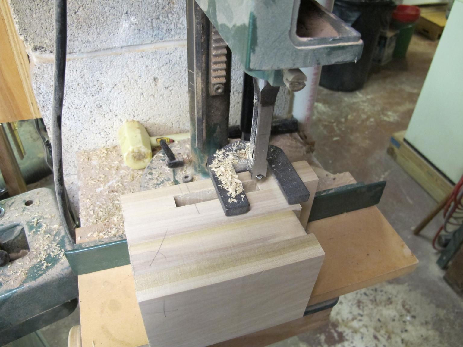

Some practice slots with the hollow chisel morticer.

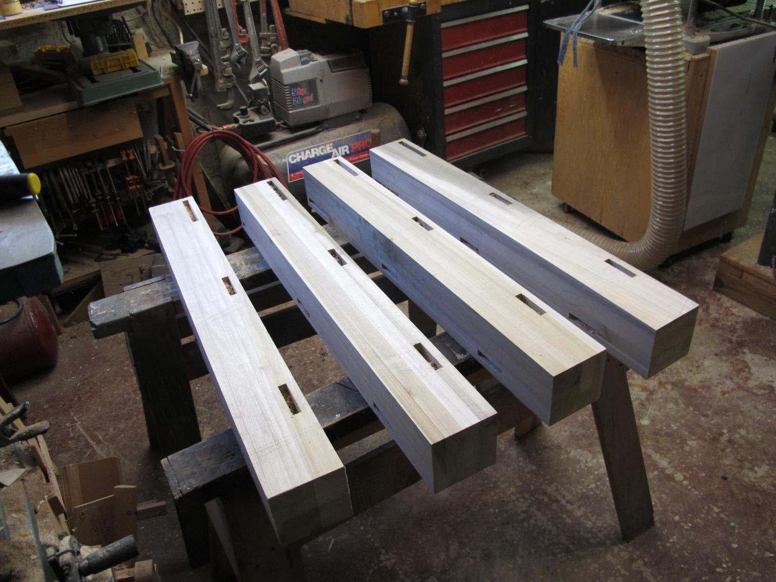

Twenty-four mortices later.
