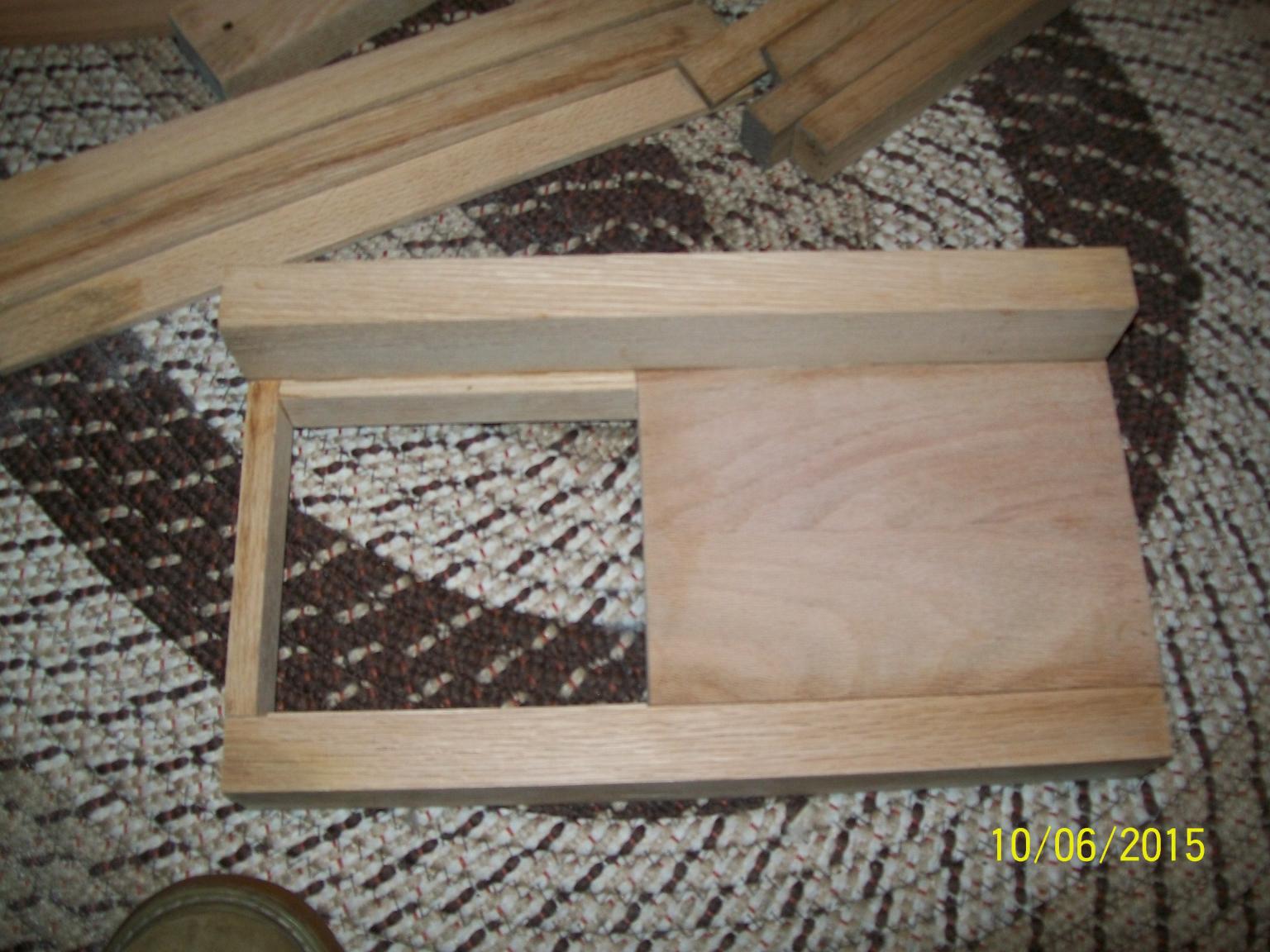

  7. Here's the start of a little project made from some scrap pieces of Oak I got from my friend Ron who passed away the 23rd of September. I'm sure Ron would have got a kick out of this project. It will end up being a test bed style computer case. The lower section is an old AT style case from the old 486, Pentium 1 days. I'll be using it for mounting my power supply, drives, etc.. Here's the Oak frame that will be replacing the old beige plastic front. It's not quite finished, but will give a hint of where this is headed. Front of frame. Rear of frame. Sliding door set in place.
