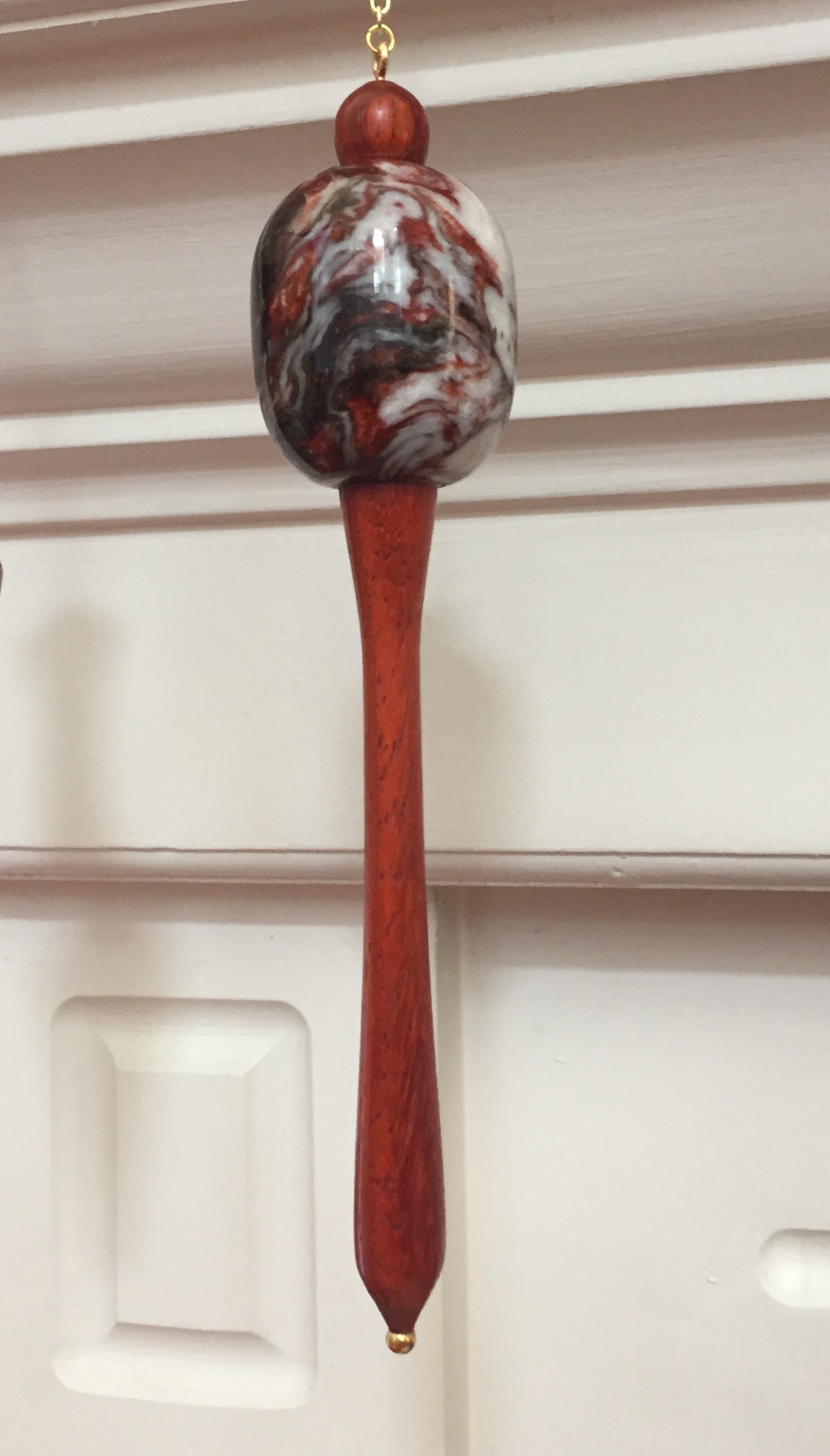

  2. Ron Altier
    Finished JB weld
    This piece of Acrylic was full of small holes and issues. I filled them with JB and turned a couple of times. I mixed it so it was darker when it dried and lighter too. It came out good. I added some Blood wood (I think it was because it was soft) This was a learning lesson and I plan to use it again. When I turned it with my carbide tools, it came off in a powder, rather than a stream. I may have to spend an hour cleaning up all that plastic. It went everywhere

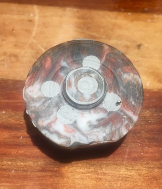

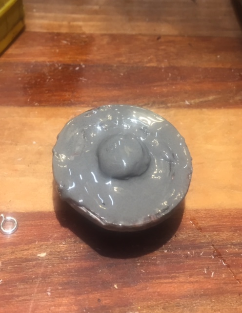

  3. Ron Altier
    Turning JB weld
    I had a small piece left over from my last turning of acrylic and decided to experiment with JB Weld. I drilled some holes in the piece that had a lot of chip outs and small holes. I did not make much effort to make sure holes were filled. When I turned it, it seemed softer than the acrylic and turned easily. No problems and it held in place really well. The trimmings were slightly magnetic, but you could easily blow them off a magnet. It did not polish like the acrylic and I did not use a finish as I sometimes do. I will use it again, probably as feature within the piece. It also help a lot if your project is nearly the same color as JB Weld
