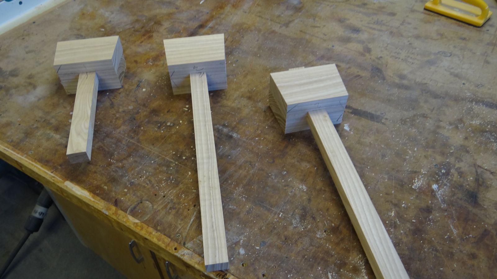

Test Fit
The handles are just dry fit into the slots. To get a great fit I had to sneak up on the handle widths, as not all handle slots in each mallet were the same as the next, because I cut these on the table saw without any jigs, just eyeballing lines is all. So each mallet was a tad different. I had to plane each handle to fit each slot right. I'll have a better assembly process next time, I plan on making many of these and pass them out as gifts and possibly sell them as well.
