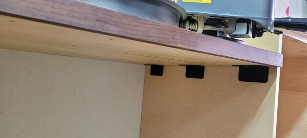

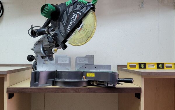

Finish on the surface for the mitersaw (doubled 3/4 ply with walnut front edge) and then worked on attaching to the cabinets with metal brackets.
Painfully slow progress but at least something got done.

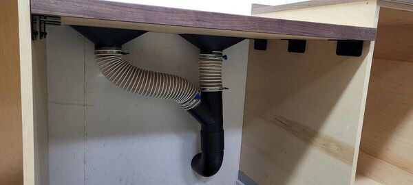

Waiting on some dust collection fittings for the next steps.

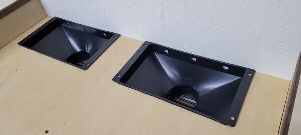

Dust collection ports arrived so worked on getting the tubing figured out. The part below the table will go through the wall to connect with my dust collector and I'll have a shop vac with dust deputy for the small port on the mitersaw. I cut into the top for each - still need to cut a recess so the lip of the dust ports will be level with the table. Progress!
Nice work Barb!

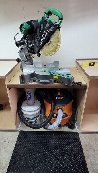

Might not look different, but routered in recess for the ports, cut through the wall for the dust collection, and also ran the power cord through to an outlet (not sure how that will go as I always unplug all my tools to clean at the end of the day). Tried a few cuts with the dust collection going and it does definitely help pull down the "dust cloud" typical for mitersaw cuts. Once I get the box built around it, I'm hopeful to have better control of the mitersaw mess. 🙂
Need to make a hole through the 1.5 inches of plywood that makes up the mitersaw base for the vacuum hose. Not sure the best way to get a clean hole. Options would be to get a large hole saw, plunge router with some type of template (??), or jig saw (likely rough). Appreciate any other suggestions or recommendations on getting that accomplished.
Edited by BB1
TwoThumbsUp
Power cord for the miter saw?
TwoThumbsUp
+1

Barb... use a jig saw for making the hole.
