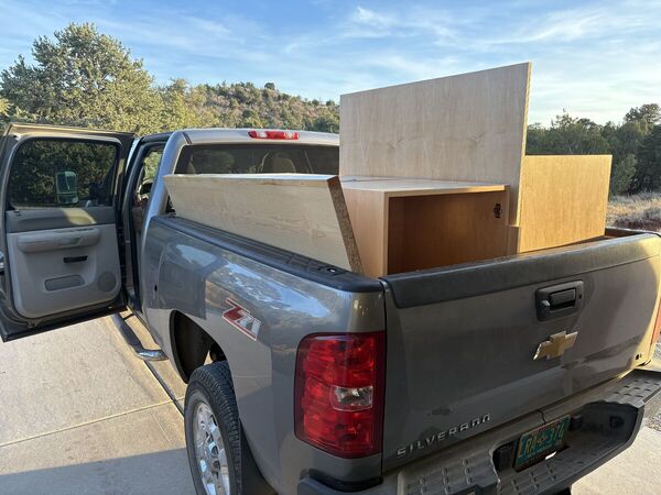

  • all installed today. one loose end to wrap up tomorrow or so is a close out panel from the top of the cabinet to the ceiling. decided to wait to measure the width (5-1/2"), and next is making basebo
