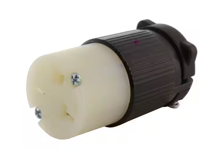

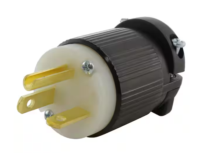

December 5, 2025Dec 5 comment_366526 https://www.homedepot.com/p/AC-WORKS-20-Amp-250-Volt-NEMA-6-20P-3-Prong-Industrial-Grade-Have-Duty-Male-Plug-AS620P/309534126?source=shoppingads&locale=en-US&fp=ggl https://www.homedepot.com/p/AC-WORKS-15-20-Amp-250-Volt-NEMA-6-15-20R-3-Prong-Industrial-Grade-Heavy-Duty-Female-Connector-AS620R/309534130?MERCH=REC-_-fbt_test-_-320125439-_-1-_-n/a-_-n/a-_-n/a-_-n/a-_-n/a https://www.homedepot.com/p/Southwire-By-the-Foot-12-3-600-Volt-CU-Black-Flexible-Portable-Power-SOOW-Cord-55809499/204632920 Report
December 5, 2025Dec 5 comment_366528 41 minutes ago, BB1 said: Yes, the DC is 220 with a 6-15 plug. This fits in the 6-20 receptacle I have in that room. Unfortunately, the cord on the DC is very short. Thus, trying to figure out the best extension cord option given my situation - do I go with 6-15 to match the DC or 6-20 to match the receptacle? Either should work fine. The only real difference is the maximum amperage rating (15a vs 20a). If you choose to make your own extension cord, I suppose you could use a 6-15 female plug for the DC connection and a 6-20 male plug for the receptacle connection. If it was me and purchasing (or making) an extension cord, I'd likely go with the 6-20 on both ends but definitely want 12 AWG wire. Not exactly the same scenario but answers the general question HERE Report
December 5, 2025Dec 5 Author comment_366530 Lew, I looking to purchase rather than make my own. Appreciate the links but...all the connections are way beyond my comfort level!😬 Realize many people do that, but I wouldn't feel capable or confident (two important traits when working with electricity - especially the capable part!). Grandpadave - that link is helpful in expanding my meager knowledge base. Have learned a lot in the last few days, as well as realizing how little I know (and likely don't know what I still don't know!!). I think I'll look for a 6-20 extension cord, 12 AWG, in a 15-25 foot length (guessing there will be limited options at BORG). Report

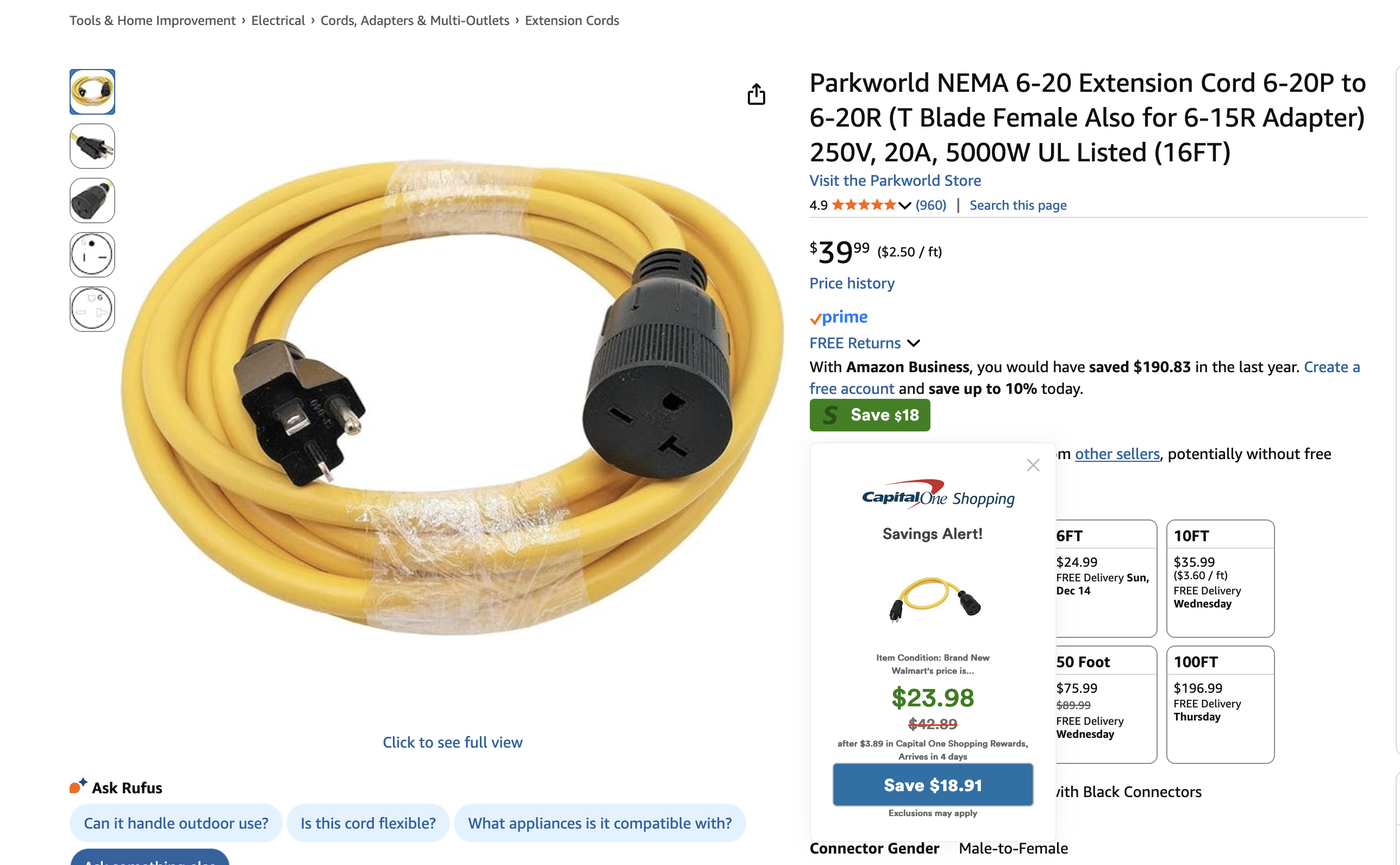

December 5, 2025Dec 5 comment_366533 14 minutes ago, BB1 said: I think I'll look for a 6-20 extension cord, 12 AWG, in a 15-25 foot length (guessing there will be limited options at BORG). I'd try on line first and see what pops up, then you could search Borg and others to see what they have. I found this one on Amazon, they have a broad variety of lengths, that price is for 16' long.: Edited December 5, 2025Dec 5 by Fred W. Hargis Jr Report

December 6, 2025Dec 6 Author Popular Post comment_366563 Looked online and found 2. One by Parkworld (and see thats the same one Fred noted!) and another by Plugtul (that is only 10 or 25 ft so likely would go with the 25 ft option). The 90 degree plug does look like a nice feature on the Plugtul. If anyone has pros/cons of either, I'd be interested. Report
