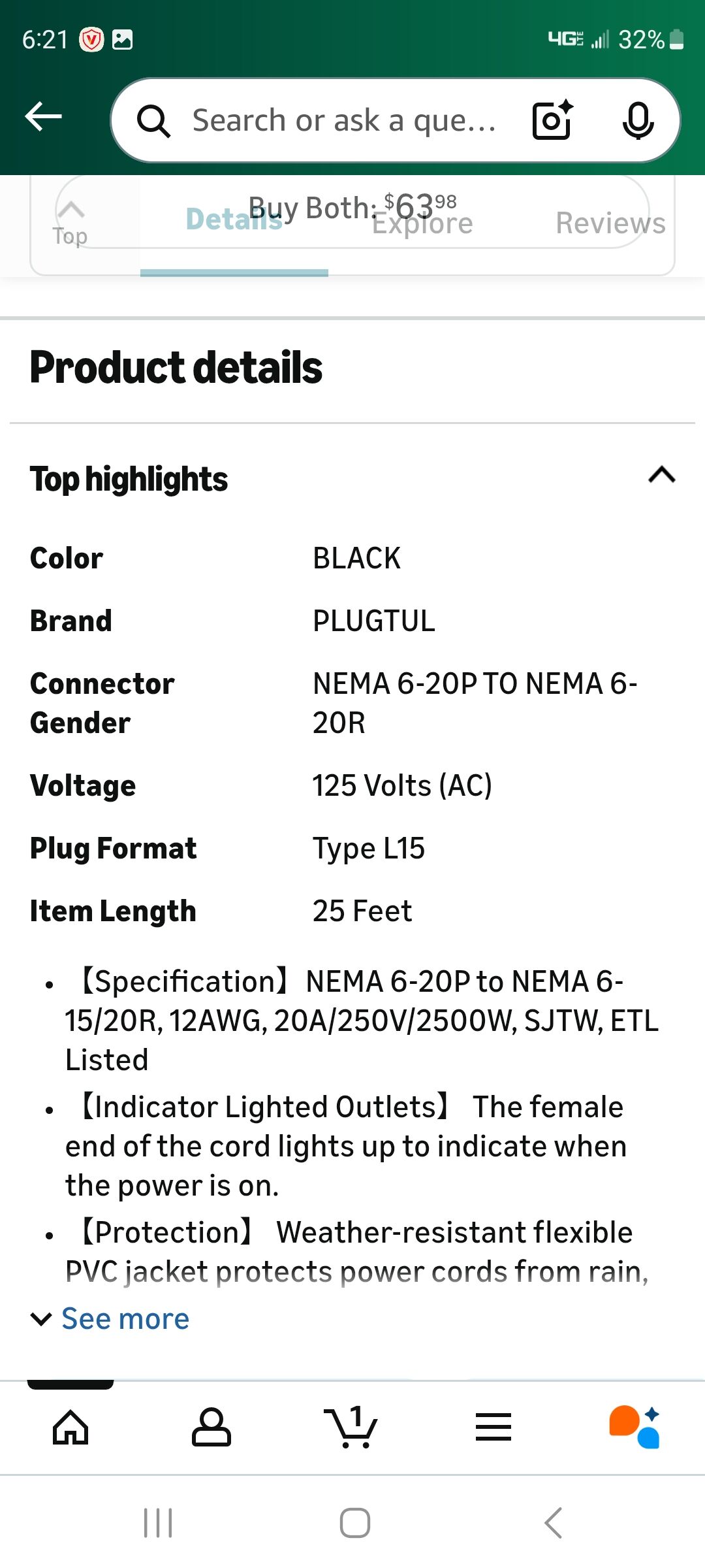

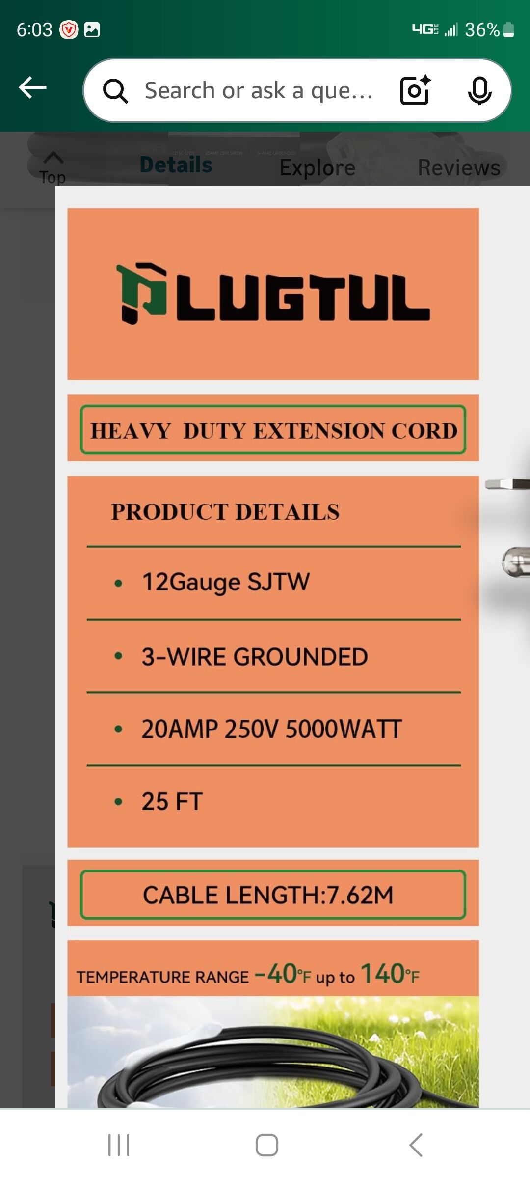

December 6, 2025Dec 6 Author comment_366576 I'm leaning toward the Plugtul with the 90 even though there are not many reviews compared to the Parkworld brand. Funny how reviews have come into my decision making so often (even though at this point in some cases not so sure if they are real vs fake). Report

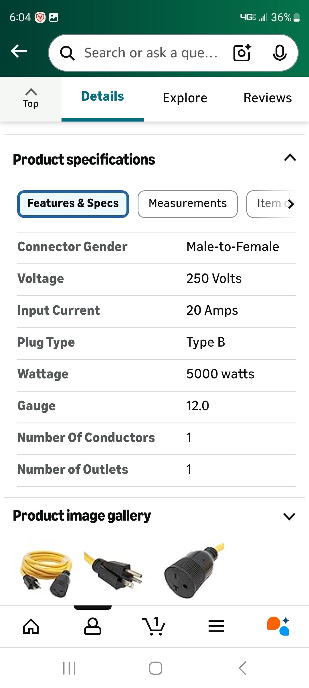

December 6, 2025Dec 6 Author comment_366577 Looking more at the Plugtul and there seem to be conflicting info (question if this is a lower level than the Parkworld, although more limited info on that one is given). The Parkworld has less info (and doesn't have the 90 degree plug Report
December 6, 2025Dec 6 comment_366579 I wouldn't worry about the review thing, it's only an extension cord...how much can you say about it. No disprespect, but you may be overthinking this a little. One thing I noticed is the plug format on the Plugtul is L15, that's normally a locking plug and if it is, your DC probably won't plug into it, nor will it plug into the wall outlet. Not to repeat what you know, but the 6-20R is like the duplex outlet below. The L version is the extension....you can see the one stab has to be bent a little and they are arranged in a circular pattern...this allows you to insert it and twist to lock. If you can see the pics of the Plugtul that show what they look like you can judge if it's non-locking. To be honest, I'm not sure I've ever seen a 90° locking plug, but they may exist. Report
December 6, 2025Dec 6 Author comment_366587 1 hour ago, Fred W. Hargis Jr said: No disprespect, but you may be overthinking this a little For sure 🤣🤣🤣 The more uncertain I am, the more I overanalyze to avoid making what someone with more background would see as an obvious mistake. I need a "electric 101" class.🙄 I think part of the Plugtul description is in error as the main description and pictures sure look to be the typical 6-20. May just go with the other one, even though I'll miss put on the 90 degree plug. Will ponder a bit more 🤔 Report

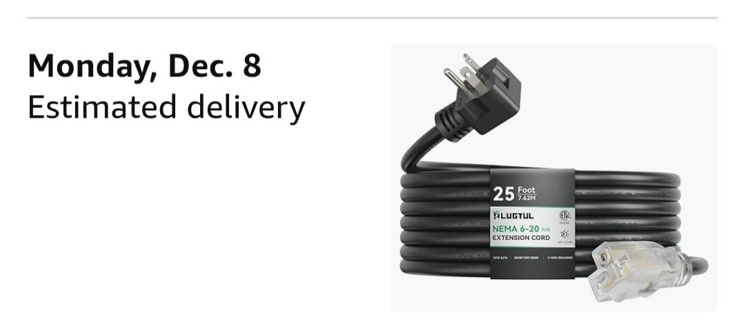

December 6, 2025Dec 6 Popular Post comment_366589 All great advice & I'll agree with Fred don't over think this. 13 hours ago, BB1 said: another by Plugtul (that is only 10 or 25 ft so likely would go with the 25 ft option). The 90 degree plug does look like a nice feature on the Plugtul. If anyone has pros/cons of either, I'd be interested. This is the cord you'll want. Price wise the cord alone will cost you $30 then add the cord caps & you're at $50 and you still have to assemble it. The advantage to a 90-degree cord keeps the wire tighter to the wall and less risk of catching the cord. @Gunny would describe this as " paralysis by analysis ". Order the cord and move on to your wood rack, you got this. Edited December 6, 2025Dec 6 by DuckSoup Report
December 6, 2025Dec 6 Author Popular Post comment_366603 2 hours ago, DuckSoup said: Order the cord and move on to your wood rack, you got this. Done 🙂 Thank you everyone for both the education and encouragement. And was able to pick up some nice straight 2x4s too so I'm rolling today. 😁 Report

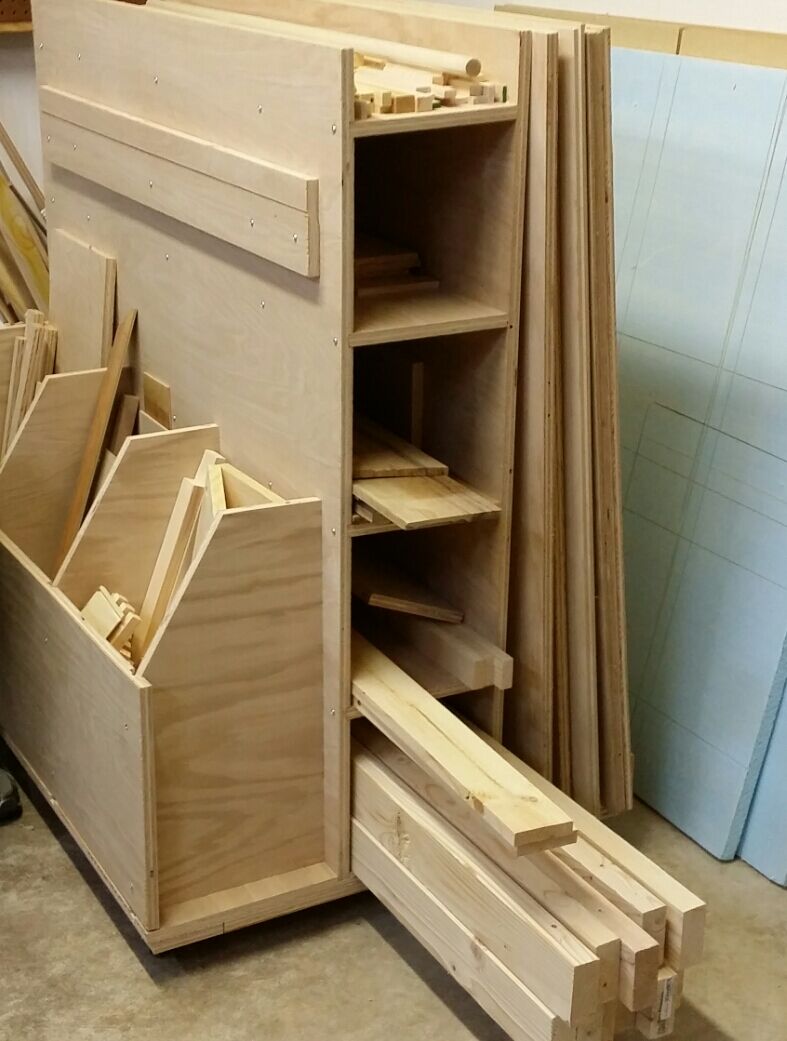

December 6, 2025Dec 6 comment_366605 Excellent news! Can’t wait to see your scrap cart. If you need some encouragement, I built one a year or so ago. I’d be happy to send pics if you want. Report

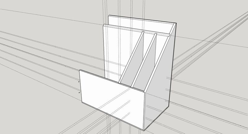

December 6, 2025Dec 6 Author Popular Post comment_366608 35 minutes ago, SigmundJake said: Can’t wait to see your scrap cart I have a "scrap cart" that I would like to upgrade - will use it for plywood (picture was when I first built it). I'm not a fan of the cubbies after some mouse situations that were quite gross (so open horizontal storage is what I want to avoid). Thus, the new storage will be for long boards. Report
December 6, 2025Dec 6 Popular Post comment_366609 Excellent work! My first one was just about like it. I’d take a sharpie and write the dimensions on the end of the cut off’s. It did work, but when I make it back to the shop in a little while, I’ll send you my solution. Perfect? Oh heck no. Better than before? Absolutely! Report
December 6, 2025Dec 6 Popular Post comment_366619 My design uses similar compartments on the front, but open in the back. It can house full sheets of plywood, maybe 3-4 3/4” sheets? I’ll post a pic when I get the area presentable. 😁 Report
