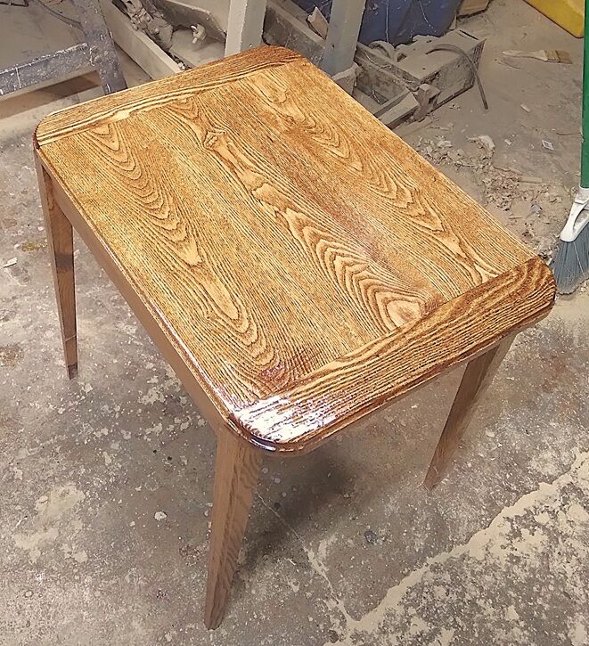

Letting this sit a day...still have to run a cove around the top of the Top..and see about a finish..
Stay tuned..
Out of the clamps, this morning..
ran this thing around, twice..
then sanded the top to 220 grit, for now...
Moved this back to the tablesaw....stained the underside...and wiped it down..
Then, did the same to the top of the Table..
Stand this up on it's own four feet....and let it dry a day...or 2...
Brush on, wipe off...
Stay tuned :OldManSmiley:
That top has some beautiful grain patterns. Like it a lot. :TwoThumbsUp:
That is a smooth design table.
Very nice!
 Well done Bandit, clean lines.
After a second coat on the top of the table...
needs an old T-shirt to polish it up with...we'll see..
:Praise::TwoThumbsUp::TwoThumbsUp::Praise:
1st mistake....brought the table upstairs
2nd Mistake....The Boss caught sight of it..
Had to move the bed about half a foot..then re-route all the cords and cables...to her NEW side of the bed...then she loaded it up with all her bedside stuff...
Project has done been Table-napped!
Table is an exact match, height-wise to the top of the Mattress...
Thanks for looking in!:TwoThumbsUp:
