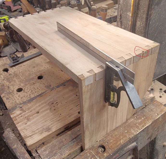

Popular Post steven newman Posted July 9 Author Popular Post Report Posted July 9 Too hot hot outside..90 minutes in the shop...18 photos taken...Pare & Edit down to 14 photos.. So...Lay out another batch of pins.. then run a handsaw for a bit... Time to chop a bit, with a NEW Jig! Start with the show face first... Chop halfway down, leave a tab for support,,flip the board over.. Clean things out..use these to lay out the Tails... Bandsaw to cut out the waste, staying on the waste side of those line...Mallet and a block of wood to dry fit, again.. Checked for square..hand plane to level a few high spots... Reassemble the 3 parts.. So...what is next? Need to get these 3 parts fitted up...Front needs trimmed...and dovetailed to the sides. Top needs to sit in a groove, but..there needs to be a rebate milled along the edges of the Top...so that the Top sits flush with the tops of the sides...then figure out the bevels needed to install that fancy lid.. There IS a "Home Office" in the shop? Looks good to me... Stay tuned.. Grandpadave52, lew, Larry Buskirk and 3 others 6 Quote

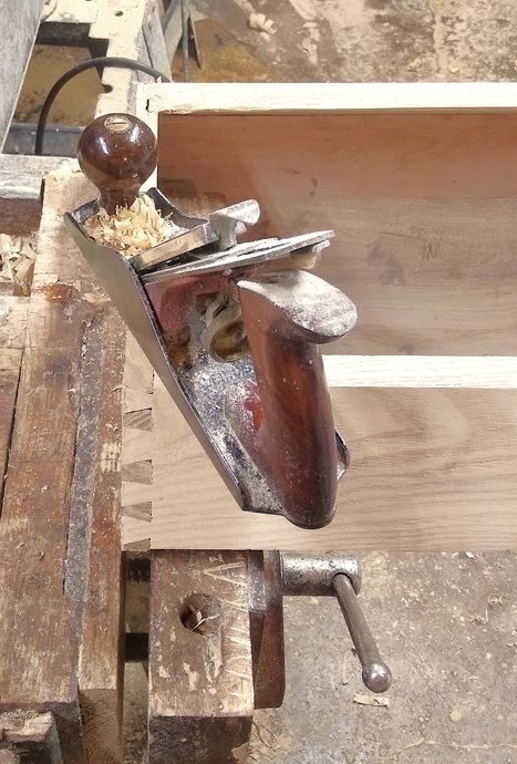

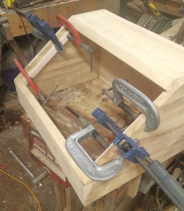

steven newman Posted July 14 Author Report Posted July 14 Grooves have been plowed.. And fitted ...the sides get something like this.. Then a groove where the Top and the Back meet... Once all that was fitted out, then the glue and clamps arrived.. Let the clamps sit until this morning...then put them all away...Clamped the case into the vise.. And used a plane to level things out...( Millers Falls No. 8, OEM iron, to) Which meant going across end grain...like the top of a "Normal" box...plane to get everything the same level...because I needed to lay out where to trim the lid at.. Looking more like a "Salt Box" than a "Bread Box"? Stay tuned.. 4DThinker, lew, Harry Brink and 1 other 4 Quote

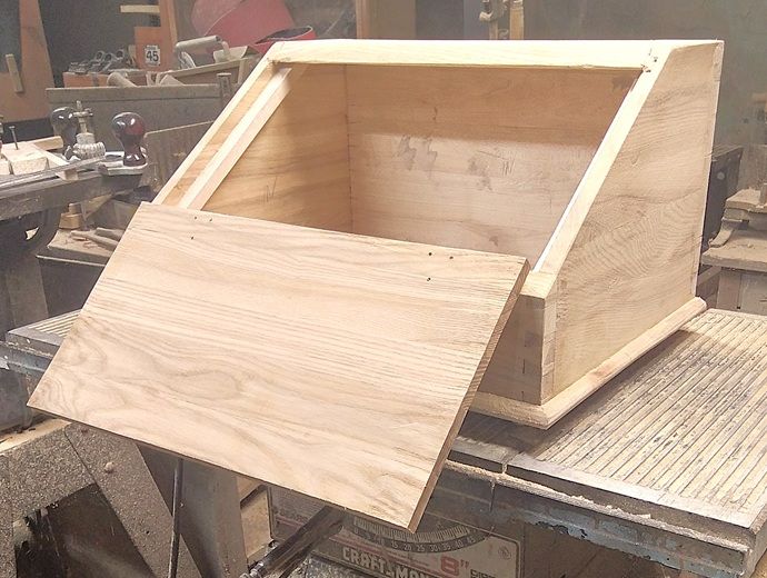

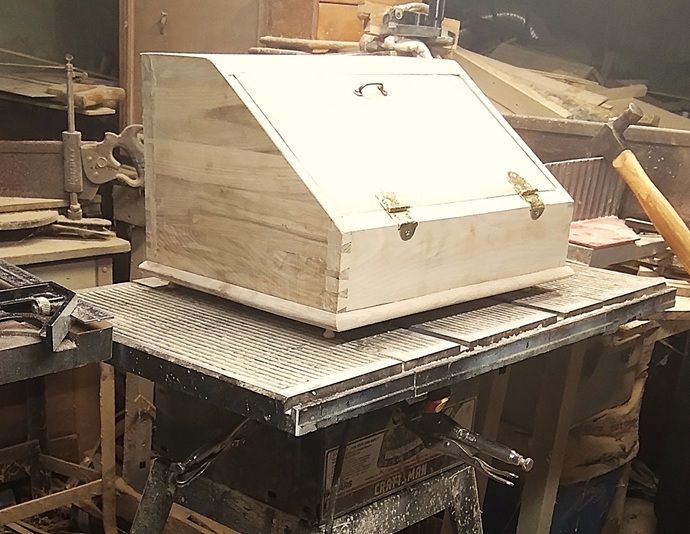

steven newman Posted July 15 Author Report Posted July 15 Ok...got bored sitting around on the computer..so..as Norm Abram would say..."Time for a little assembly"? 3 edges of the Base panel were rounded over, with a Stanley No. 4-1/2 plane...Panel was then installed using just screws, no glue...then 4 "feet" were installed.. The door/lid works! Close it up.... Installed a handle, for when I need to open the lid... Tomorrow? Sand everything down...and then sand some more...to at least 220 grit.. Then maybe a coat of Witch's Brew? then sand to 320 grit, and brush on a coat or 2 of Warm Gloss Poly? See what happens, when I get bored? Stay tuned... lew, 4DThinker, Harry Brink and 1 other 4 Quote

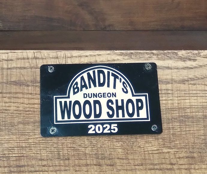

steven newman Posted July 17 Author Report Posted July 17 Next question...which of these tags do I install, and where at... And..before or after the varnish is done....these install with small brass screws..BTW... Hmmm.. Harry Brink, HARO50, lew and 1 other 4 Quote
Popular Post lew Posted July 17 Popular Post Report Posted July 17 33 minutes ago, steven newman said: which of these tags do I install, and where at.. I like the bottom one. I would put it on the lid between the hinges, but that's just me. Love how this one turned out. Looks like it's completely "mouse proof" HARO50, steven newman, Harry Brink and 2 others 4 1 Quote
Gerald Posted July 18 Report Posted July 18 I like the black on white and I agree with Lew's positioning . Looking good. One question Why have lid open to front instead of what I consider usual to open toward the back? steven newman, lew, Grandpadave52 and 1 other 3 1 Quote
Popular Post steven newman Posted July 18 Author Popular Post Report Posted July 18 Box will sit under an overhead cabinet, not enough room to lift the lid towards the back of the box.... This way, one can open the lid, set a loaf on the lid, get out how many slices one needs, place the loaf back inside, and close the lid..with zero chance of the lid slamming down on your hand... Stay tuned.. Gerald, Grandpadave52, lew and 2 others 3 2 Quote
Popular Post steven newman Posted July 18 Author Popular Post Report Posted July 18 So...got out a couple tools, and chucked a counter sink bit into a drill... Eggbeater is a Gooddell Pratt, with a 1/16" bit...screwdriver is a Phillips... Needed to drill 4 holes through a metal label, first,,,then countersink the holes...Eggbeater then drilled pilot holes for screws.. I even tried to "clock" the screws...came close... So..where did this label wind up at? Right where you can read it, when the lid is opened... BTW: the first coat of Warm Gloss Poly has brushed on... Just on the outside of the box..stay tuned.. Gerald, Grandpadave52, HARO50 and 3 others 4 2 Quote
