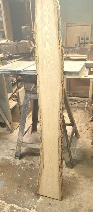

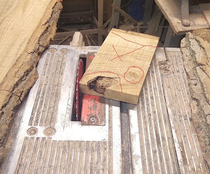

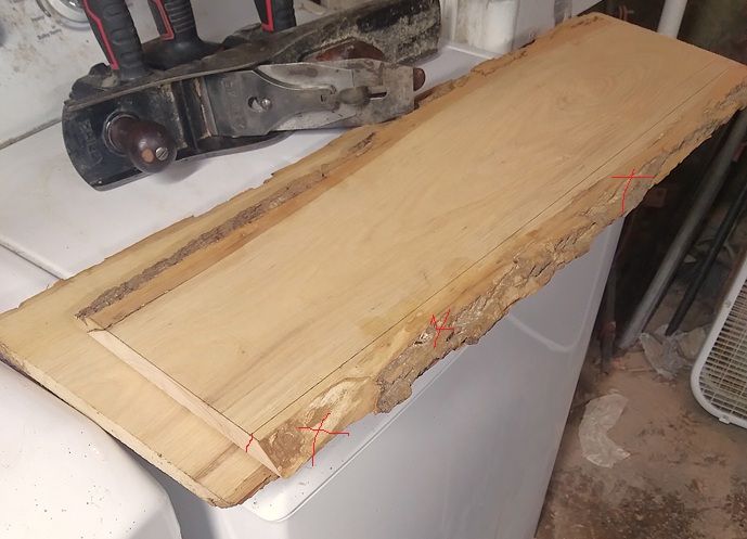

Have about 10' of 1 x 6 Soft Maple leftover.....and these 3 slabs..:TwoThumbsUp:
Yes, there are 3 slabs sitting there...:JawDrop:
These were sawn off of a small log, one after another...:TwoThumbsUp:
Hmmm, that knot will just have to leave...yes, they do line up..No.3 slab?:WonderScratch:
I do NOT do Live Edge Projects, sorry......will have to see how much is left after the bark has gone...:ChinScratch:
Grain is called Cathedrals.....:OldManSmiley:
Hmmm...we'll see what we can cobble up...

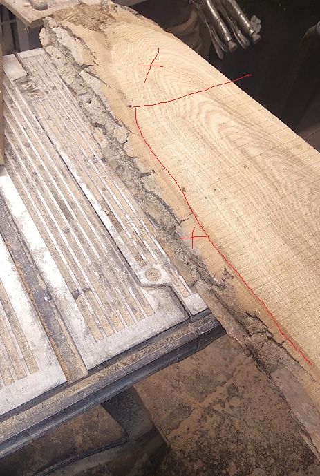

    Well..got to start somewhere....so.. Hauled one plank to the shop, laid a straightedge on the face, laid out where to make a few cuts.. Cross cut right where the wider part met t

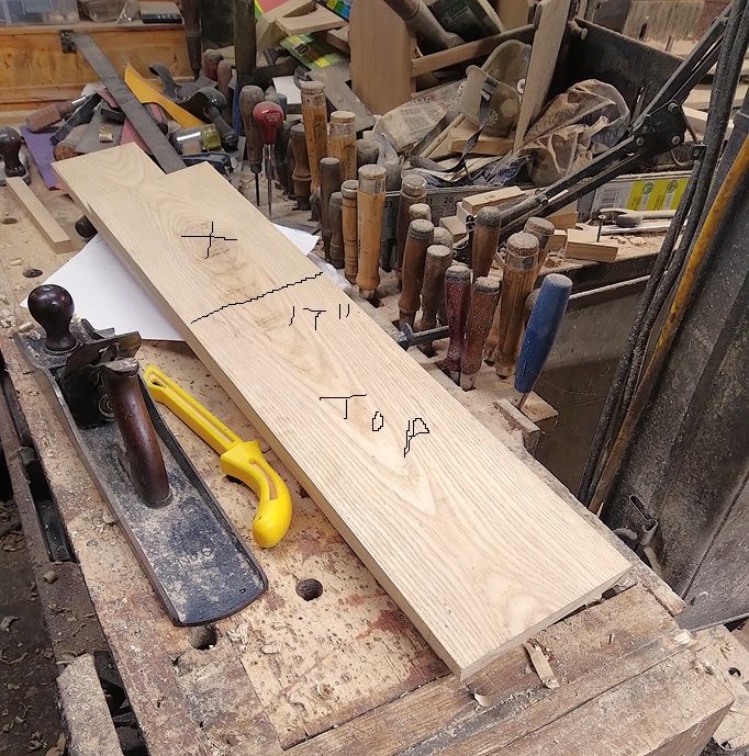

Well..got to start somewhere....so..:ChinScratch:

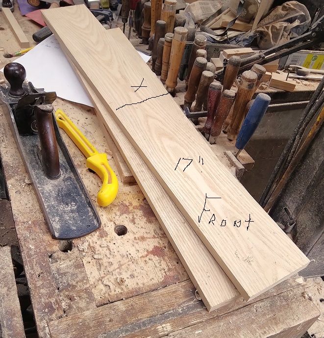

Hauled one plank to the shop, laid a straightedge on the face, laid out where to make a few cuts..:ChinScratch:

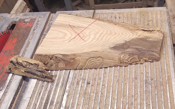

Cross cut right where the wider part met the narrow section...Pencil line ?:WonderScratch:

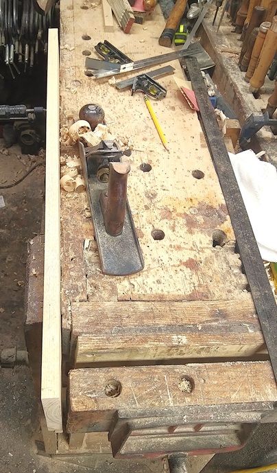

I needed one straight edge to rub against the rip fence on the table saw...edges needed a bit more work...:OldManSmiley:

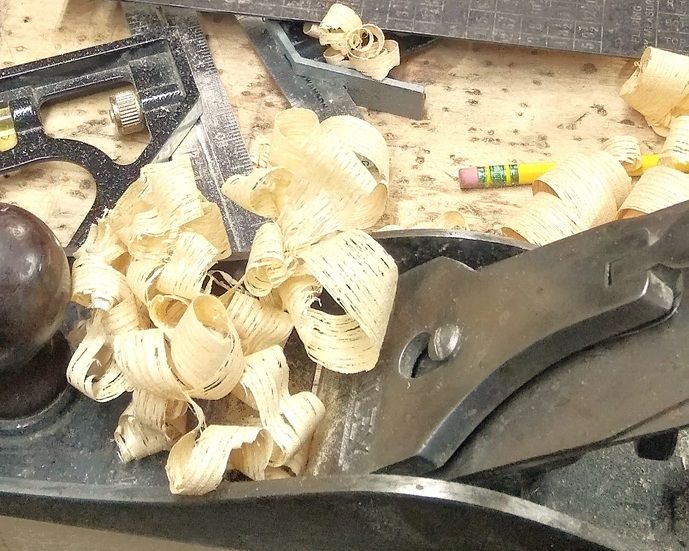

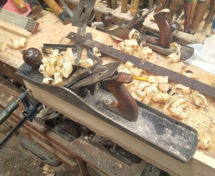

Ohio Tool Co. No. 0-5 was a bit too short as a Jointer...installed a SHARP iron in the Stanley No. 6c....:TwoThumbsUp:
How sharp?:WonderScratch:
Not too bad..?:ChinScratch:
Then run the jointed edges through the tablesaw... bring the next plank to the shop...and..cut out the "Middleman"..:MachineGun:

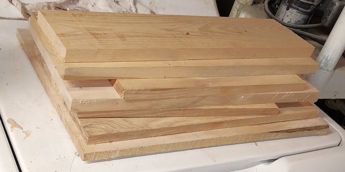

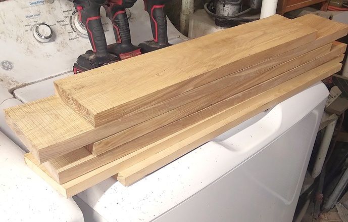

Lets see,, I wound up with a stack of 1 x 2s..:ChinScratch:
A stack of 1 x 4s...:OldManSmiley:

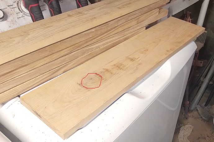

And a single 3/4" x 6" plank...seems plank #1 had already been planed before I bought it...so, NOW the rest of the "Stash" needs to be resawn down to match:PullingHair:
The single WIDE one will get ripped down the center...note the huge knot inside that red circle....:BangingHead:

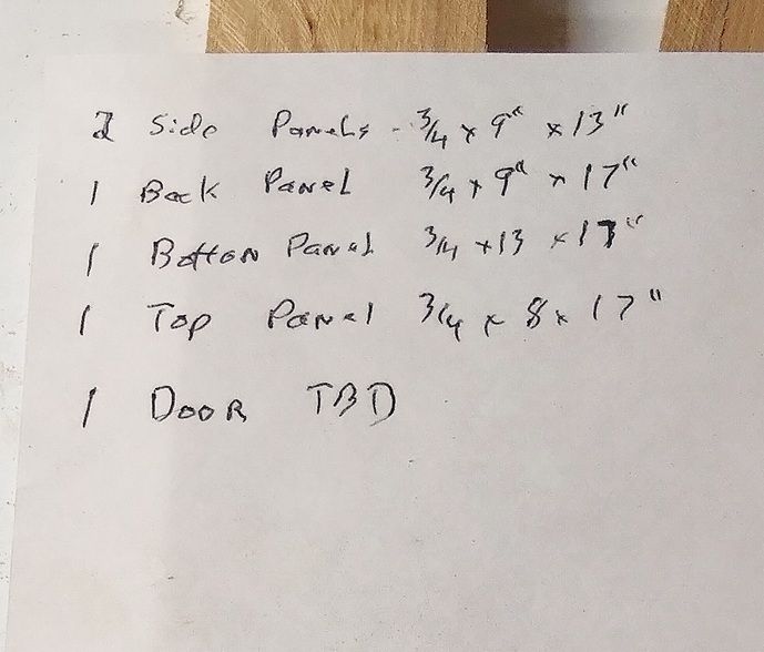

I did get the old Bread Box measured up...Moose & Squirrel Express has delivered a cut list, of sorts...
Cut list...:ChinScratch:

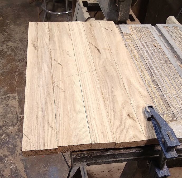

Bottom panel will be made from Soft Maple,  the rest out of resawn Ash:OldManSmiley:
Parts for one side panel, and..:Cheer:
Parts for the other side panel...:TwoThumbsUp:

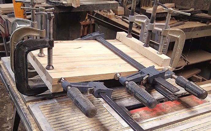

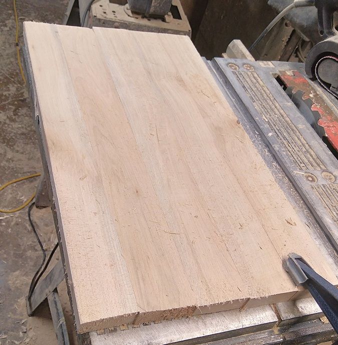

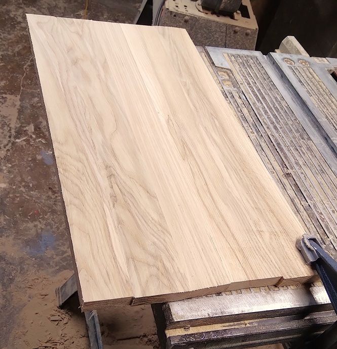

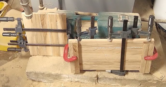

Back panel has been glued up...:ChinScratch:

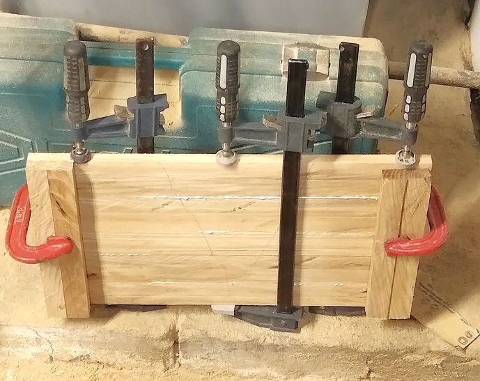

One side panel has been glued up...and...:Cheer:
The other side panel has been glued up...will let all 3 sit a day...:Tapping:

Ok...Single Brain Cell Sketch Up...has come up with a Plan Revision.:OldManSmiley:..That "back panel"?  Is to be the door of the box...New Back Panel will be Soft Maple.   Base will also be Soft Maple...Sides will still connect at the corners, with 1/4" wide Finger Joints...Top will sit in a groove in the back and 2 sides, ending where the slope of the door is.. Have the bevel the edges of both the "Top" and the "Front" to allow the door to settle in place..Door MIGHT get a 3/8" Overlay as well..we'll see how things go..:ChinScratch:

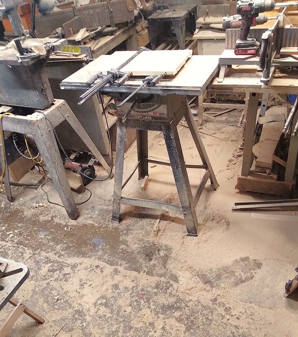

Just that the tablesaw was busy..
And, I was too sore to take the time to sweep the place...

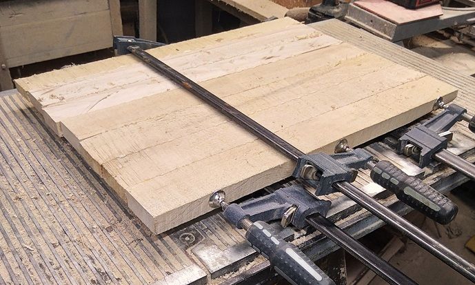

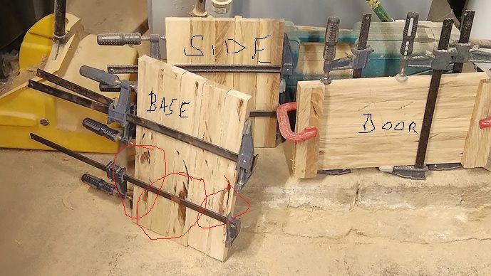

Clamps have been removed..:TwoThumbsUp:
It would appear that I need to work on getting these flat?:ChinScratch:

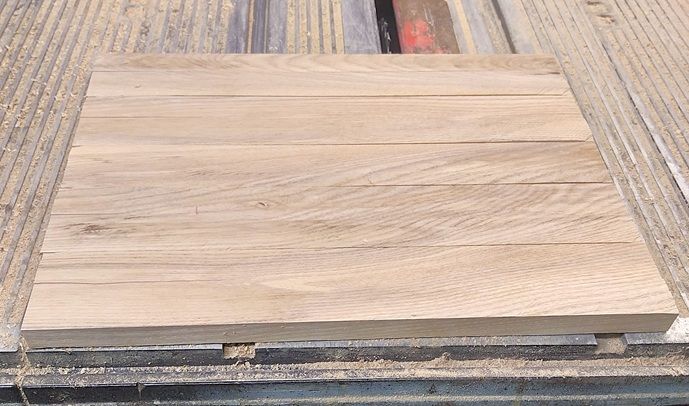

Panel for the Base has been flattened...not smooth, but it is flat...50 grit sanding belt...taking too long..:Tapping:..may get a few at 36 grit...as I have 4 more panels to flatten both faces on.:ChinScratch:..My back said that was enough for today:ArguingSmileys:..waiting on the dryer to get done....hopefully I can haul the Hamper back upstairs...:WonderScratch:

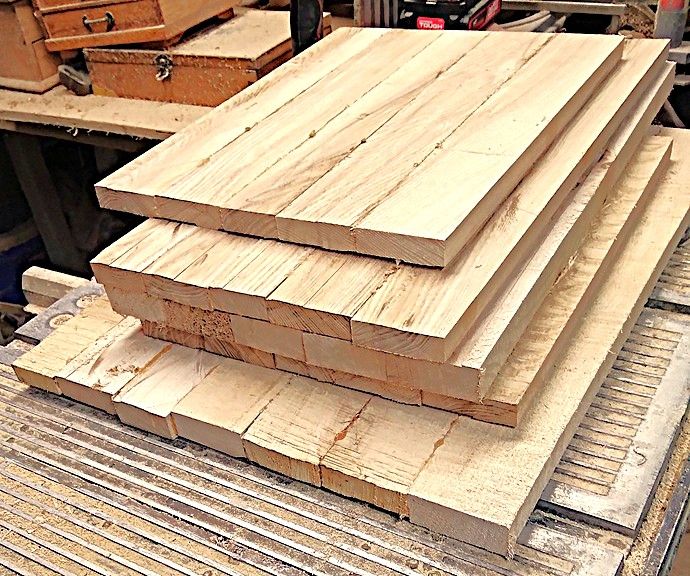

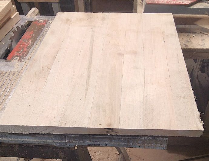

One done..

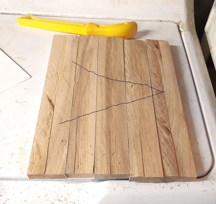

This is to be the base of the Bread Box...7 pieces of Soft maple, trying to look like a single plank...

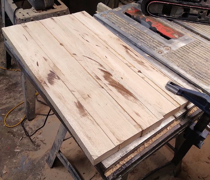

Well...50 grit was taking way too long, and the beltsander was trying to overheat...so..:ChinScratch:
Trip to Harbor Freight, bought a 3-pak of 36 grit belts...and gave them a try..the "Before":JawDrop:
Panels need to be sanded flat on BOTH faces,,and then, the "After":TwoThumbsUp:
Same with the Ash panels..:ChinScratch:

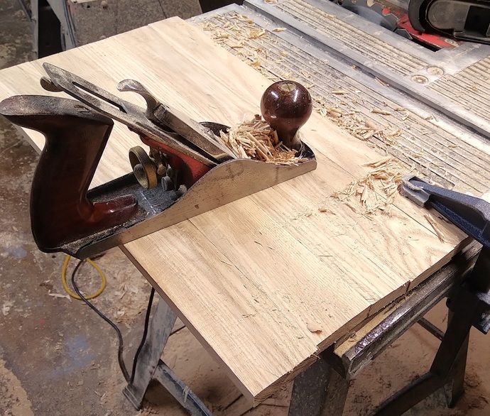

I also used a handplane in spots..:JawDrop:
Taking down any speed bumps...:ChinScratch:

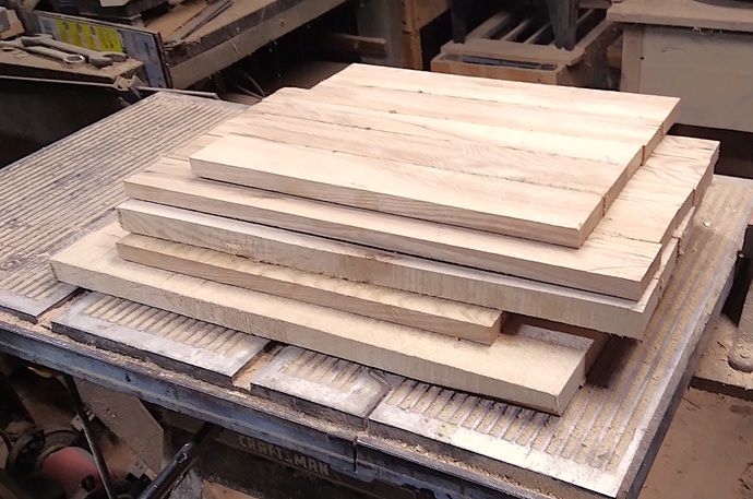

Got all 4 panels leveled down flat...went back and smooth all 5 panels out at 80 grit...Then cross cut things to correct size..and ripped to correct width...:Cheer:
I even cross cut the Front and Top pieces to length...then stack the mess up..for now..:TwoThumbsUp:
And they can sit here, until I get ready to start the Joinery stuff..:Tapping:
