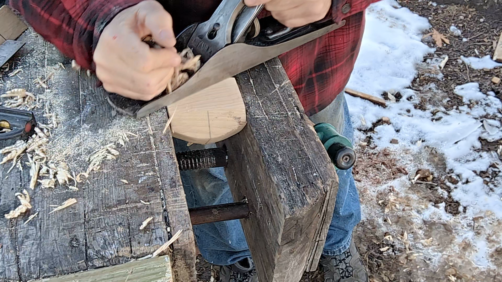

I have some Black Walnut from an old barn. Not really enough to build much of anything, but I think it'll be enough for this. But it needs paint removal and flattening, etc.
So after clamping a makeshift stop, I get busy.
Snow is going away, and I could not be happier to watch it leave.
Dealing with some cup and bow.
Making progress.

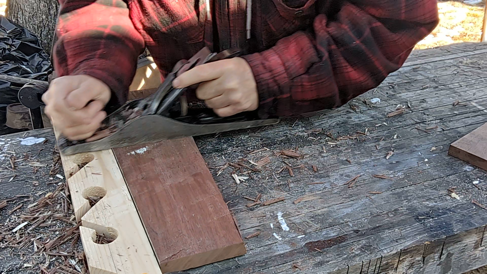

    Sneak peak     Drilled a few holes       And one big one.

Trueing up an edge.

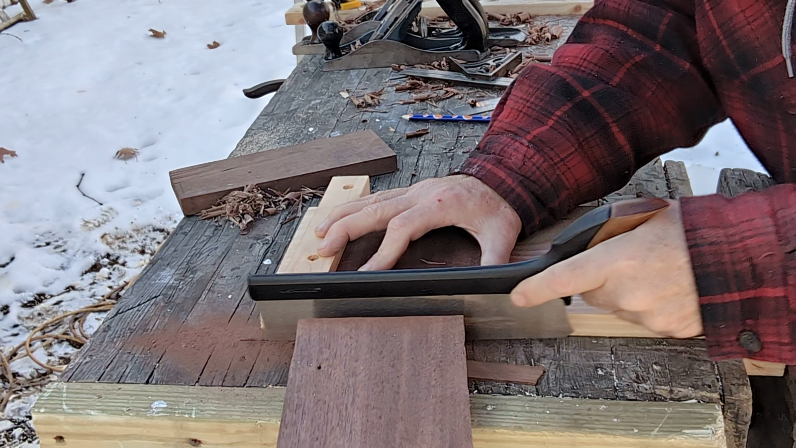

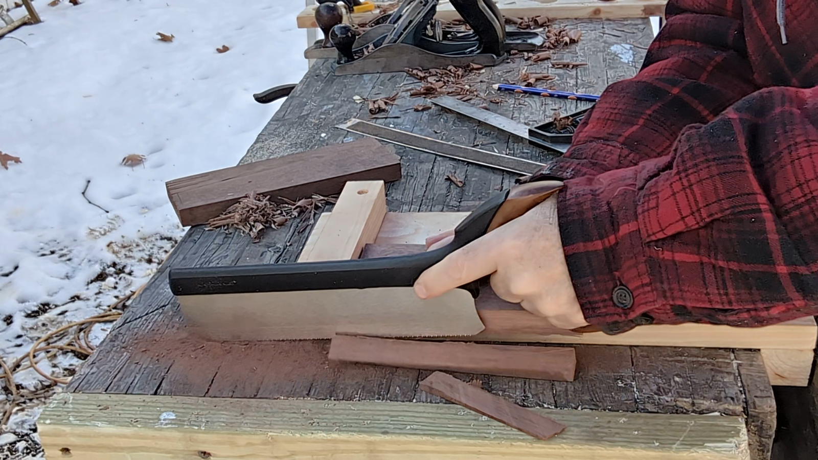

Laying out for the base.
And cutting to size.
this router will be 7 inches wide. I know, pretty small. But I don't have room in my chest for a large one, this one will be a snug fit.
Cutting to length...
And to a depth of 4 inches.

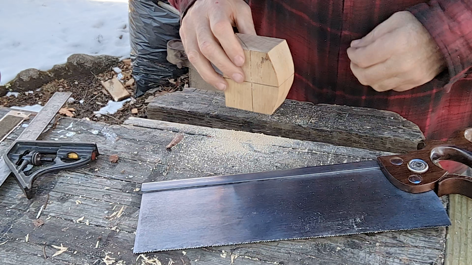

True up the edges.
I have some White Ash. It's an offcut from a guitar body blank I long ago cut the body shape from. I never throw hardwood away. The curve on this piece is just what I'm looking for.
More to come. Thanks for looking at my thread.
 Thanks for taking us along for the ride:TwoThumbsUp:
Thank you.

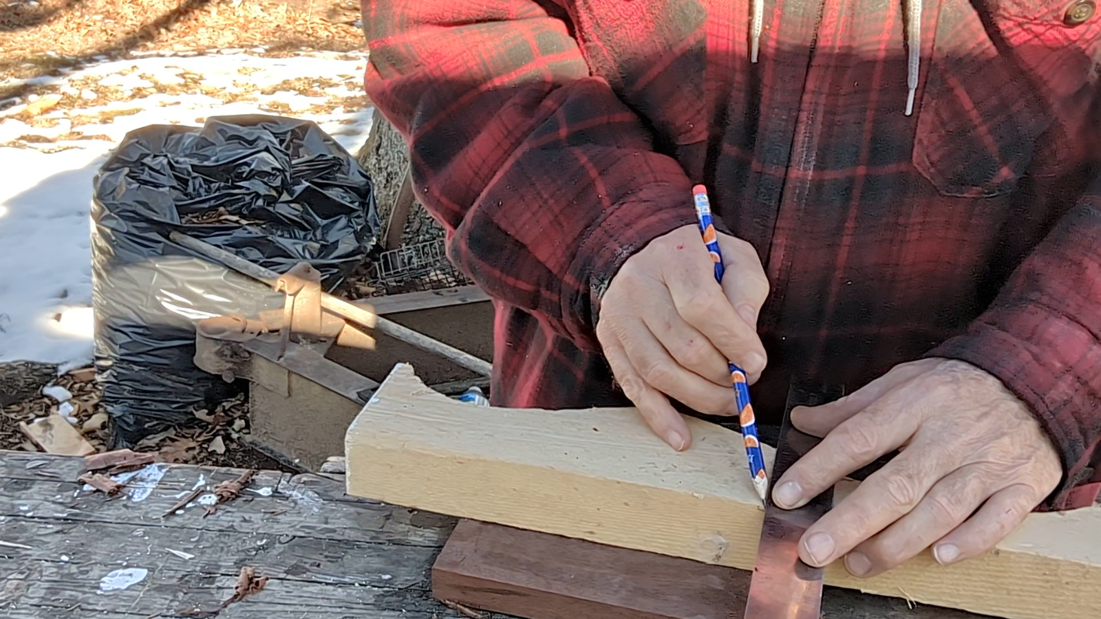

Ok, so, mark out the piece I want from this.
And saw away the rest.
Aaaand, whack off the other end.

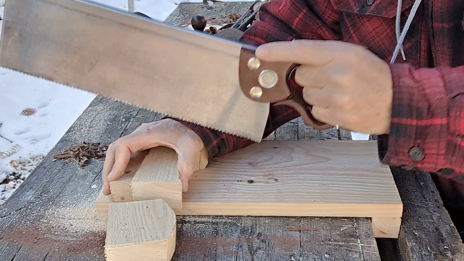

So now I need an angle. I chose 45 degrees.
And then it gets the saw.
Flip it over
Saw from the other side
And we are through.
Plane the face flat.
Check for flatness
