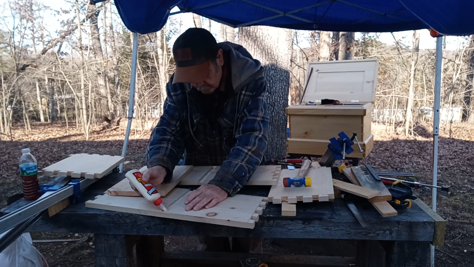

Definitely tails first. I tried pins first once, but it’s hard to get in there and mark the tails out.

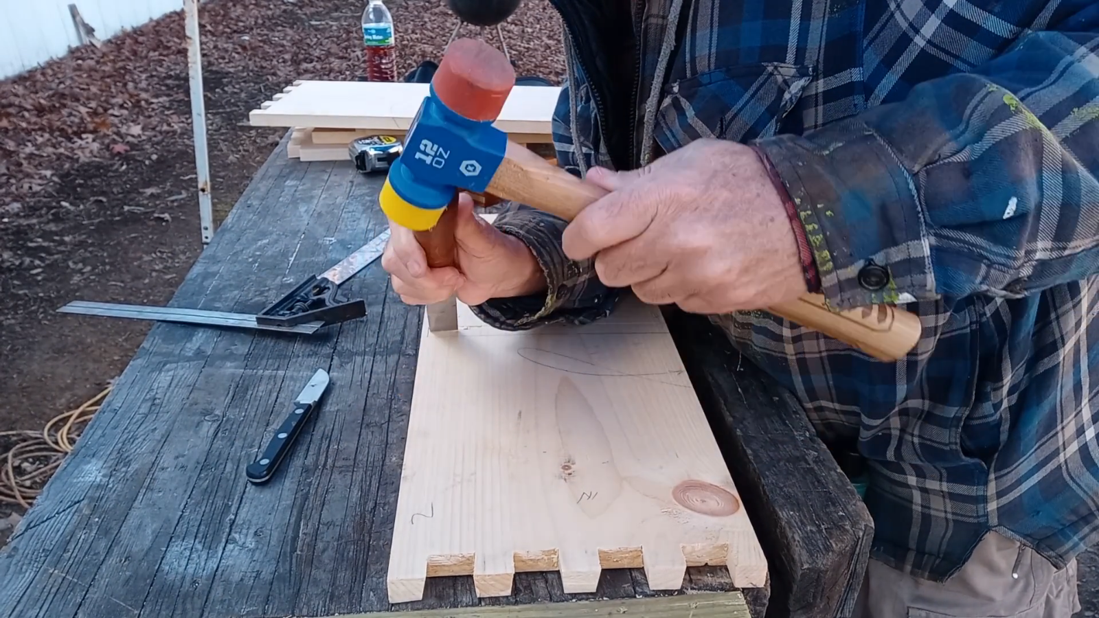

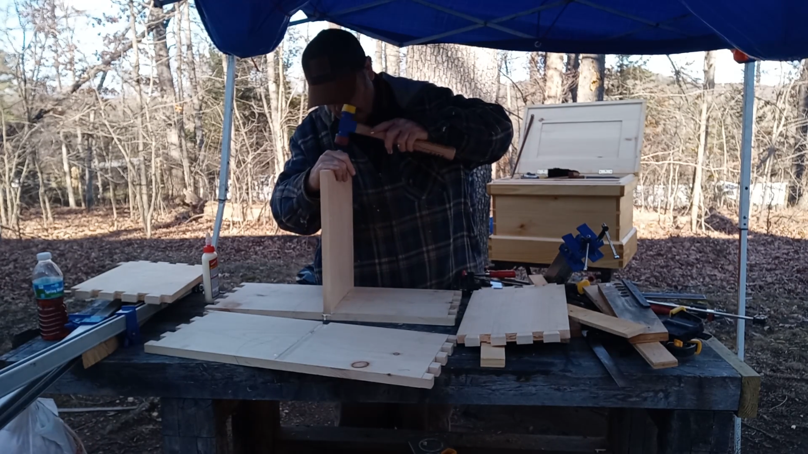

    Tap em on home, then rinse and repeat for the other three corners.     I'm happy with the fit, mostly. That's all for today. It's raining like I should be building a boat ins
Hmmmm...

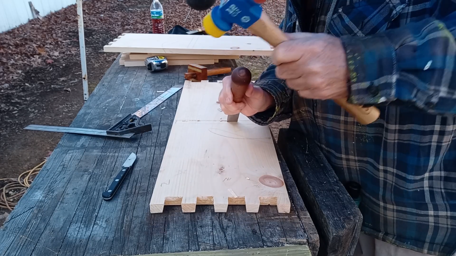

When one needs a block and a mallet to dry fit tails into pins...

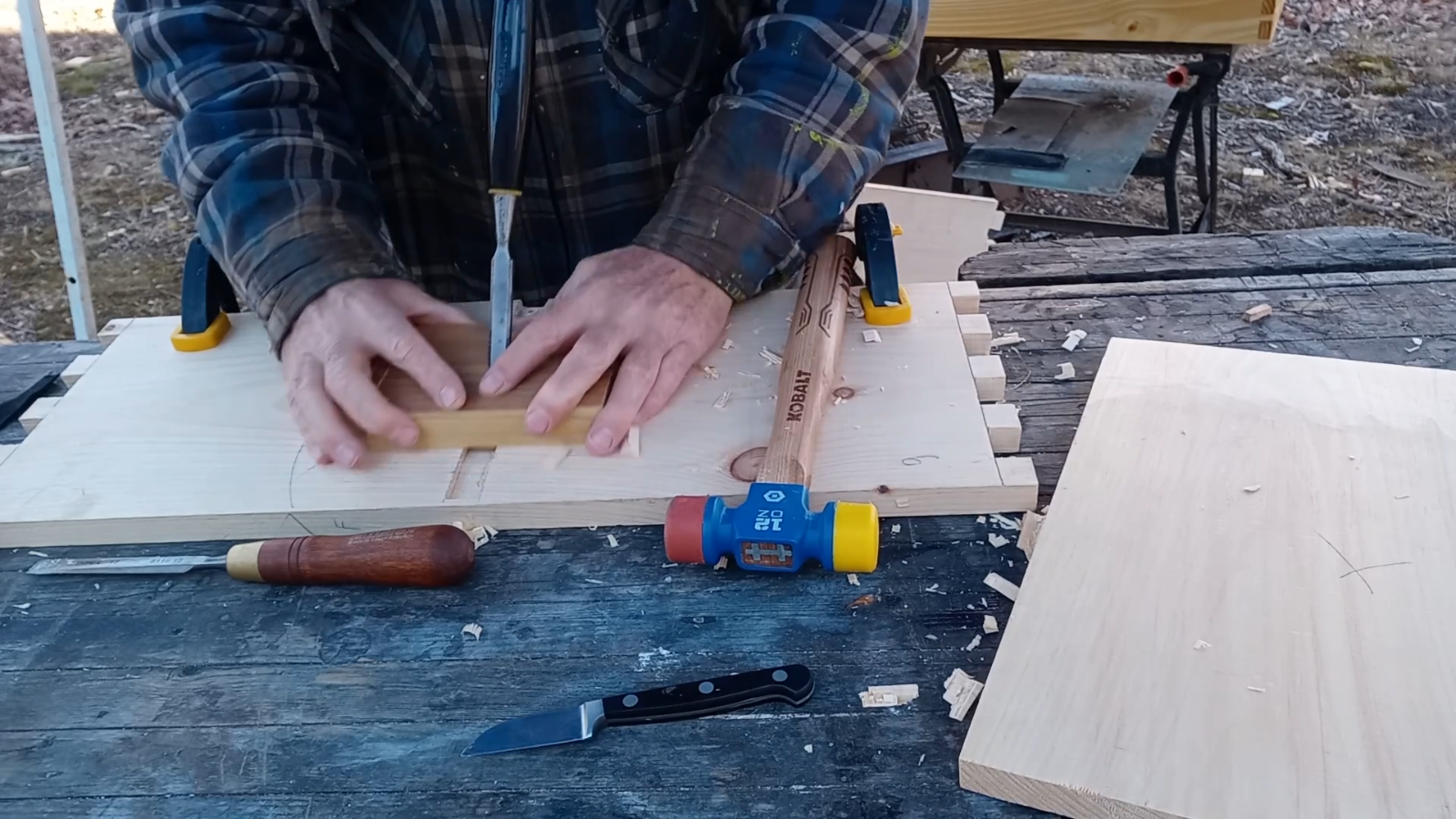

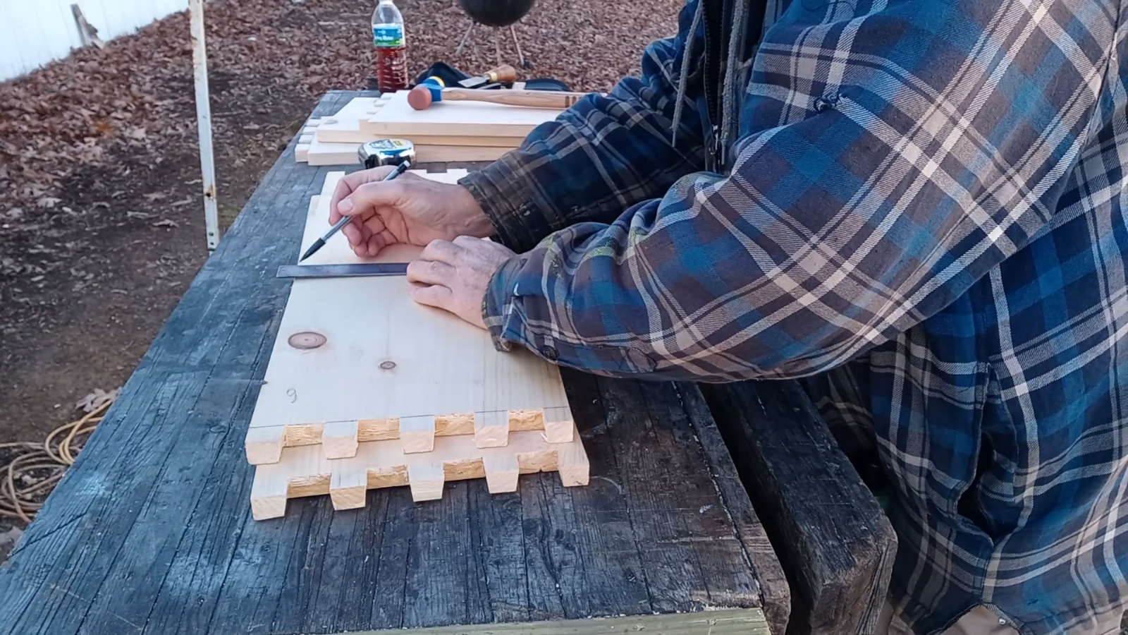

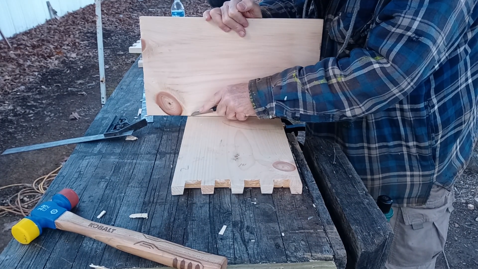

When the pins are done, I stand the "pin board" up and place it on the Tail Board....a SHARP No. 2 pencil is used to trace around each pin.  I then cut on the "waste" side of those lines, trying to leave the lines intact (trying being the operative word)....Figure I can pare a bit IF the fit is too tight...

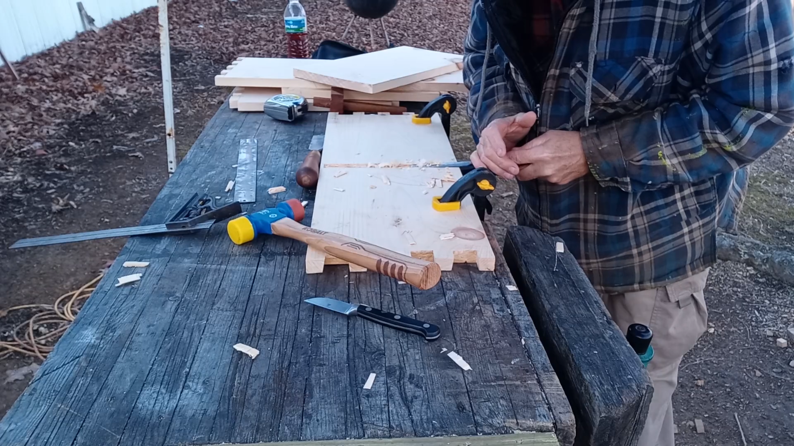

Time to cut the dado for the single shelf of this project.
Mark the line which delineates the location of said shelf....pat23.png.68b4fea4d73db477ba2a1c4cf3da6485.png

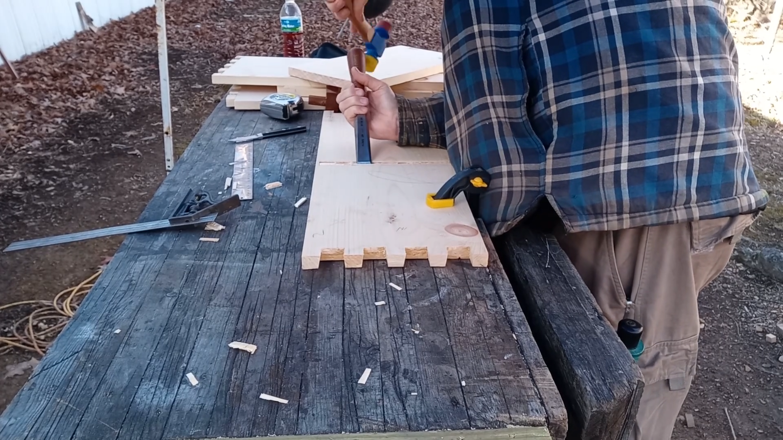

And get choppin'.
After which I lay the edge of the shelf against the knife wall I chopped out....pat26.png.0e0c8a310d9e0e557ff81e28ac585291.png
...and after marking that line, time to chop again.
pat27.png.77215fb385db17d49642803ca459fa55.pngpat28.png.c3d2c59718d64173523df4e15fdff988.png

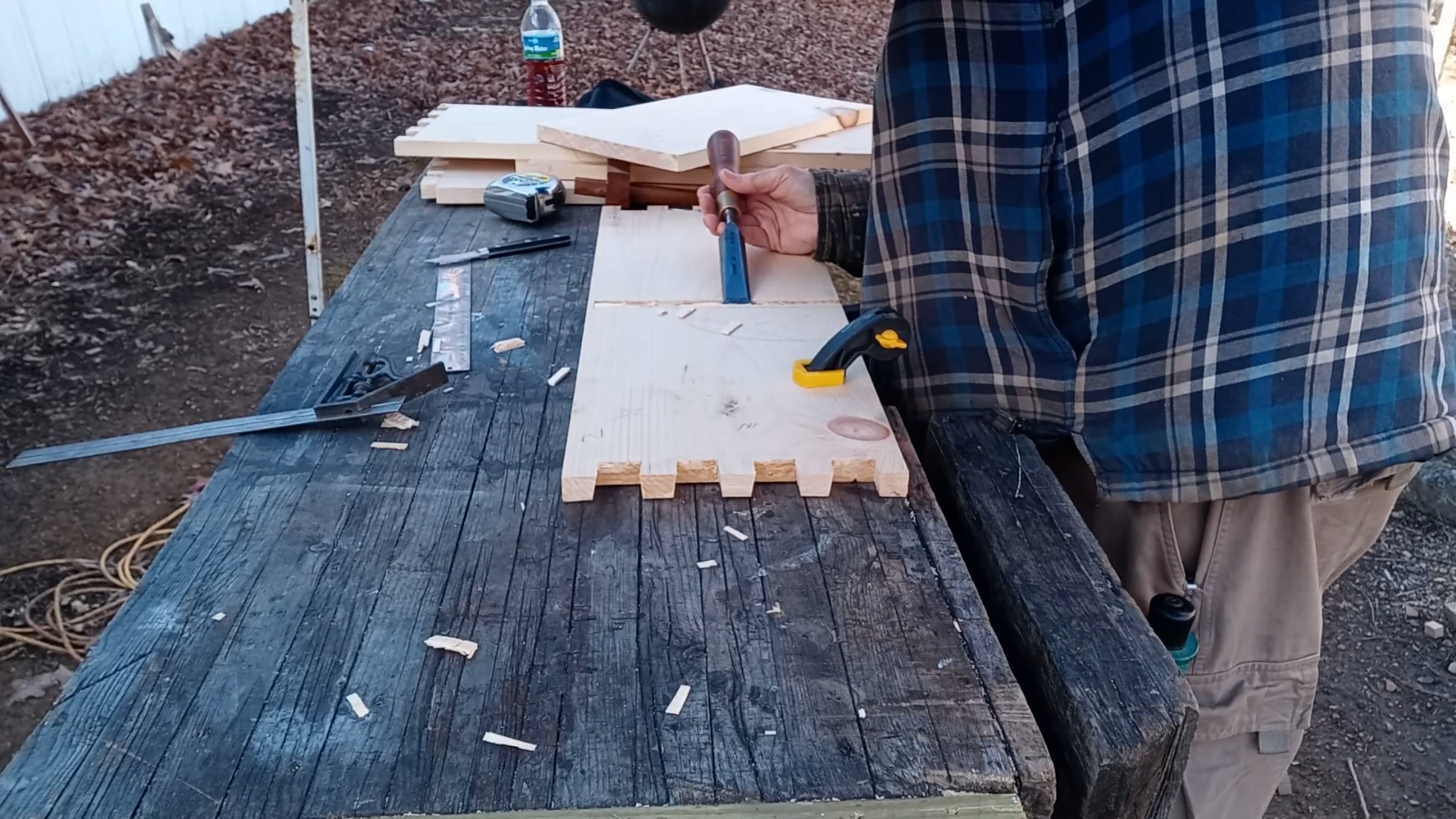

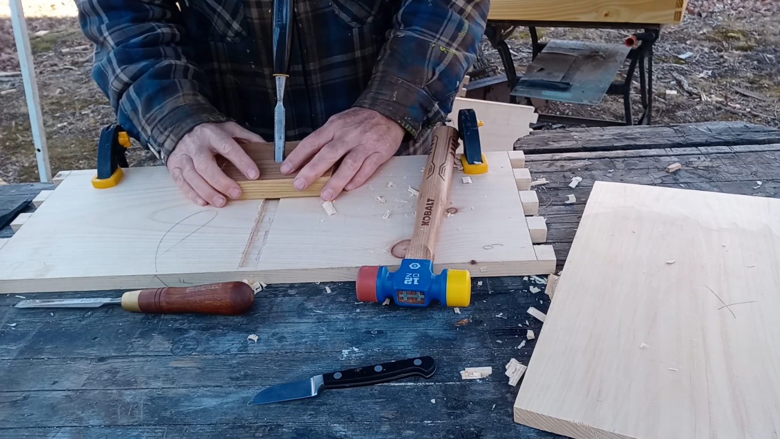

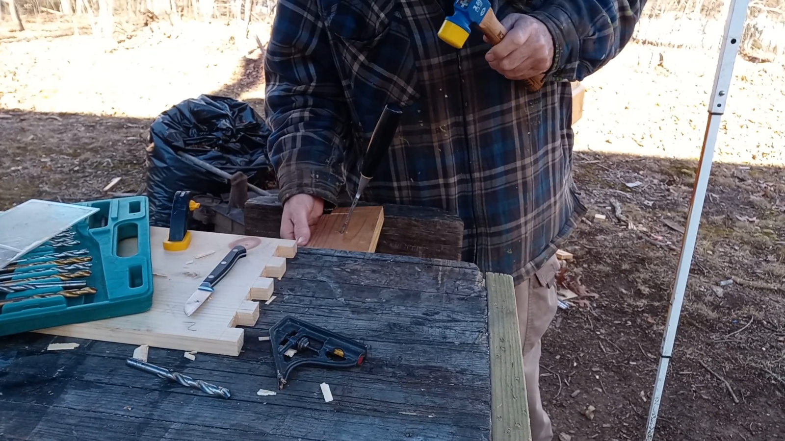

Pare most of the waste away....

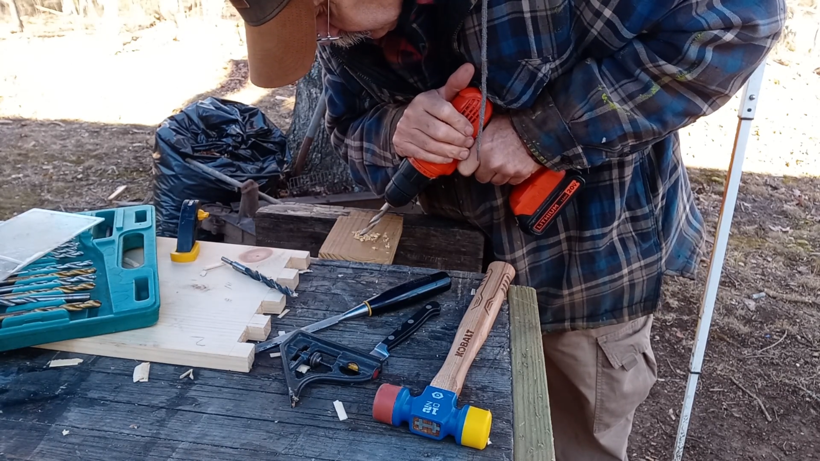

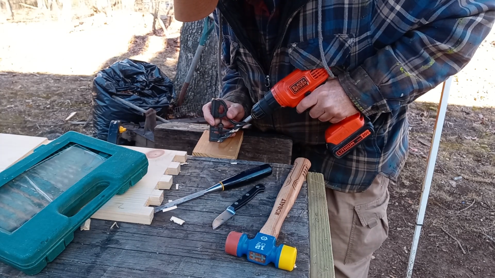

Since I don't have a router plane I grab a hunk of wood I got laying around, and using my combo square I select an angle slightly more than 45.....
And start drilling.
Hammer a 1/2" chisel through it...pat31.png.e840411625bb65ad1eb2413571b99c31.png
And finish up the dado, which I repeat on the other side board.

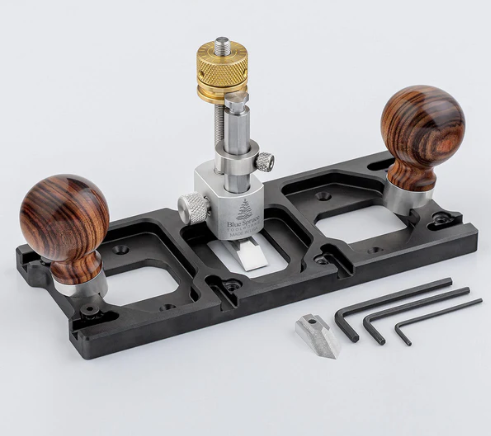

Yeah, that ain't happening. But i might pick up something like this in the future. Right now my budget does not exist. Winter is here and the electric company will take anything we have left over.
It's mde in China, and is certainly not a fine woodworking tool, but if i get a router plane it will be something like this. Until then I'll keep shving a chisel thru a 2x4. It works. Lack of tools will not stop me from building. Never has, never will.
https://www.amazon.com/Router-Plane-Handheld-Woodworking-Tool/dp/B0D7ZSSK68?crid=297L4D609RUNX&dib=eyJ2IjoiMSJ9.ibpZ6z9YKpR5lAmoel-g6XkoX3D21eICHwmnc_s6wnZLHjWx5sno2C5-HBpEhan-2rdgWNtoalr6xgViJYfTytHJkLr8KDQmALfMAef4959bi5Dkgigi1MUHWnB5cSAD4QS2jnJxd2BLpQBYN9gUc8Y0WIinlwC_j8NgmMmny6onrzrnk8z680S_tZIxFGK0jj9-O2S9Z4CRXmuB_ffHaRUo2HlBYbG3iIF8GlvZbSxb9be4ujx_tfQnIxKSpzdyY1K2zdKGvtD0IjdRPxCmc_2CM6LZ9b6hTGrb1_wsk3-LR9JSSYyVicb42tIM6W4WvgutrZdwOQbDKjxoshIz4BCdgoMCG-AfIvz1NaaX27E.3NYg-c73AKCmQaR1In0KXphIgwBvQa16lrpmZr98r1k&dib_tag=se&keywords=router+plane&qid=1736272176&s=hi&sprefix=router+plane%2Ctools%2C114&sr=1-3
Ebay. It’s where I get all my old hand tools. 100 + year old Stanley tools are better than anything made today (aside from Veritas or Lee Valley) and you can pick them up all day for a song. They usually take a little work to get into shape but I’d rather do that than buy anything from China.
Here are some on eBay. Looks like the Stanleys have gone up a lot since I bought mine.
$69.99
on bids at 14.95 now
$55 and looks good
