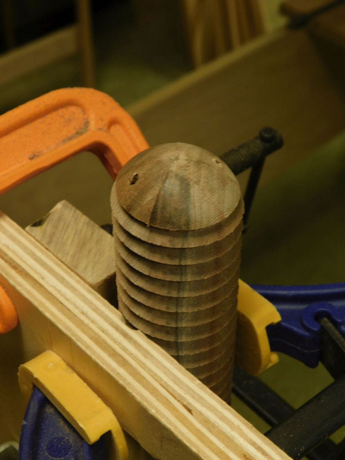

This will be the center post of a small table project idea I have.  Left and right threads, 45 degrees, walnut, on my radial axis.
I've ordered a side cutting V bit that hopefully will cut the inner threads of the nuts.  I'll post the final project if it actually works out.
Took some brain scraping thoughts to get the toolpaths made.  Used the rounding gadget in Aspire to turn a 1.5" square block into a .15"d cylinder. Had to play with the feed speed to get a good spiraling cut with the V-bit.  Some harmonic vibration as the bit got closer to the center which I dampened with my hand under it as it slowly spun.

  • Rounded over the ends of the posts.  Wanted to use the moulding toolpath but no matter how I set it up it threw an error.  So I modeled the ball end and cut it as a 3D model. Holes are wher
Holes are where the screws went into it through a hex block that was held in the 3 jaw chuck.  Other end has a center hole where the tailstock center held the end. If I can find a 1/8" diameter section of walnut dowel I'll patch the holes.  They aren't critical to the design and wouldn't be seen, but I'll know they are there and that'll bother me a bit until I'm finally forget about them.  ;)

I could not find anywhere on the web that would sell me 1/8" diameter wood dowels.  Looking through a cheap plug cutting set I have I found one that claimed to be for 1/4" plugs but in use it made plugs closer to 7/32".  Made a few in the end grain of a walnut scrap, then found a drill bit that would make a snug hole for them.  Drilled out the screw holes and plugged them up.
