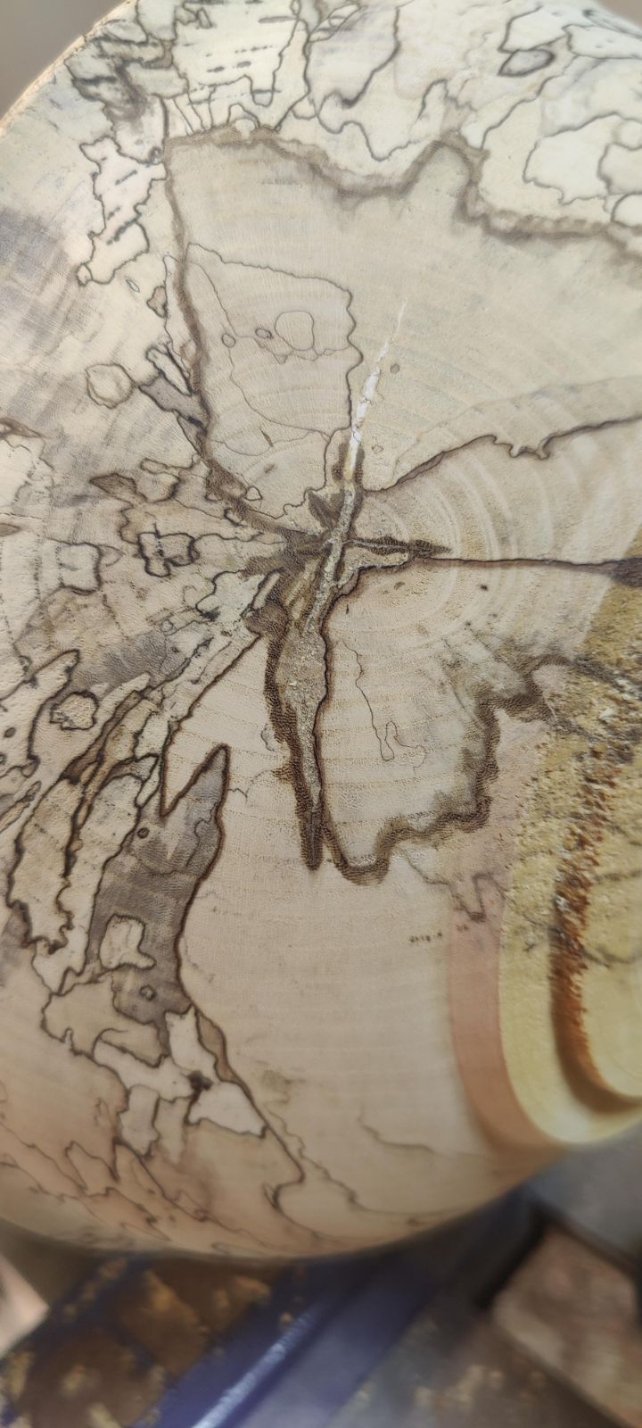

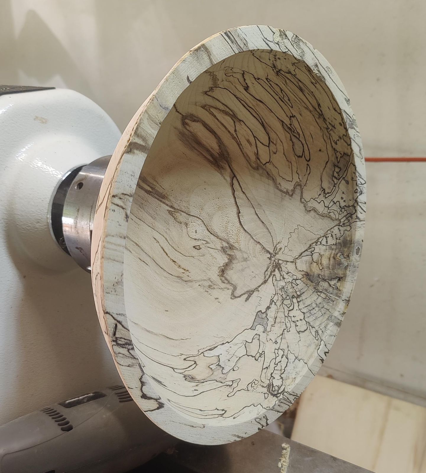

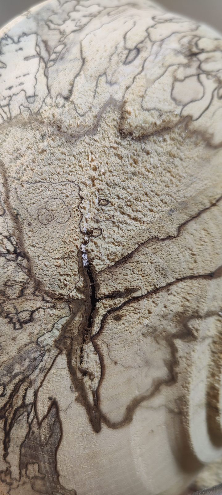

August 28, 20242 yr Popular Post comment_341316 Man, I hear you on the heat. I had this really punky piece of sugarberry on the lathe when it was cooler. It tried to blow apart, but I saved it. After I glued it up a bit it got hot outside, so it's still sitting there waiting for me to sand it. The pictures are out of the order I wanted. The last picture is the bottom of the bowl after roughing it out. I soaked it with a 1# cut of shellac, sharpened my 1/2" gouge, and took very thin cuts. The next to last picture is after that process. As you can see, it smoothed up pretty durned good. Anyway, I hope this still makes a nice bowl. I'll get back to it when it cools off. Edited August 28, 20242 yr by kreisdorph Report

August 29, 20242 yr comment_341360 14 hours ago, lew said: @kreisdorph I use thin CA for that. I haven't tried CA because I haven't wanted to deal with the discoloration. On a spalted pith like this one, it probably doesn't make one iota of difference. What's your experience with CA re discoloration? Report

August 29, 20242 yr Author comment_341367 1 hour ago, kreisdorph said: I haven't tried CA because I haven't wanted to deal with the discoloration. On a spalted pith like this one, it probably doesn't make one iota of difference. What's your experience with CA re discoloration? As you mentioned, on the spalted pieces it is not noticeable. For smaller pieces, I usually cover the entire turning. No one can tell where the CA has been applied Report
August 29, 20242 yr comment_341370 10 minutes ago, lew said: As you mentioned, on the spalted pieces it is not noticeable. For smaller pieces, I usually cover the entire turning. No one can tell where the CA has been applied I suspected as much. Thanks. Report
