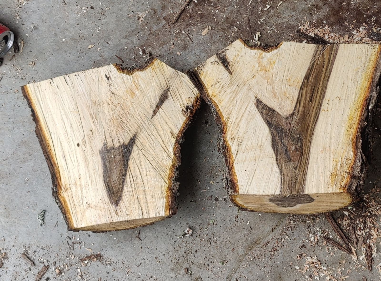

I had another piece of this stuff so I thought I may try to play with it. What I don't know is whether that's possible...especially after I trimmed it down a little, maybe i screwed the pooch with my trimming. Anyway, the first 2 photos show the front/back if you will of what i started with. Thinking I needed a flat surface on one side, I slabbed some off to give me just that. Then I cut a little off one end to "square" it up a little. So that's what I have left. I was thinking about a small platter or shallow bowl showing the crotch of the branch coming off of it. The piece I have left is about 6 1/2" tall (long grain) and about 8 1/2" across at the branch stub. Without any direction at this point I might try to put a worm screw into the flat part centered across the 8 1/2" dimension and try to round it out some and put a mortise in the other side to accept chuck jaws. But maybe i should just put this on my brush pile to burn. Advice?

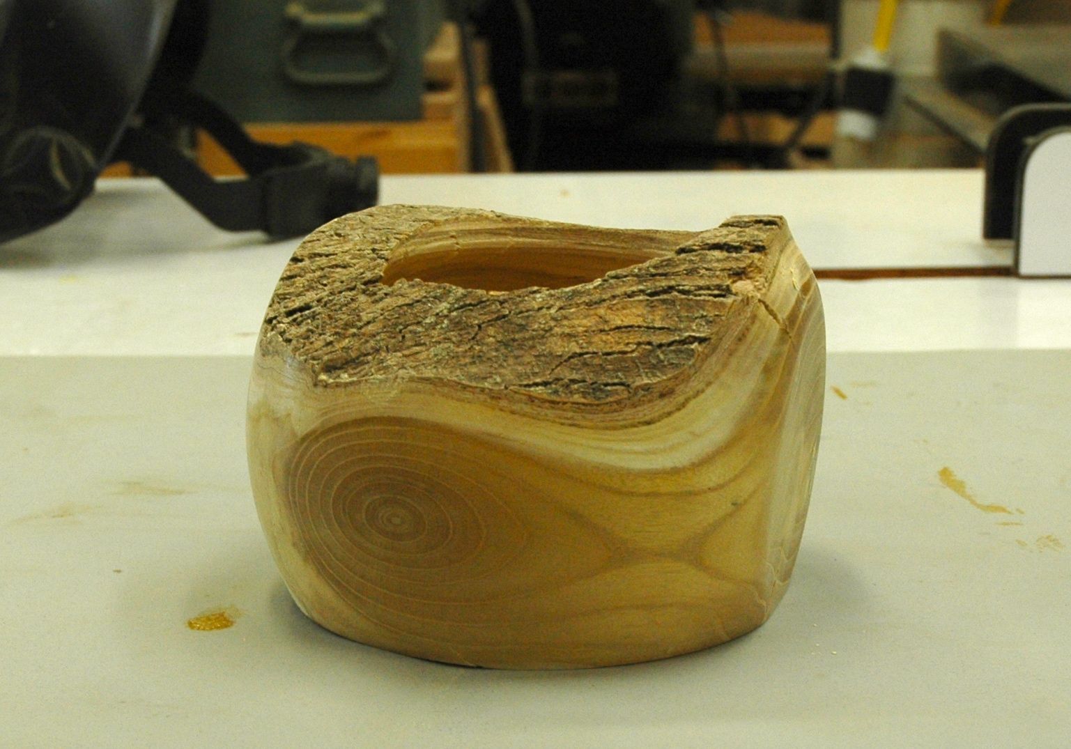

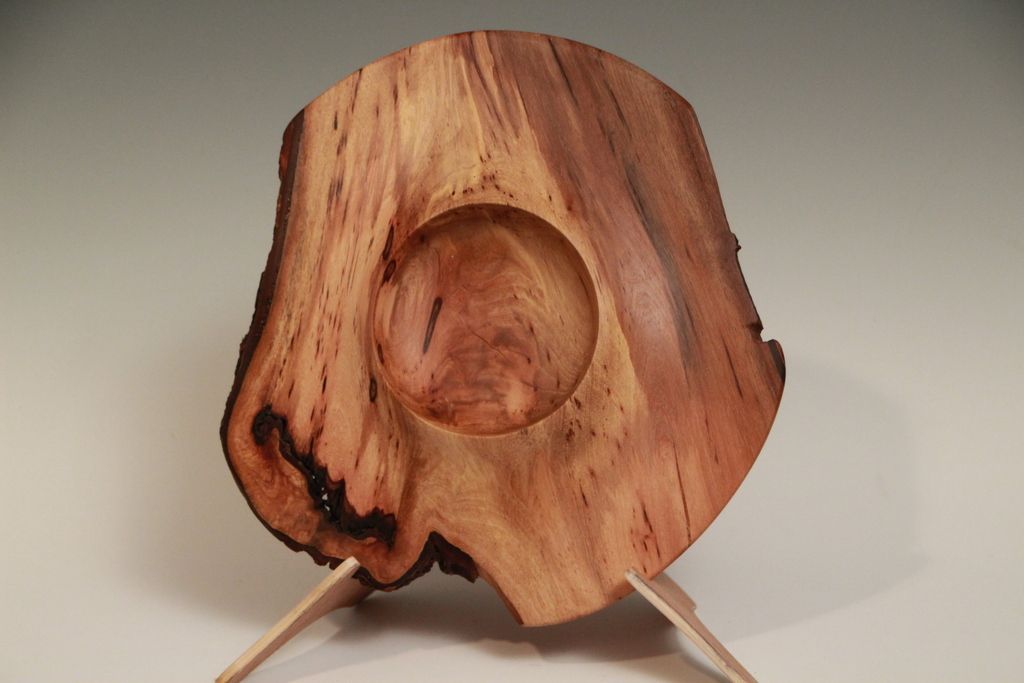

  • I hope this helps. My friend had a walnut crotch. We cut it in half and cut the pith out. With my half I made the part where the pith cut off the bottom of the platter. The first picture is looking at

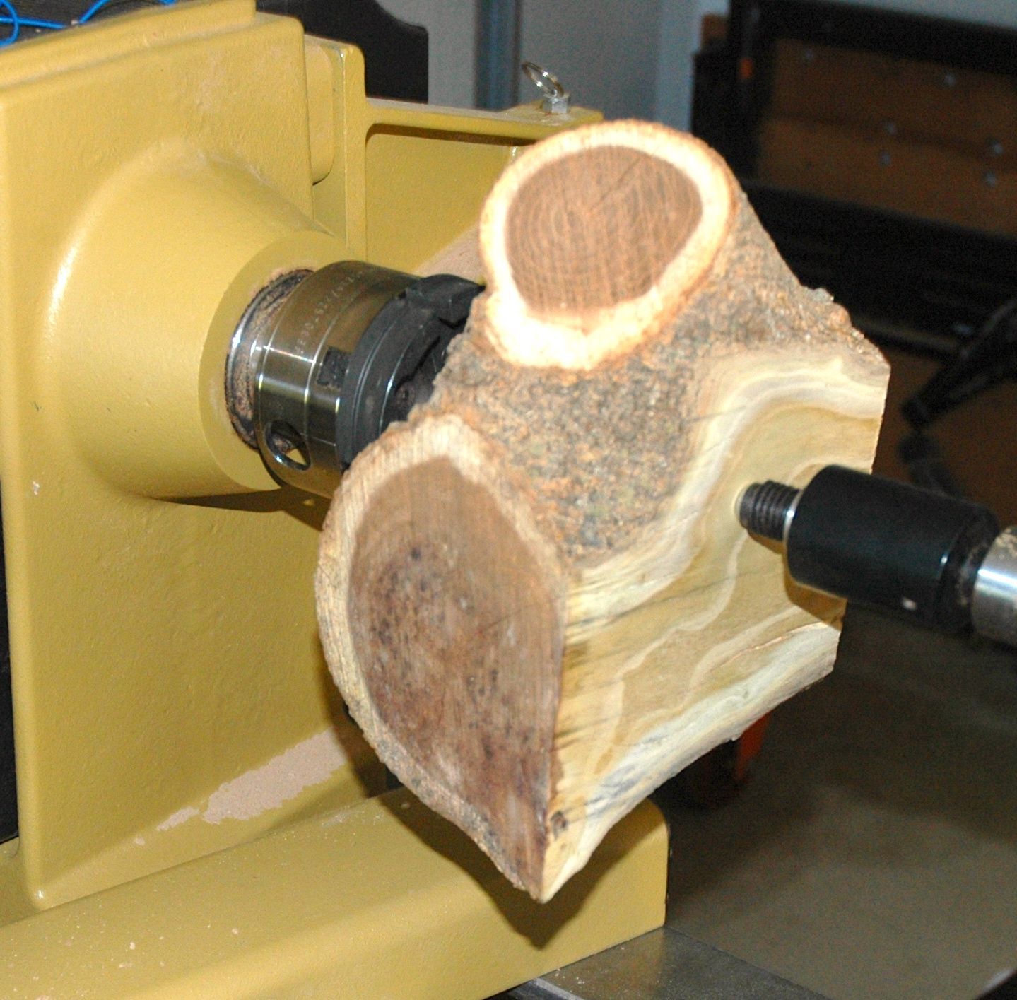

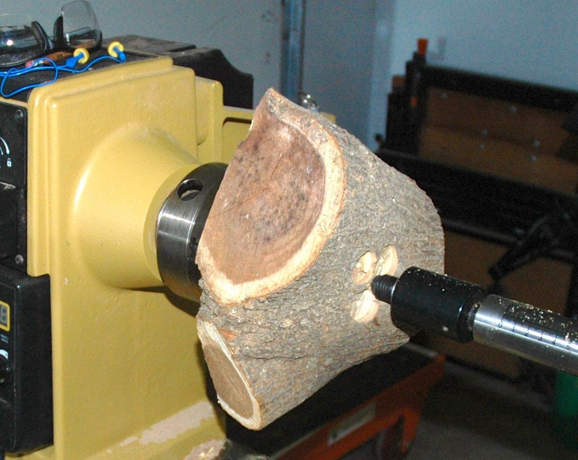

I would place the already flattened side on the drill press and use a Forstner bit slightly larger in diameter than your drive spur. Drill down into the bark till you get a flat spot. This should be located near the balance center of the piece. Mount it on the lathe and turn your tenon or mortice on the already flat side. Then reverse the mounting with your chuck. Now turn the piece from the bark side. That way you can leave some of the bark to for a natural edge turning
Lew, is this what you suggested? I cut a 1" spot on the bark side and put one of those EZ wood drive spurs (the kind the chuck holds), so now I can cut a tenon on the flat side....did I catch your meaning?

Exactly!

How does it spin? Off balance any?
Yeah, it's out of balance quite a bit, I'll be going slow until things smooth out....if they ever do. I guess i could try to reposition the drive spur but I wanted be centered on the crotch side as much as possible.

OK, being the wussy novice I am I did recenter the drive spur a little (twice actually) looking for a little better balance and got it improved somewhat. Then I was able to put a tenon on it and it's now in the chuck. After the white knuckle exercise of cutting the tenon I think I'll have to regain my composure before I move ahead. Notice I moved the tail stock up to do the outside edge a little.

No wussy technique there. Standard practice to trap the piece between the head and tail stocks for as long as possible. It is a really good idea to constantly check the tailstock to make sure it is firmly imbedded into the piece and tighten when needed.
Sorry I am late to the party. The correct way is to cut crotch thru the center of BOTH piths . Then for best figure mount with the bark toward the tailstock. Figure shows at the center of a crotch so this will put it at the bottom of the turning. This is a possible result.IMG_4616-001.JPG.16b1546efda7892cc46081deeec1c26d.JPG

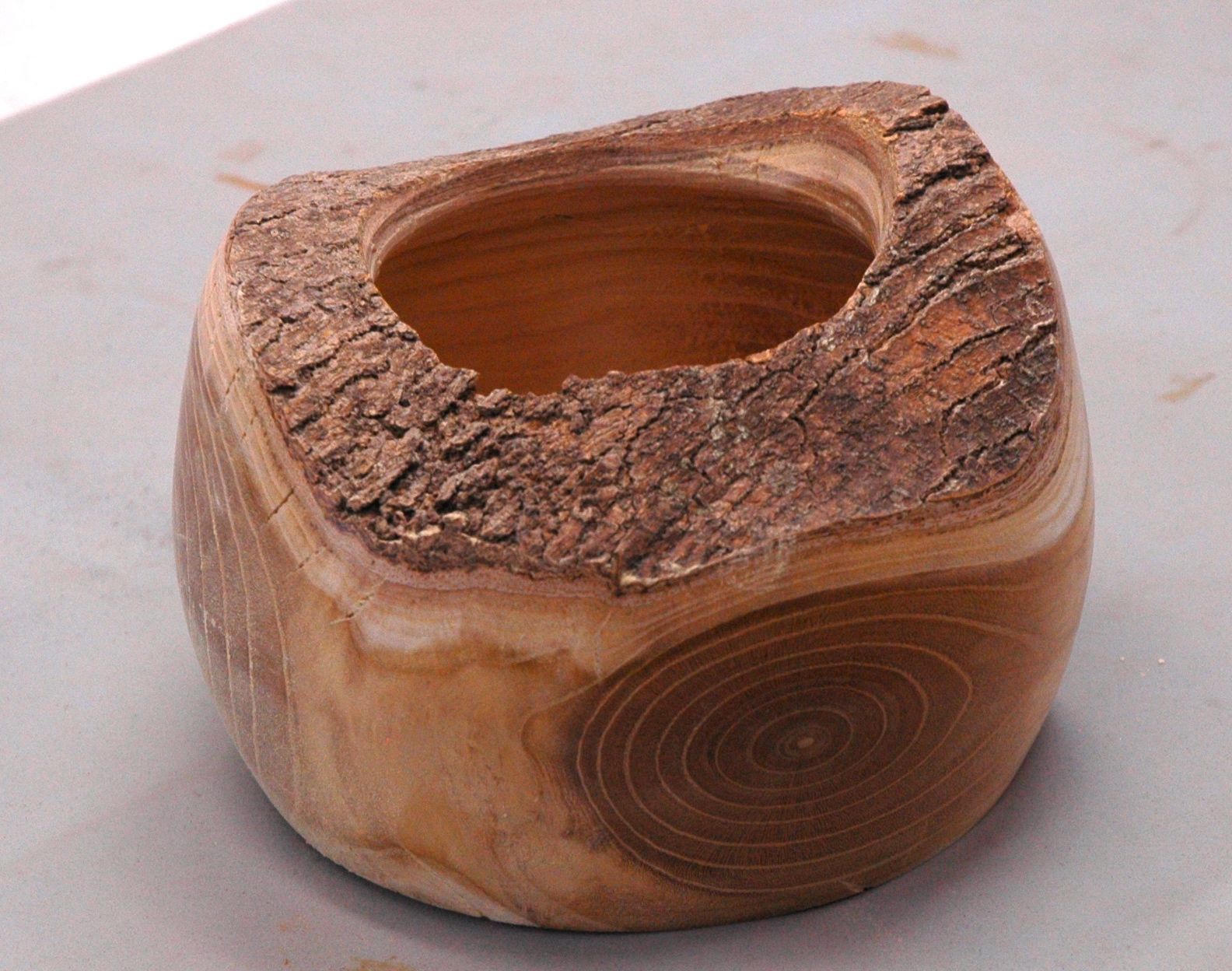

I do a lot of crotch bowls.
  • Small crotches. I turn these pith and all.
  • Medium-sized logs: I cut them right down the center. If the piece is on the small side, I might leave the pith in one half and use that part for the tenon. The smaller side will likely be waste in this scenario.
  • Large logs: Whole other kettle of fish.
I use a spur drive for just about everything. I'll usually remove the bark where the spur drive connects. On the tailstock side, I don't trim at all. Just keep removing wood until you get a good base for your tenon.
This walnut log was cut slightly off center as described above.
