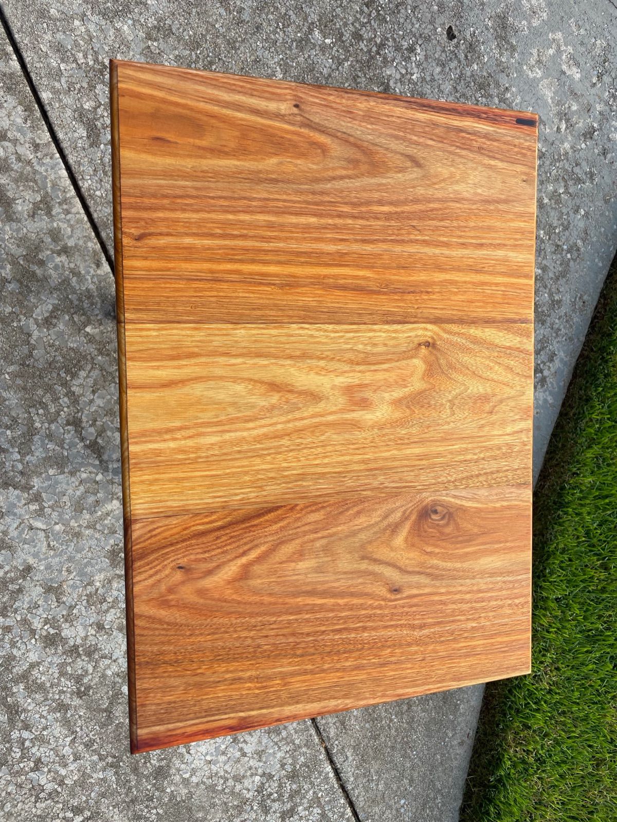

Got to start a new project
Well got to do some milling and glueing and clamping this morning!
Some Canary wood for some end table for the daughter….now comes the fun part… the sanding lol

It can be pricey. I got three boards 10 Ft long one inch thick 2 of them 9.25 inch wide and another 7.25 inch wide for 298 from a mill. Whereas I got this slab on sale in Charlotte that is 6/4 for 99.00. It is 4ft by 14 1/2.
this is my first time working with it but everyone I talk to enjoys working with it.
I’ll give ya my opinion when I am done. Lol
Update on the tables. Sanding and edging done. Going to throw on some Rubio tomorrow. Cleaned em up with Naphtha. Lighting is crappy florence lighting.
Finished the tops last night and the this morning. I used Odies oil Dark for the finish.

That is some gorgeous wood, Kevin!
Thank you Lew have admit I was pleasantly surprised lol
W0w! Some real beauties, there. Gonna make a couple gorgeous tables.
Beautiful grain. Your finish really highlighted and enhanced it. You should get 2 gold stars by the missus for these Kevin.

I liked working with it. The sand dust from sanding was kinda clumpy almost like a ‘wet’ feel. It almost has a unique smell. I would def be using it again!
Now I'm curious how easy/hard it would be on router bits or saw blades to cut.  Wood with high mineral content that look fantastic can be abrasive to tools.
