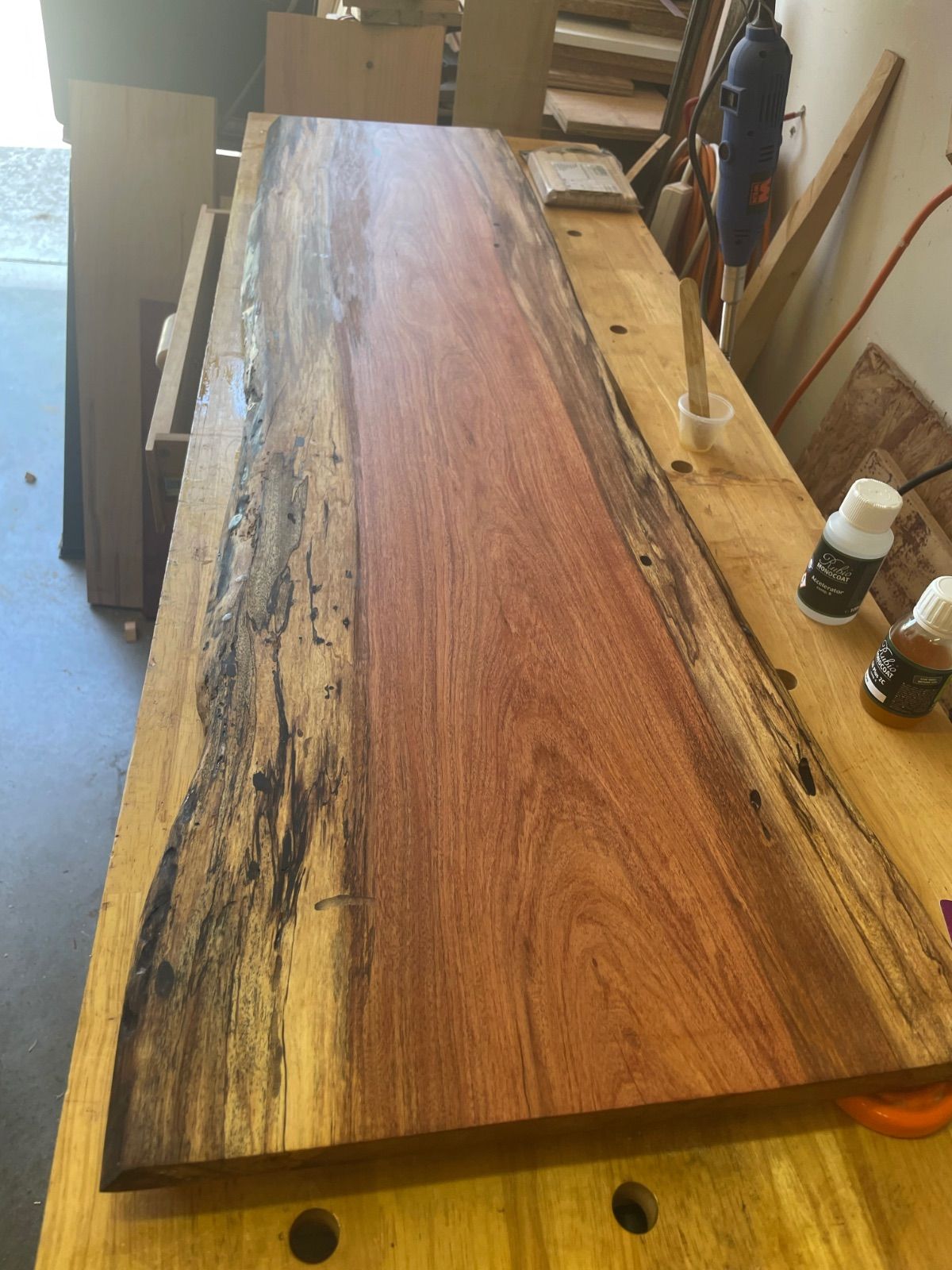

Hey everyone…back to finish up the coffee table for my wife and build two end table of canary wood for my daughter. I am going to try Rubio monocoat for all three pcs. I can not find denatured alcohol anywhere near me to wipe things down before applying the Rubios. Will Mineral spirits work as a good substitute?

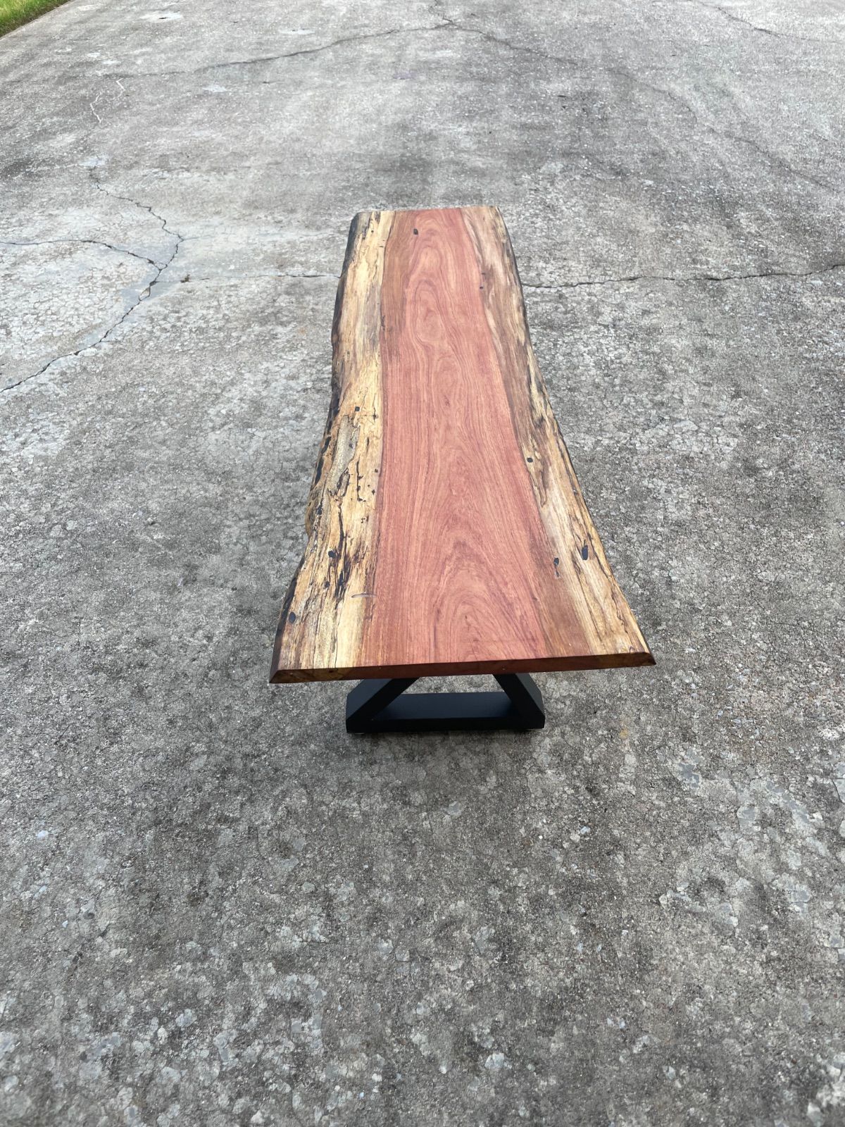

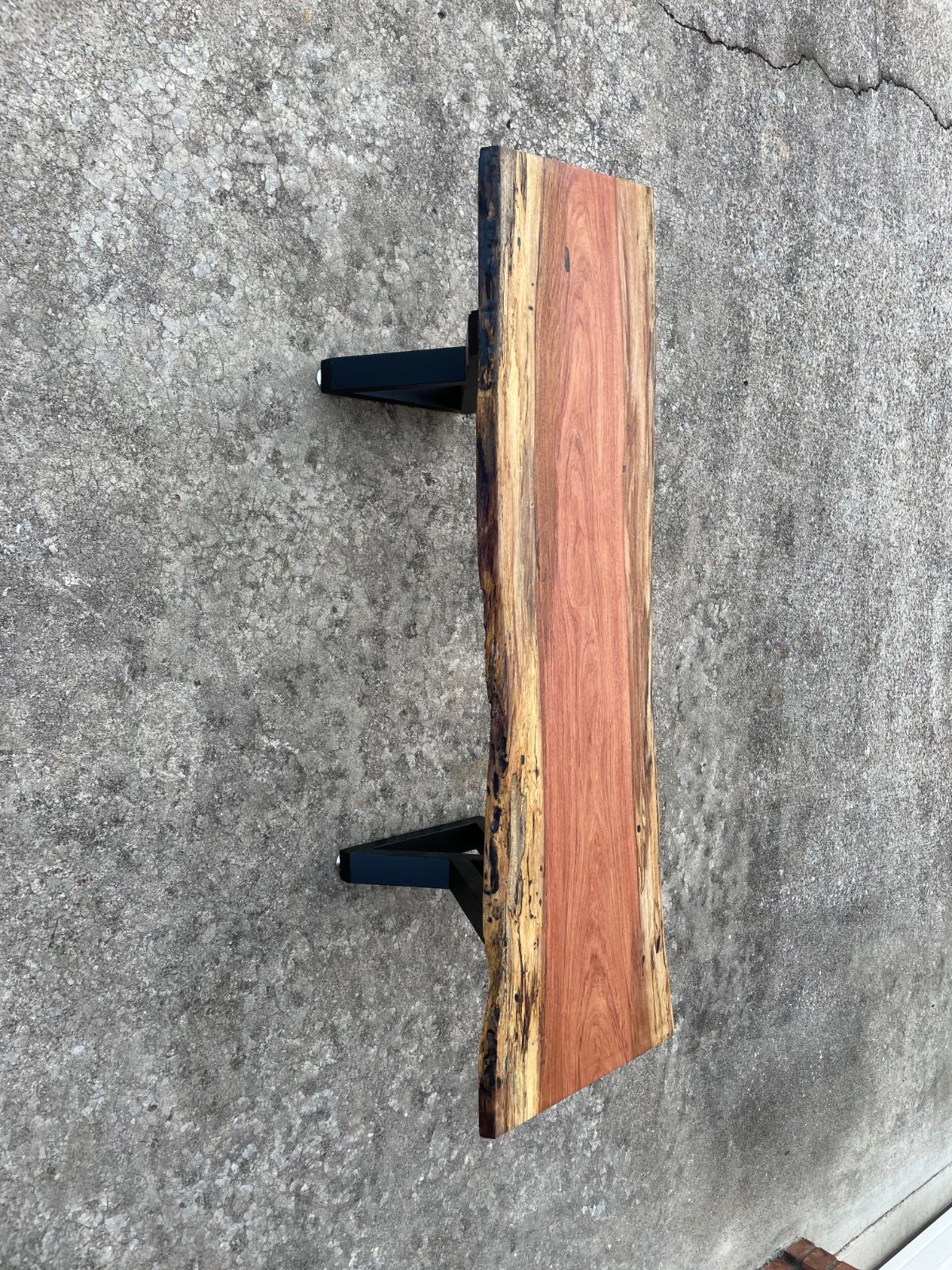

  • Here is the finished product. Single coat of Rubios and legs attached
