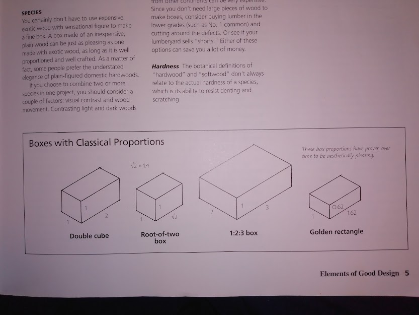

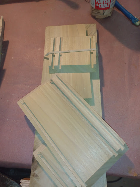

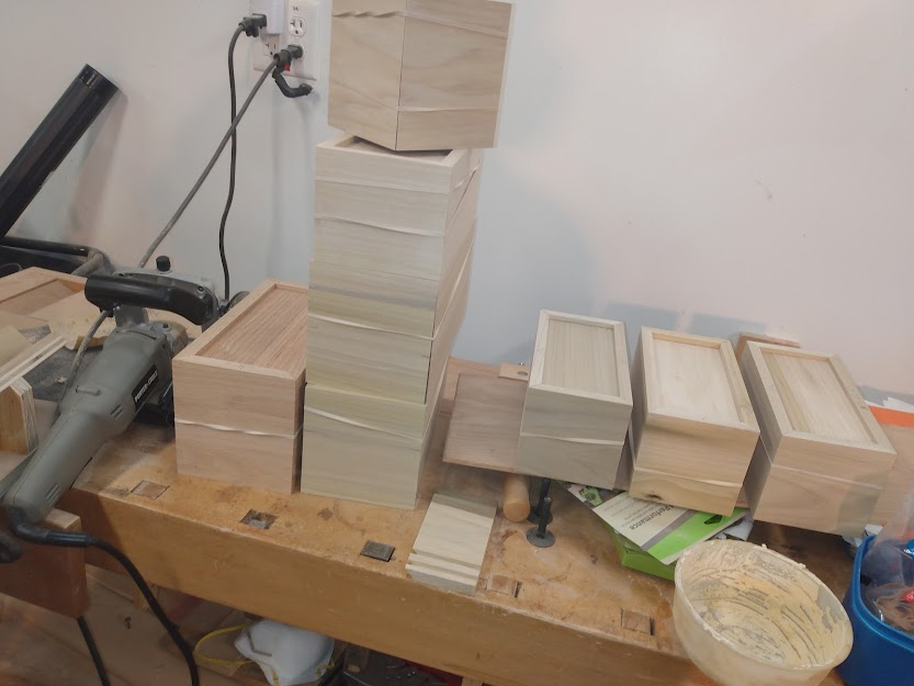

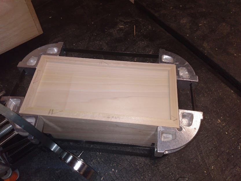

Popular Post kmealy Posted April 11, 2023 Author Popular Post Report Posted April 11, 2023 Making progress on a "production run". It will probably be 25 or so, with about 2/3 poplar and 1/3 red oak. à la Newman log: I got some cutoffs from the woodworking and cabinetry shop nearby and Nextdoor donation was a bunch of flooring cutoffs. Last week's batch was mostly 8/4 poplar. I resawed it down to two passes of about 5/8 that was then planed to 1/2". What was left was planed to 1/4" to fit in grooves for top and bottom panels. About 3 days of planing yielded 30 gal of chips and probably will fill up another one before they're all done. S A few of the boxes with sides cut, mitered, and grooved and top and bottom panels. Awaiting glue-up I only have two band clamps, so it's one box at a time. The glued up boxes will go another pass thru the router table to separate off the top with a rabbet. Most of the boxes are a "double cube", either 4x8 or 5x10, depending on what the lumber yielded. The red oak boxes are a bit behind the poplar ones. They are made from three flooring boards with the tongue and grooves ripped off, edge glued, then planed down. Headhunter, lew, Gene Howe and 5 others 5 3 Quote
Popular Post kmealy Posted April 18, 2023 Author Popular Post Report Posted April 18, 2023 Wrapped up the series today by cutting off the tops and sanding, sanding, sanding. Ready for delivery on the next trip. I used a router table with a 1/4" spiral bit to do the grooves and the separation. I thought it would be safer than a dado blade. But I might explore that on the next batch. Grandpadave52, Fred W. Hargis Jr, John Morris and 4 others 5 2 Quote

kmealy Posted April 19, 2023 Author Report Posted April 19, 2023 3 hours ago, Gene Howe said: Why not just use a crosscut blade on the TS? Some of the pieces were long (~30") and would not be a problem, but some were about 4" long. I needed the grooves to be 1/4" to hold the top and bottom panels. There were 3 grooves cut in each piece, 1/4" from the top and bottom for the top and bottom panels and a third 3/4" from the top for the inside rabbet. Once assembled, a fourth pass on the completed box to separate the lid and make the matching rabbet. (see above photo) Cal and Grandpadave52 2 Quote
