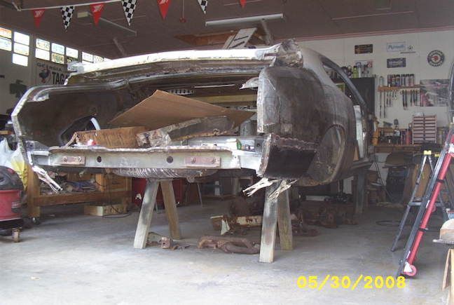

  • Here is a better pic 4D.     Not sure where I conveyed the notion I was under the car.  I can assure you I was not.  I had other and better ways to work on the underside.

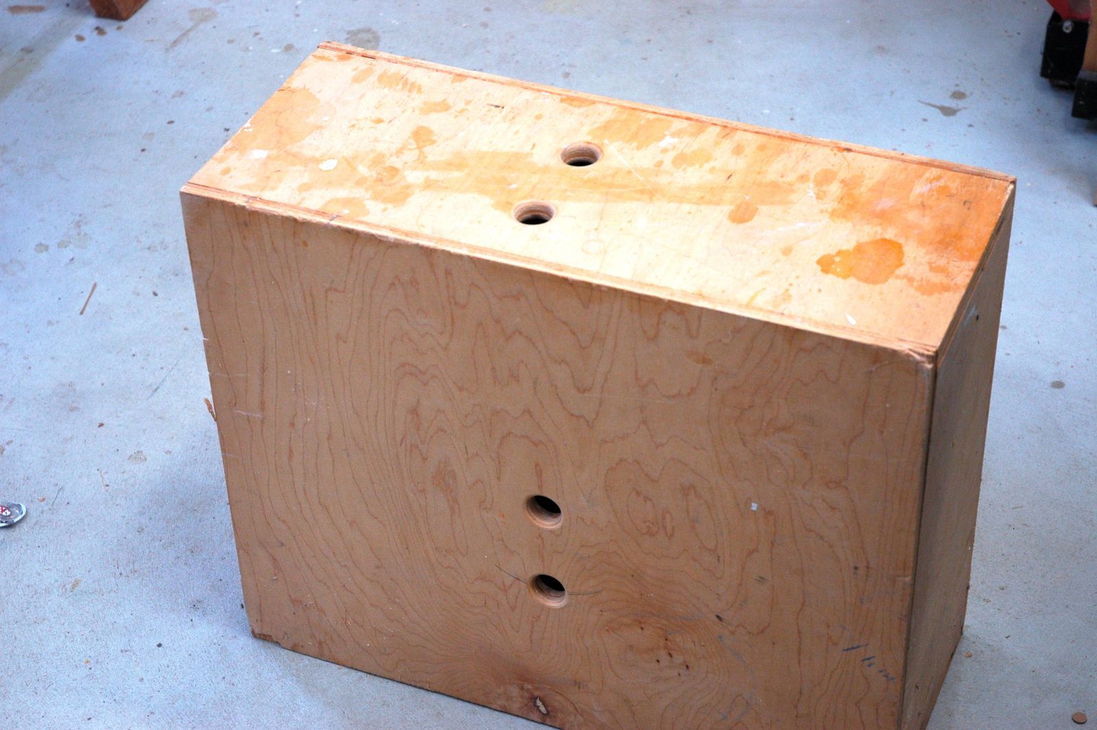

I have a pair of wooden sawhorses not too different from the ones Keith pic'd above, and I have a couple of sets of plastic ones that are used outside or for finishing. But none of them are the right height all the time, so I built a couple of wood boxes that can be laid on any side and hold things. These have turned out to be quite useful, and though they aren't used as often as my horses they are used quite a bit. I put fingers holes in 3 of the sides to make them easier to pick up. These are 9" x 19" x 22", I think it i did them over I'd make the 19" side a little shorter to give me a little more flexibility in heights. I'm sure I got this out of some woodworking magazine years ago but I can't remember which one. I did find a pic of my wooden horses, and you can see some dipwad cut into a top that had to be replaced...that dipwad would be me.
Yeah, I made two "shop boxes" from salvaging plywood from a neighbor's old cabinet.  They are 24 x 30 x 36 so I can flip them around for different working heights.  I put on either a half sheet of plywood or (another salvaged) slip on desk top (30x60-ish)

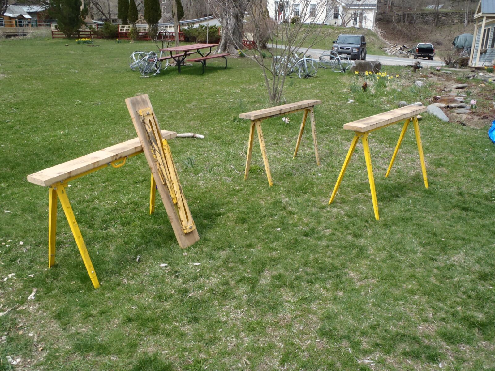

I choose wood over plastic for a few reasons.
Structural strength.  No way would I have set an auto body on a set of plastic horses.
I've had a couple sets of plastic horses, but found them too low.  My wood ones are sized to be the same height as my truck's tailgate when opened.  Use to anyhow, I need to make a new pair to match the Nissan.  This allows me to use the tailgate as a support on long stuff and sheet goods.  And too, the wood tops have more than a couple battle scars from saw blades.
After careful review of this picture Cal, I have to ask; was there a shortage of concrete blocks during this time?:throbbinghead:

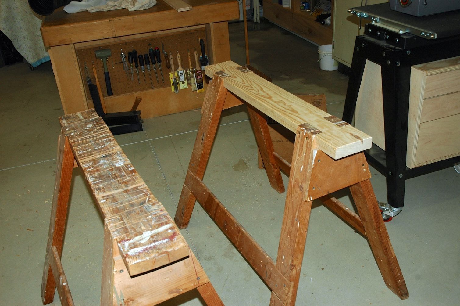

I have 2 pair of these sawhorses that I ready like. I attached 2x boards wide enough so I use clamps on them.
P4220255.JPG.8aba5332caacbb1f6bf462569dff6a3b.JPGP4220256.JPG.2f939049e0fc434b67b5c614dfe5b646.JPG
