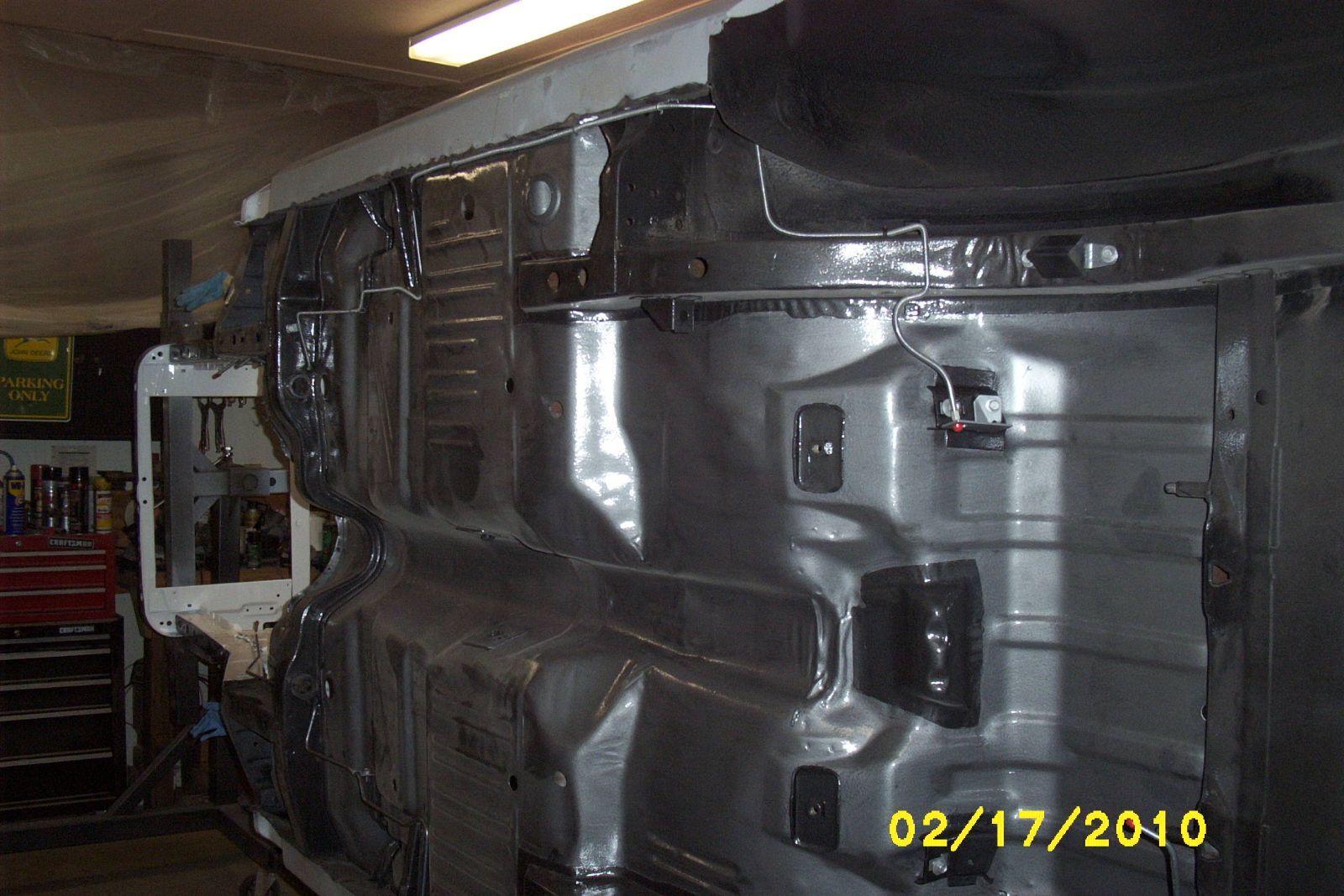

  • Here is a better pic 4D.     Not sure where I conveyed the notion I was under the car.  I can assure you I was not.  I had other and better ways to work on the underside.
  • 4DThinker

    The blocks will likely be left with this house when I sell it.  I may park them under a different tree with a plank on them, facing this house so they can admire their new purchase.  4D

Structural strength.  No way would I have set an auto body on a set of plastic horses.
I've had a couple sets of plastic horses, but found them too low.  My wood ones are sized to be the same height as my truck's tailgate when opened.  Use to anyhow, I need to make a new pair to match the Nissan.  This allows me to use the tailgate as a support on long stuff and sheet goods.  And too, the wood tops have more than a couple battle scars from saw blades.
You are braver than I Cal.  No way I'd crawl under that car.  Can't see the top of the saw horses but it doesn't look like there is anything other than friction between the legs and floor to keep them from doing the splits. Is there a chain between the legs that disappears in the photo perhaps?

I agree. I see no ties to keep those legs from spreading and I sure wouldn't get under to add any while that load is  on.
4D
The right tool for the job... :)
You went all in on that.  Nice!!!!!!
