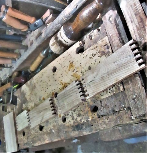

Part of the 3 hour tour in the shop, today....check the depth stop..:OldManSmiley:
as the saw wasn't cutting deep enough..toe had slipped a bit..:BangingHead:
More of the layout, saw, chop...until..:TwoThumbsUp:
Was doing #4 corner...#3 came next...:OldManSmiley:
All 4 corners were done...knock this back apart...hammer assist.:DevilLaughing:

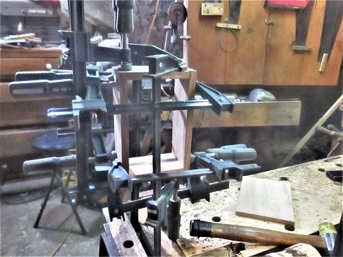

Then clamps, glue and a brush, and....:Cheer:

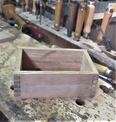

Maybe a better view..:ChinScratch:
Bench vise is lending a hand...even got the panel for the bottom cut to size..:TwoThumbsUp:
Once the box comes out of the clamps, I can level the bottom edges, and then glue this to the bottom of the box..:ChinScratch:

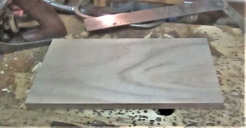

Board is about a whopping 4" wide....and just over 11" long.
Per Sellers' Instructions...bottom panel was simply glued to the bottom of this box....

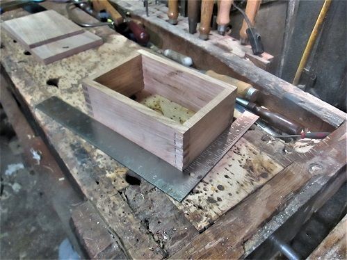

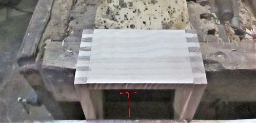

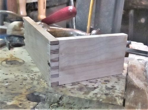

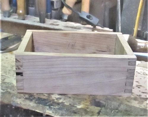

Ok, Fresh out of the clamps, needed  a bit of work..:BugEyeSmiley:

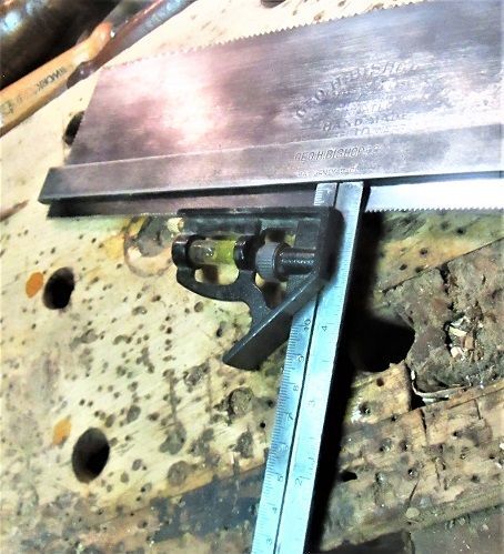

A check with a square...:ChinScratch:
Then worked on the longer sides...:SaluteandRun:
Gaps needed filled...too...got around to the ends..:ChinScratch:

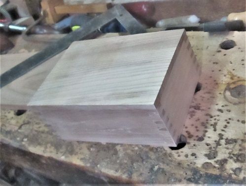

Almost done....still had to level the top and bottom edges, luck of the draw which will be which, might as well do both:TwoThumbsUp:

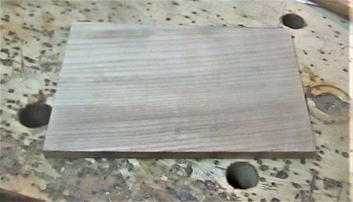

Then test the bottom panel for fit..:OldManSmiley:
A little over size is better than  undersized..we can trim the "overs":MachineGun:

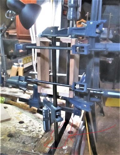

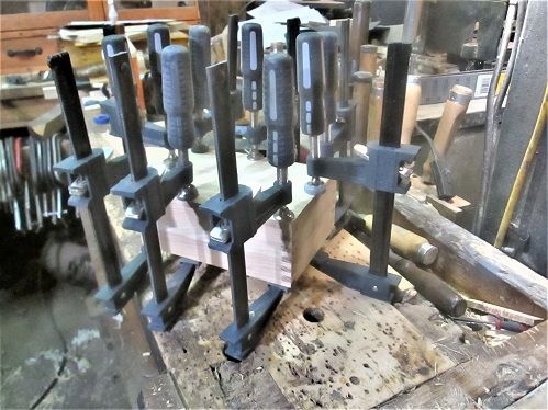

Thin bead of glue wiped along the edges...then 8 clamps..:Cheer:
Let this sit a day, while I figure out how to make this..:ChinScratch:
Into a lid of some sort....and..where to cut this to size.....:WonderScratch:
Stay tuned :cowboy:

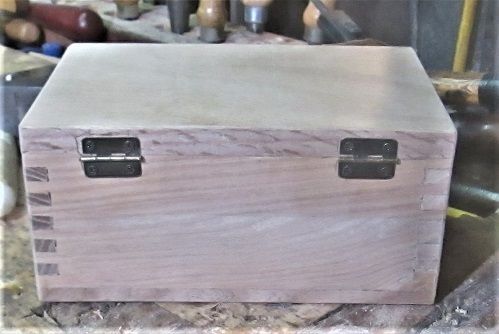

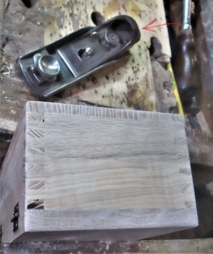

Got bored sitting around,:Tapping: so...lid was found to be thick enough(1/2") that I didn't need to build a collar.  Cut that to size.  :ChinScratch:

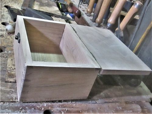

Box came out of the clamps, needing a little trimming on the bottom panel...Millers Falls No.8 took care of that...:MachineGun:

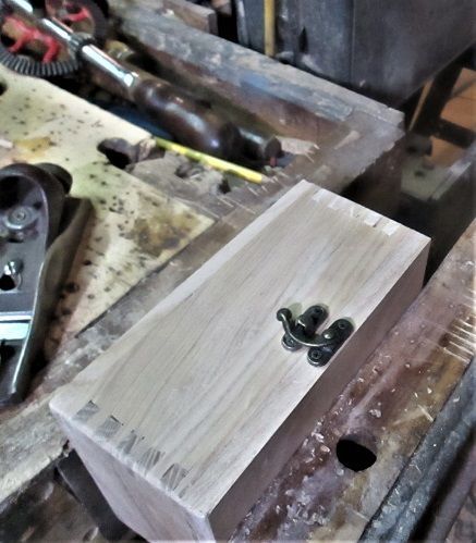

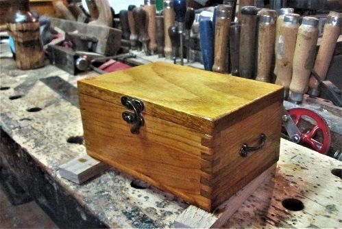

Mated up the lid to the box...and clamped in the bench vise....hinges were install..:SaluteandRun:
Then turn the box over, and fine tune the fit of the lid to the box..and install a latch..:ChinScratch:
Block plane is there to add a slight bevel to the corners..:OldManSmiley:
Plane is a Stanley No. 60-1/2 Low Angle.   The colour is called Cordovan (Maroon):JawDrop:
Letting this box sit overnight...and see about a coat of Amber Shellac, Monday?:WonderScratch:
Hey, them hinges work!:TwoThumbsUp:
Stay tuned..:cowboy:

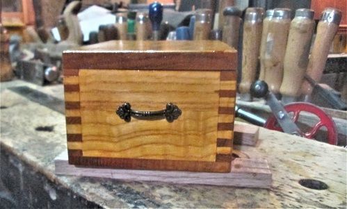

PIP Time...:SaluteandRun:
Show-off...:DevilLaughing:

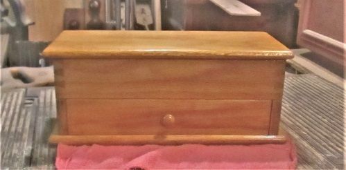

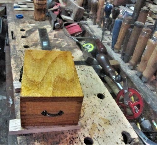

Decided these fit well with the size of this box...:ChinScratch:
This is smaller than it looks, BTW....this is after 2 coats of Amber Shellac...:TwoThumbsUp:

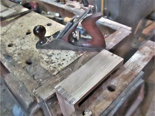

On 3/5/2022 at 8:04 PM, steven newman said:
Top and bottom edges were leveled with a hand plane.
Steve, you you rely only on if it will sit flat, or use tools of some sort? I've actually only got a slab of granite for checking level but will be ordering a squarre shortly. Currently the squarest thing in the 'shop' if the card scraper. :)
Here is a set like I use. https://www.amazon.com/Grizzly-H2993-Machinists-Square-4-Piece/dp/B0000DD4EE/ref=asc_df_B0000DD4EE/?tag=hyprod-20&linkCode=df0&hvadid=309788281570&hvpos=&hvnetw=g&hvrand=10631900964869467322&hvpone=&hvptwo=&hvqmt=&hvdev=t&hvdvcmdl=&hvlocint=&hvlocphy=9030226&hvtargid=pla-569821720469&psc=1
Invaluable and far more accurate than my framing squares. Plus, they ain't got no numbers to cornfuze me.:TwoThumbsUp:
Here's the link :cowboy: Everything after the "?" is Big Brother tracking us :ph34r: I've got Grizzley slot files. Wonder if it is the same company? I'd planned on ordering a square the same time I order a dovetail marking jig ... The 'new' lid for my box went on crooked. Something is not straight! :PullingHair:
I'll give it to my plumber buddy for his shop :P
To "level" the top edges...I just use a plane long enough tp register on an end and a side, and work my way around.   Test the panel looking for gaps...then lower the high spots until the panel sit flat...
And no gaps...
Thanks Steve. The rock-it method was going in circles. I’ve got a long plane and will try that method next time.
